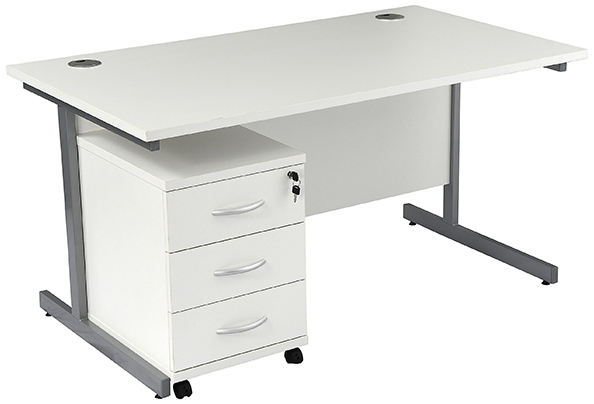

This is like my current desk:

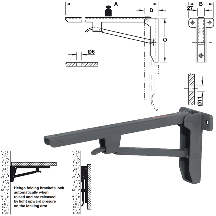

There is another L bracket that is rated for 500kg - is 580mm (92% of tabletop depth) and the bracket wall itself is 178mm tall:
Dimensions (A x B x C):
  • 330mm x 82mm x 134mm
  • 380mm x 82mm x 134mm
  • 480mm x 82mm x 152mm
  • 580mm x 82mm x 178mm
Folding is rated at 500kg, non folding (on page 1 of this thread) is rated at 150kg.
So not worth adding a layer of plywood between the bracket and tabletop (600mm x 300mm x 25mm) DxWxH - to spread the backet's weight-bearing capability?
And has anyone asked what sort of wall this is going into? 500kg brackets are all very well, but an MF stud wall wo t be able to support that sort of weight without considerable extra benefit g up, and even plasterboard will crumble unless the weight of the bra ket is spread a cross a greater area by mounting the bracket on a larger MDF or timber pattress
It is a brick wall. Its the party wall.
What if I was to use a 25mm thick plywood piece on the wall too. 500mmX500mm say? And bolt that into the wall and the bracket into the plywood and brick?
