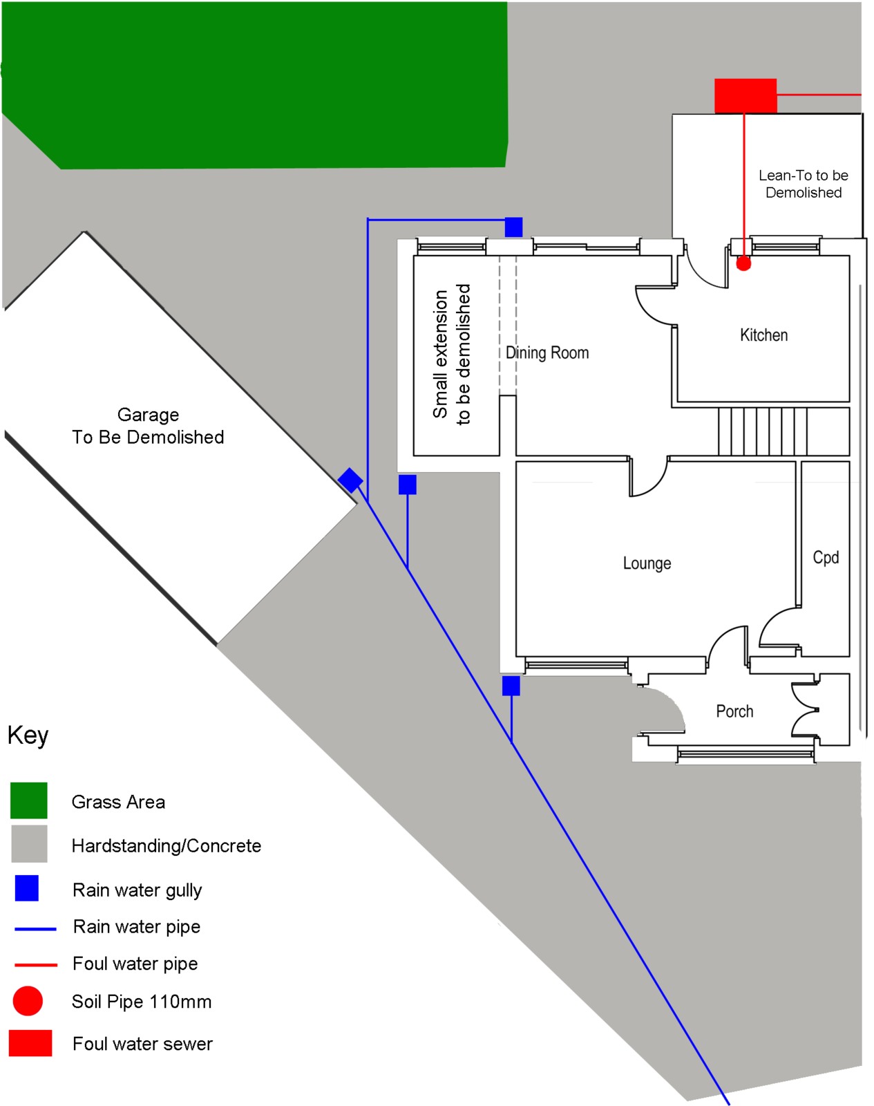

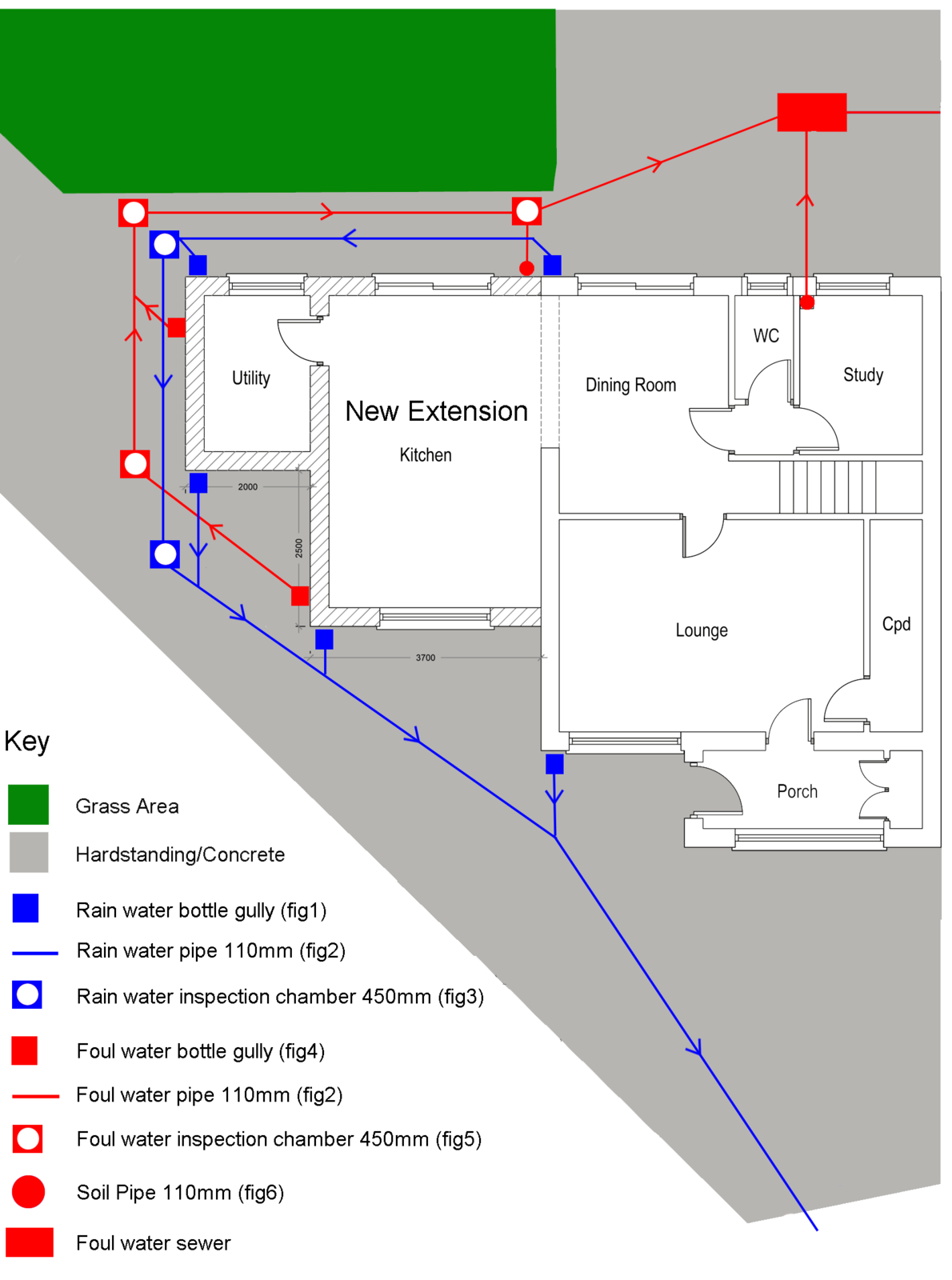

Just updating the outcome of the planning conditions, maybe this will help someone in future. I drew the drainage plans up myself, used some calculations off our flood risk assessment and submitted these early Jan. Today I have had the removal of conditions accepted so happy days! I worried for nothing! The plan drawings i submitted are below. It didn't look like i needed a lot afterall... makes me wonder what the £1650 + vat drainage design quote I had would have done differently! The conditions were misleading... the council probably need to work on their clarity!
