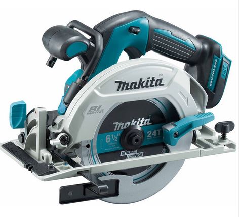

when you say rip saw do you mean handsaw?
No. I mean a powered rip saw, i.e. one of these:
I haven't seen anyone on site with a hand rip saw (i.e. a hand saw with proper rip pattern teeth) in nearly 40 years.

Cordless tools always have less power to play with than the equivalent-size corded tools (e.g. my cordless rip saw is 600 or so watts - a corded version would probably be 800 to 1000 watts). Partly to overcome this power disadvantage manufacturers therefore fit thinner kerf blades to reduce the power requirements and thereby maximise the battery life of the tools. In other words you get a cordless tool which performs almost as well as a corded one. In the case of the 165mm cordless rip saws like the one above that means saw blades with a kerf of 1.4 to 1.7mm. From experience (about 7 years to date) these thinner blades don't last as long as their thicker kerf bretheren, although they have improved since I started using them. They are particularly prone to shedding teeth if you hit embedded metal. If you insist on runnning blunt blades in a cordless saw you will simply end up flattening the battery very quickly so I tend to always have a spare sharp rip blade (low tooth count) to hand as well as a higher tooth count blade which is reserved exclusively on sheet materials. For floors, old timbers, etc I keep an old blade which has already lost a couple of teeth or is bluntish - after all, there's no point in ruining a good blade cutting out nail-infested rubbish
