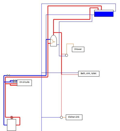

Hello, is there a reason why the DHW and CH/boiler expansion tanks cannot be one tank in a fully pumped, indirect system?
I.e. one tank with cold feed splitting to CH and DHW cylinder and vents back to same tank:
Very simply because the F&E tank is an expansion tank and you cannot let heating system water mix with domestic water.
Tony
