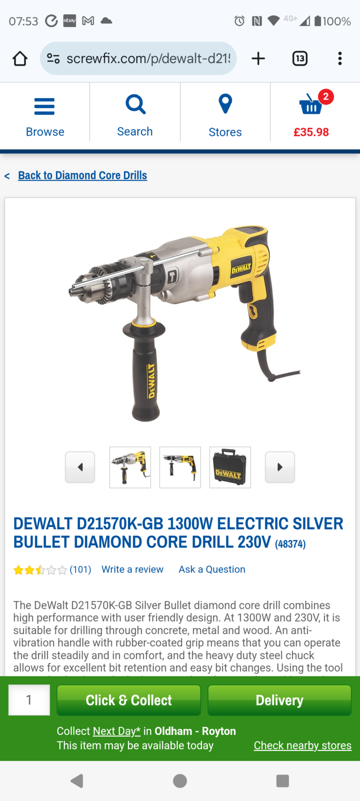

I recently dropped £300 on a Metabo cordless drill because I needed a cordless drill that could run at 3,000 rpm. I don't think that I would want to risk burning the unit out to drill a core hole.
Whatever you do, don't touch this heap of **** with a barge pole. Read the reviews. I managed to scrap 3 of these drilling less than 15 cores - 2 motor failures and 1 clutch failure. I gave up then and bought one of those old fashioned bullet proof Makita 8406 - the fact you can buy 20 year still working ones on eBay says it all.

Looking at those reviews it looks like the HSE need to investigate that thing!
Followed the link to look at the reviews but there are no reviews showing for that product. Have they been deleted or is it just for me?
