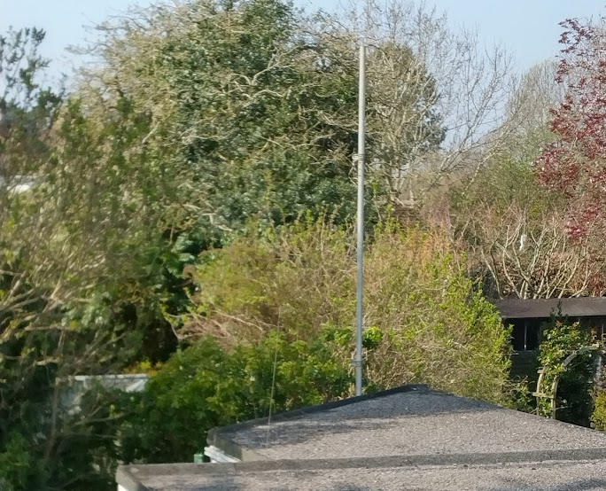

And to demonstrate a point, the neighbour Son to the left of this recently cleared a load of overgrowth, they rediscovered they had a greenhouse and soon complained this 'new aerial' was causing a problem, it has been there prior to 2012 according to gmaps.
I suspect they are looking at selling as the elderly owner is now very immobile.
