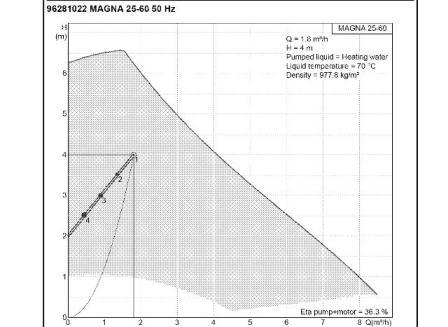

The Grundfos sizing calculator suggest a 15/60 or a Magna 25/60, depending on the head.

But the pump curves are completely different. I used the following assumptions:
Boiler =40kW
Temp diff = 20C
Flow rate 1.8m³/hr
Head 3m or 4m
The UPS15/60 is suitable for a 3m head but not 4m, which needs a Magna; see graphs below
