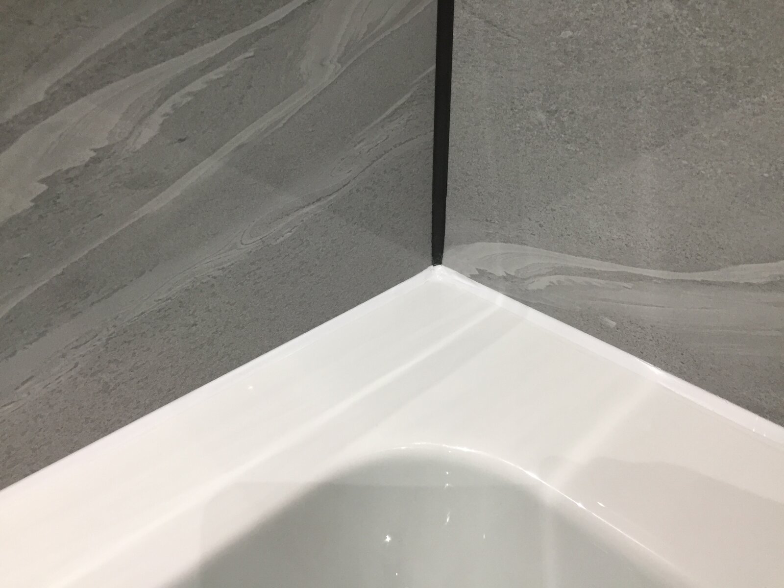

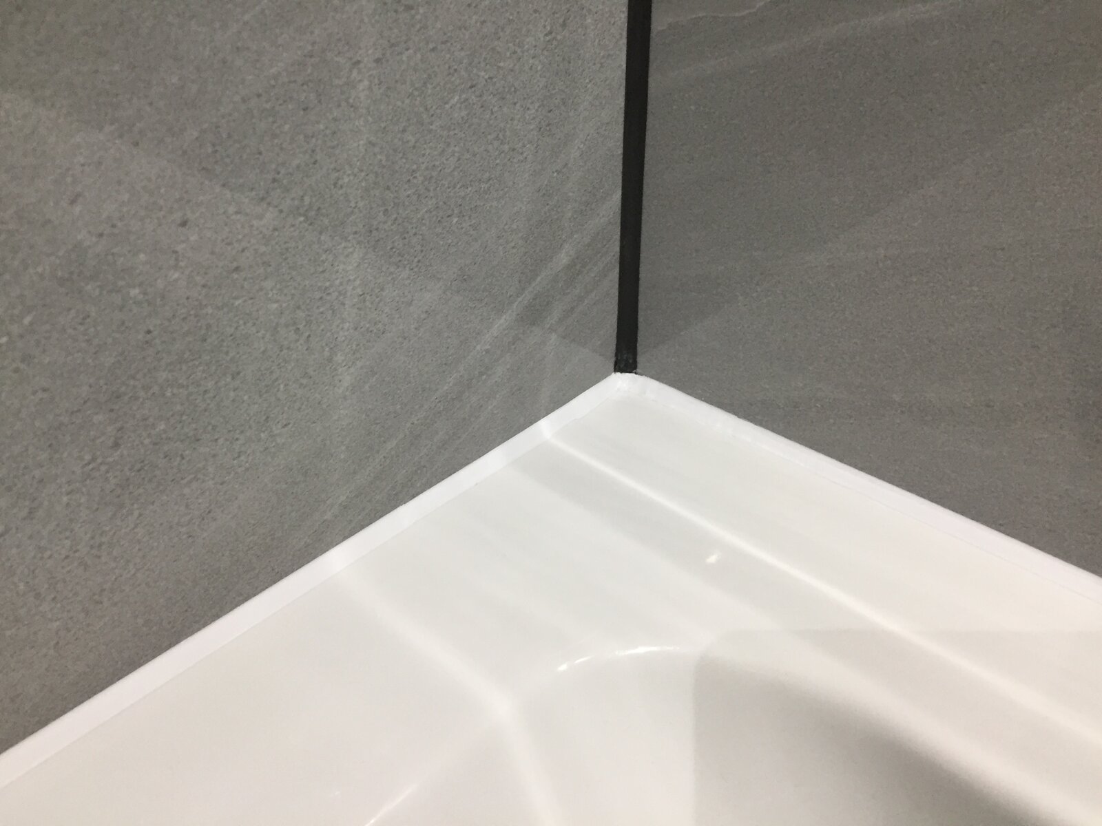

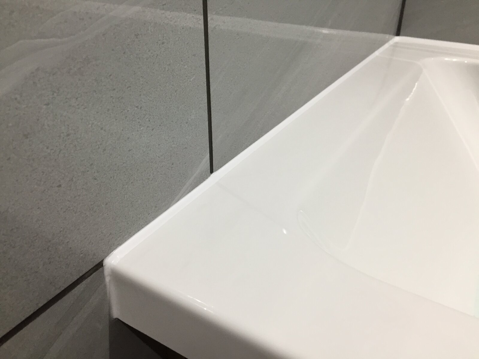

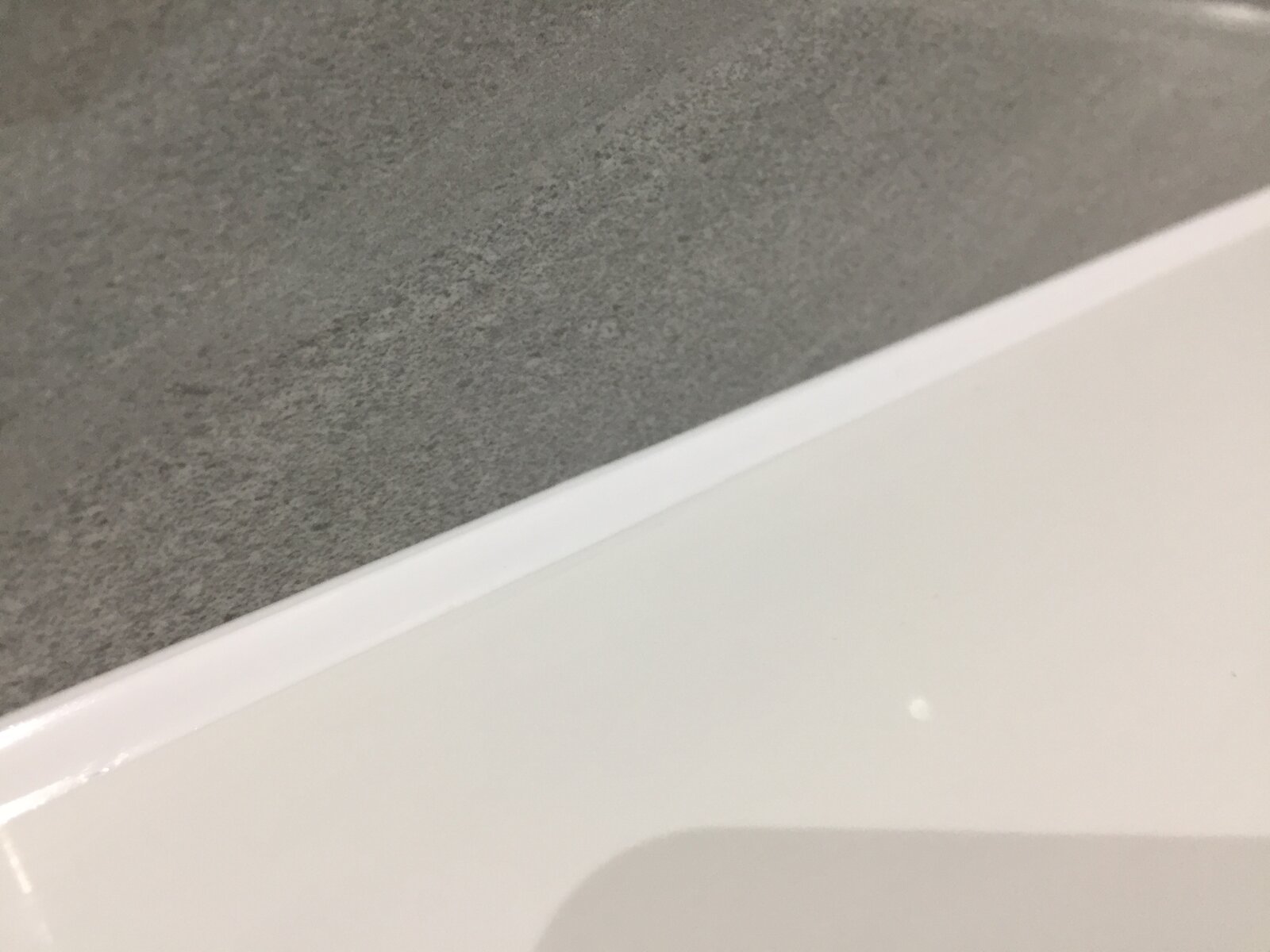

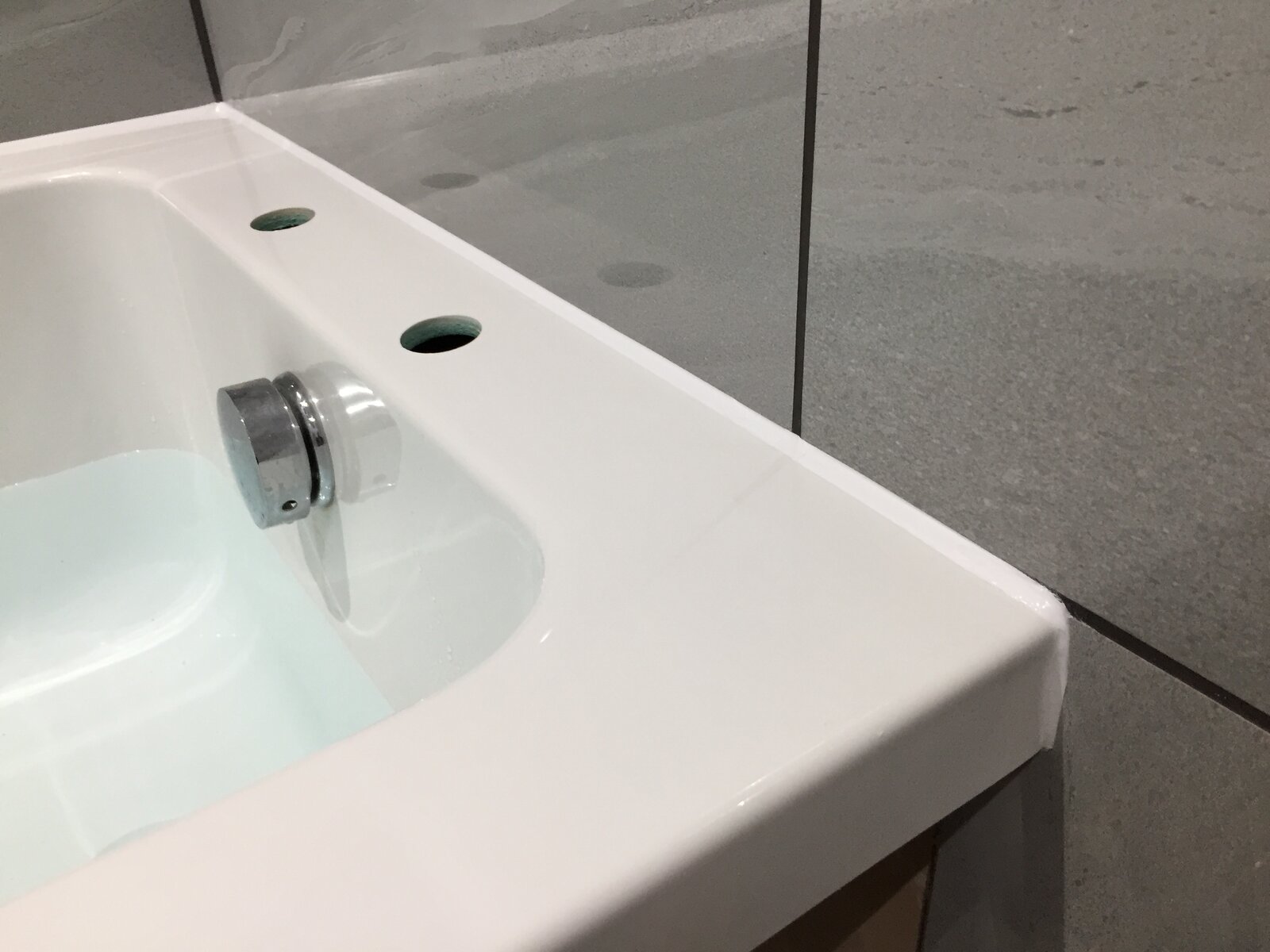

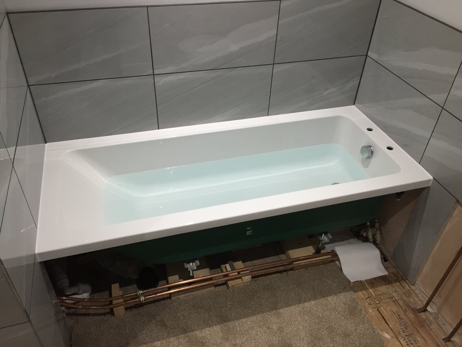

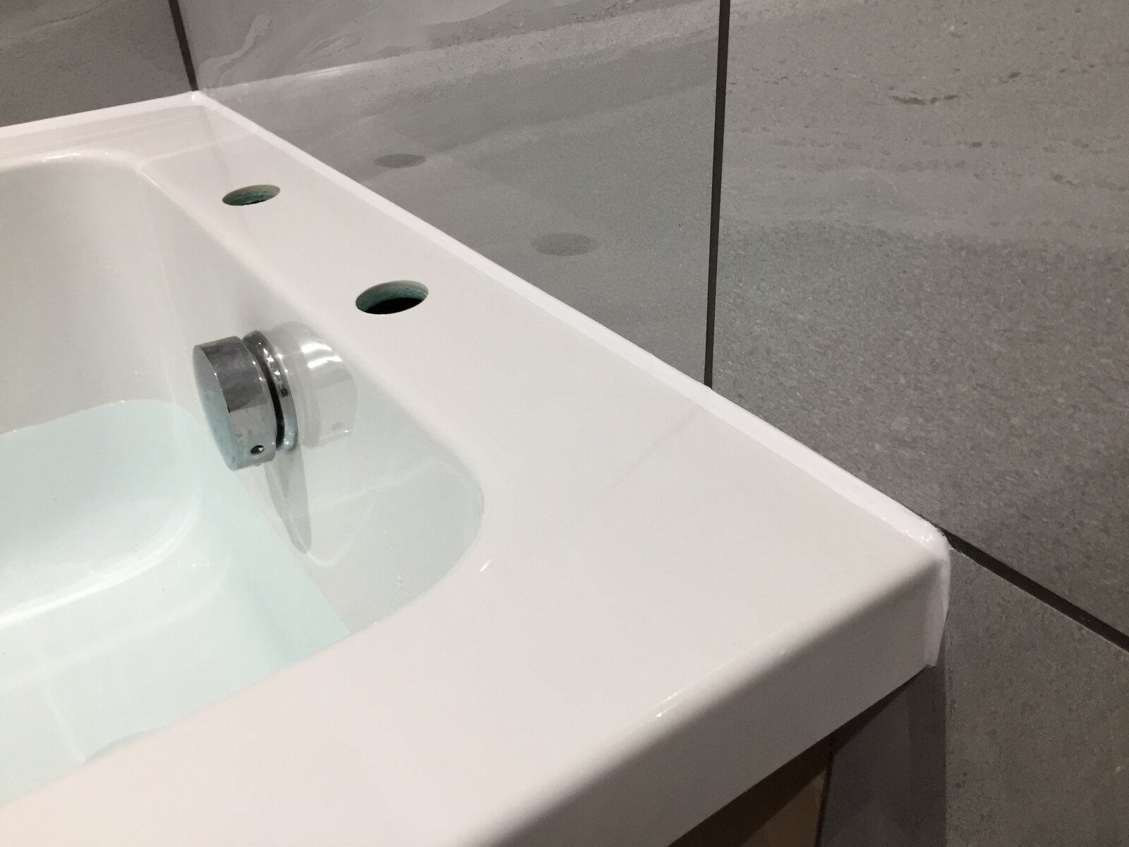

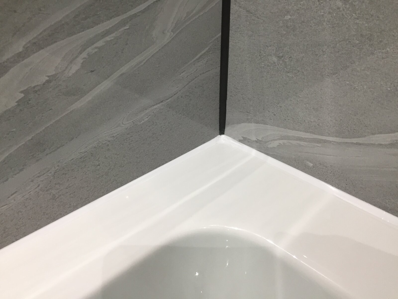

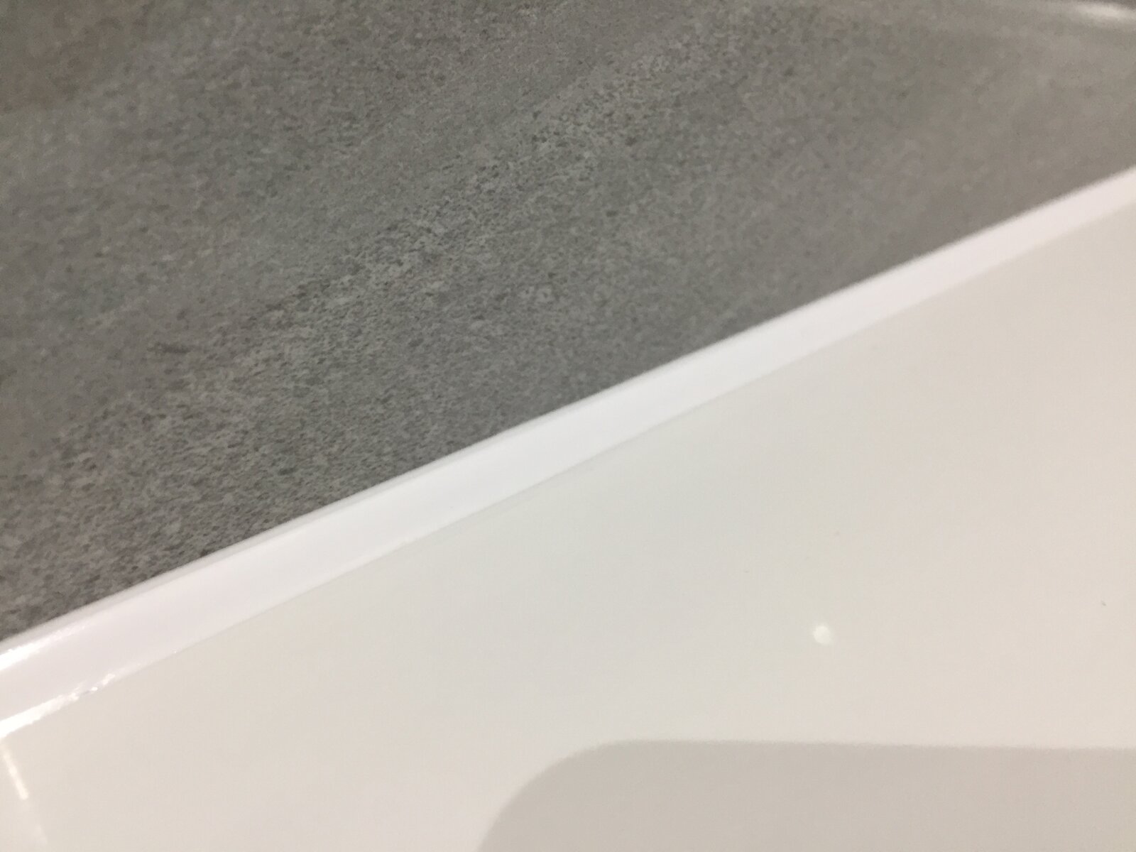

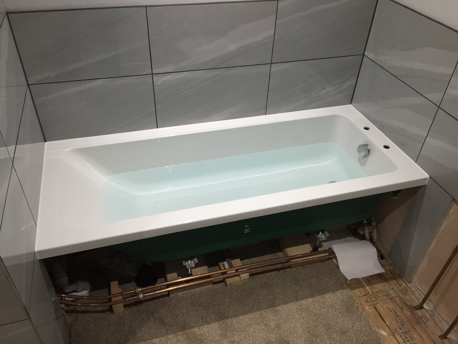

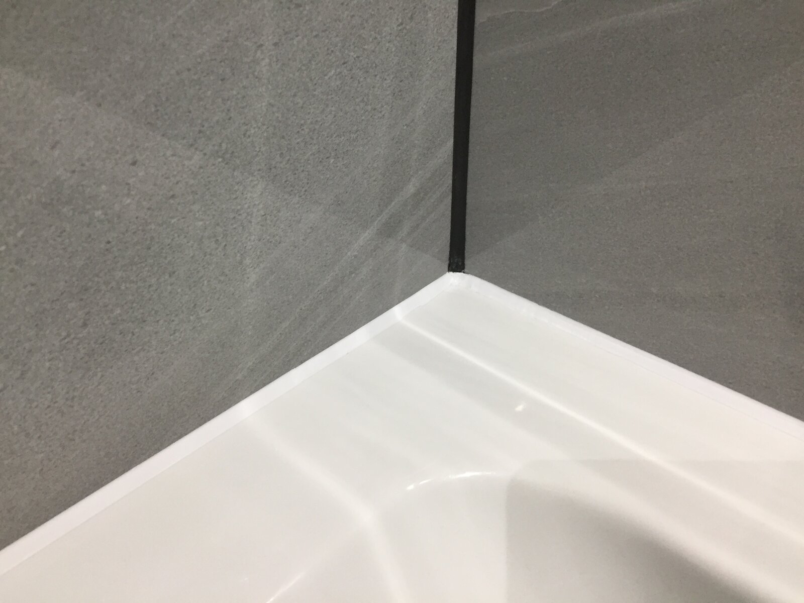

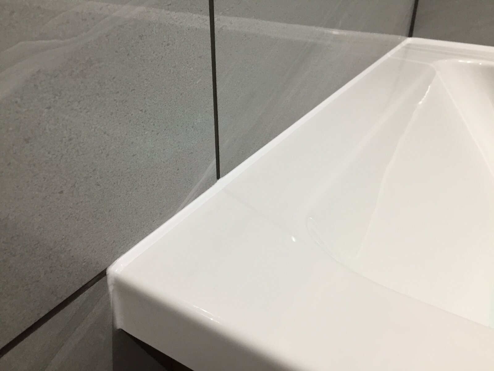

I did the white round the bath today with Unibond Triple Protection silicone. It’s supposed to be the best, but was quite “runny” to work with ‍:unsure:
Again, it didn’t go as perfect as I wanted it to with a few ripples, lines, defects that I had to go over and over with the Fugi tool. The corners were a right pain in the ass !! In the end I had to go with the “if it’s 90% right, it’s time to stop faffing” rule and accept the few defects. Very frustrating for a perfectionist :cry:
Here are a few pics:

Looks ok.....from a distance !! :p . It's the same as all jobs.....you look with a very critical eye when you're in the middle of it and looking at it, but once it's done and you're not looking any more....it looks ok ;)
