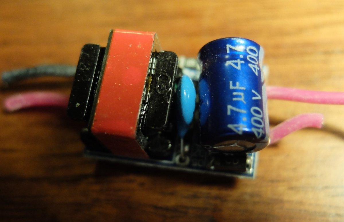

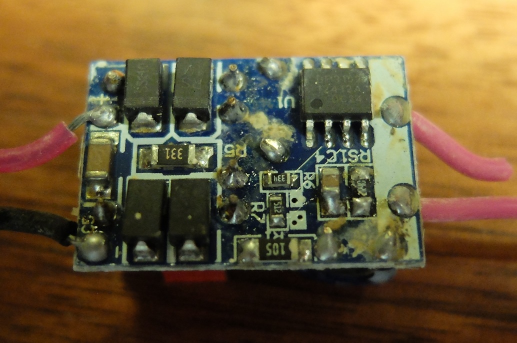

Ripple on the input cap voltage won't affect the LED brightness as the switch mode control loop will be fast enough to adapt to it.
This is from a non-dimmable mains-input LED lamp; the module is approx 24x16x15mm.
The only large components are the transformer and the input cap, which is 4.7 uF 400 V.
Everything else is tiny. In fact they've not even used the smallest surface mount resistors; they could have fitted twice as many components in the same space.
The additions to make it dimmable would increase the number of components, but the volume would not have to increase much.
