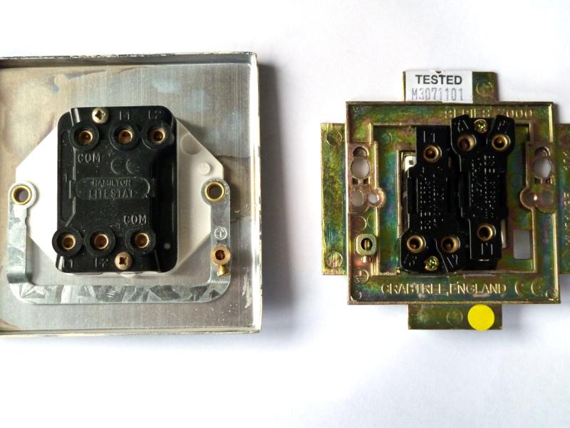

I just bought a new 2 gang 2 way rocker switch to replace the upstairs dimmer switch seeing as the test unit I used from the Kitchen worked, BUT THE NEW ONE DON"T WORK! ARRRGGGHHHHHHH!
Here's the two switches
On the left we have the Kitchen Switch that worked and on the right the new switch that don't. They are slightly different to each other as the new switch doesn't have a C port it just L1 L2 and L3.
What I did was to wire everything up the same but putting the wire that came out of the C port into the L3 port, so:
1 way landing switch
Red - L3
Black - L1
2 way Hallway switch
Red - L3
Yellow - L2
Blue - L1
What happened was the single dimmer downstairs worked but when you went upstairs and switched the switched it didn't turn off the light (when it was on downstairs, if anything it made it brighter).
I'm sure it just the case of it requiring some different wiring connection but what? This just doesn't make any sense to me anymore. Help!
