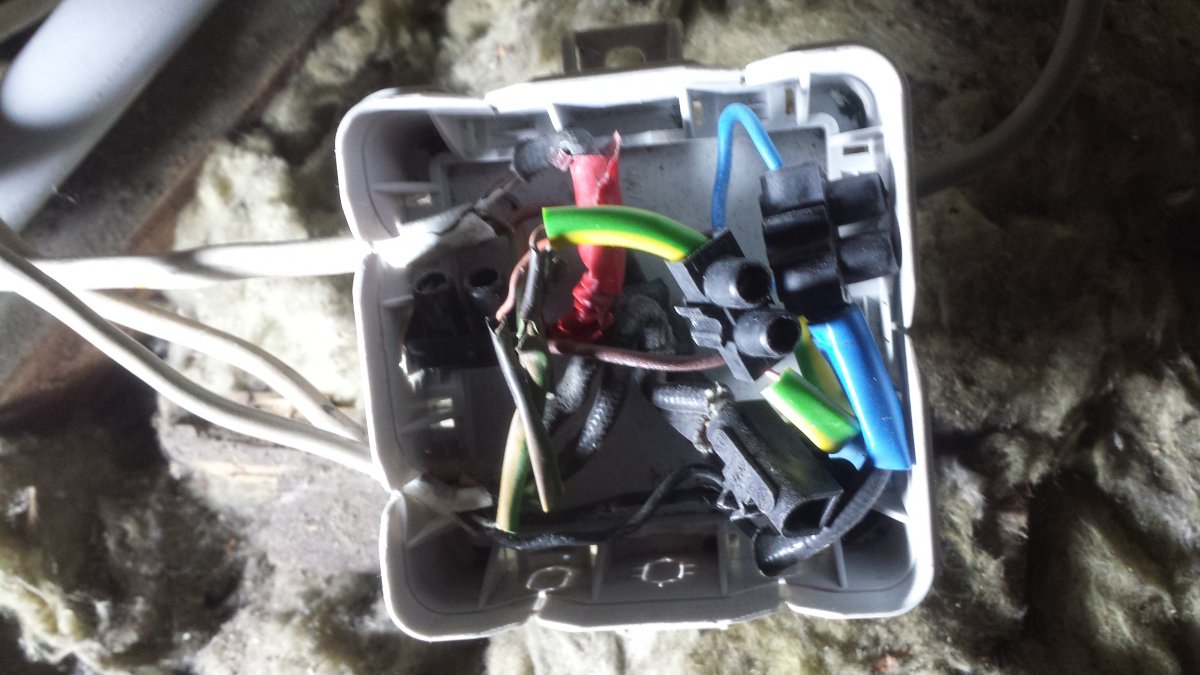

So I bought a property in 2012 and put it on rent till last week when I moved in.
Bathroom and toilet are separate rooms, with separate light switches and lamps.
Both lamps are flickering or dimming so I go into the loft space to have a look at wiring to see if there is a loose wire or break etc...
Find a fairly new box, with connector choc blocks inside. Earth sleeve is shrunk on some parts and looks charred in others...
Had a quick follow of wires best I can, looks like it's in a ring or middle of radial circuit, has only one switch wire ( only one switched live comes back). Feeding only a light in bathroom part. Can't see toilet part ( next room) as cold water tank appears to be sited on top of it...
Various times of use the light is noticeably brighter or dimmer in both rooms, however all other lights on the same circuit (landing bedrooms etc) all seem the same brightness.
There is also a fairly new but disconnected shower extractor fan isolator/transformer nearby which looks like it's been screw connected then removed from somewhere.
Any ideas what could be causing the dimming and heating issues? All screws are tight and already where when I opened the box to peer inside.
Pic of junction box attached.

Well.....I can almost guarantee that wasn't done by a pro! If that junction box controls your bathroom/toilet lighting then I suspect you have already found your cause.
Your lights will be on a radial, so this could well be the 2nd to last point, with your toilet light being the last point on the radial - a loose connection here would cause flickering on both points.
Both flickering and the overheating you've found could be caused by a loose connection.
That cabling looks like it has heat-resistant sleeving on it for some reason.
It wants all cutting back to clean copper and re-doing, properly. Jus make sure you know which is your switch wire and it's a simple job - get a decent junction box too

Are the wago push fit connectors in a plastic box mounted to a roof joist ok to use? (It's access able in the loft space) with a blanking plate over the top?
I suspect that the tenant tried to add the fan as it wasn't there when I rented it out to him.
Switch wire is the single wire where there are a total of 3 on one side as found that already, light fitting is also easy to find, the box is sitting on the isolation about 30cm away from the light... just haven't been able to properly trace route of power in/out!
Yea wagos are fine. If the box you use doesn't have cable grips for the cable, then make sure you clip them to the joists.
In the interim, I wouldn't worry too much about tracing all the cables, so long as you know what these 4 do, make this good, and if that doesn't solve your problem (I would be amazed if it doesn't) then you can start tracing cables.

Maybe my eyes deceive me, but it looks like the cpc in that picture is being used as a neutral….if so, that's really bad.
Its not - think its just the way i took the pic. The blue on the right actually goes below and off to the light fitting.
