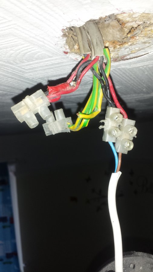

So i just had an eyeball of all of the light fittings on the upstairs circuit and found this in one room:
20150826_194814-jpg.84194

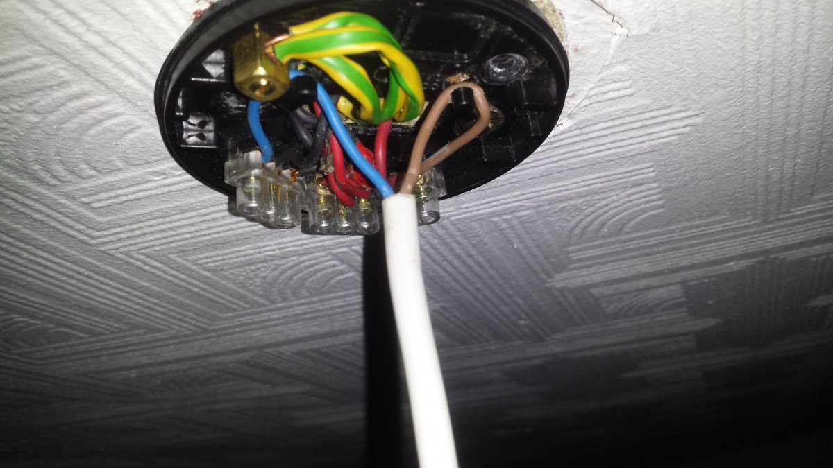

remade the pendent on the end so that the circuit goes directly into pendent:
20150826_202323-jpg.84195
put the lamp back in and turned mains back on, nothing. The lamp doesnt light. - strange as i measured the voltage across L/N, L/E and N/E before putting the cover back on.
Tried the hall light to make sure the circuit is energized, light is dim, same with toilet one.
Swapped the lamp from boxroom (old style filament) with the one in the back room- the one not working(energy saving cfl), and light comes on as normal in the back room, nothing in the box room.
Checked the hall, and bathroom, all are bright...
Not sure for definite if all is fixed, going to leave the filament lamp in for a few days, then swap it for another energy saving and see what effects are...
