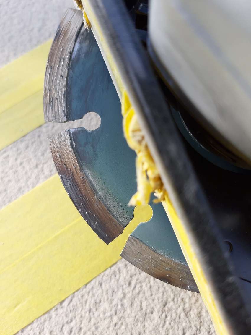

I am really struggling with cutting the slabs though, or specifically the diamond blades I'm using are generally only last 3 or 4 cuts (sometimes that's on a single slab) before giving up and having to replace with a new one.
So I suppose my question is - can anyone recommend any good blades or have any tips for using a 125mm angle grinder for cutting sandstone?

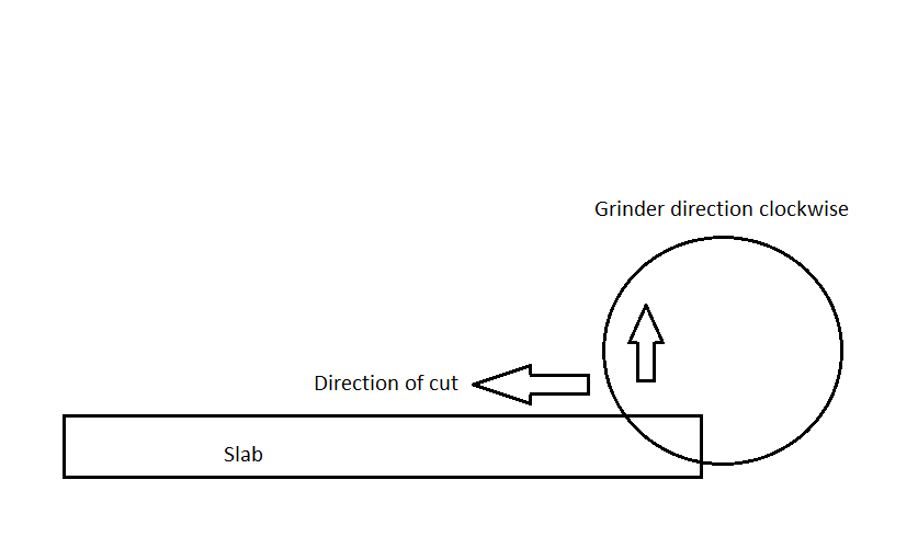

I general have it on speed 2 (i.e. fairly slow speed) and have tried both cutting through the entire 25mm slab at once or doing it in two passes to avoid too much load on the blade.
By the 3rd or 4th pass the blade is really struggling to get through and appears to be showing signs of over-heating - but I think this is just because it is not sharp enough to get through.
