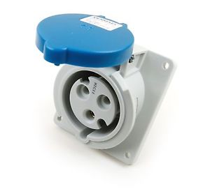

As part of a renovation and extension is seems like an idea to install an ev charging point or two in appropriate locations.
In my mind as these cars become more and more common, doing it now rather than a retrofitting them will make for a tidier job and a bit of future proofing.
Are the EV pods the size they are because they are essentially a retrofit? They seem to have their own breaker housed within the pod.
Is it the pod that regulates any of the charging or the car? I would have assumed the latter.
Therefore, can a charging point consist of one or two discreet 32A IP rated round pin sockets housed in something more discreet or even recessed into the brickwork?
Both, so just having a power outlet on the wall will not be possible.
Even if charging was from a 32A outlet, that is still a fail because a socket on the wall would require a separate power cable, or a cable attached to the car.

So I guess the best method for "future proofing" is to ensure there is a supply (with the correct cable thickness for an EV charge point) to the ideal location for an ev point and install a blanking plate (or even a socket) protected by a weather proof IP rated housing. Then if and (probably) when EV becomes the norm, it is available to fit the requisite EV pod.

The best futureproofing is a duct with easy access.
