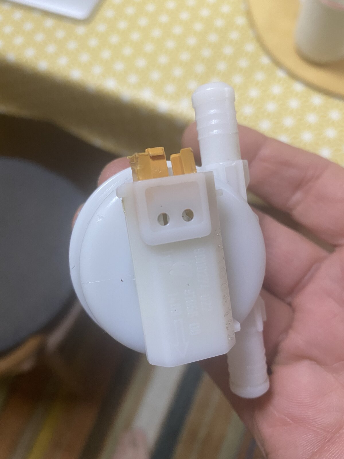

Well, it was intermittent at first and laying the machine on one side then the other sort of worked for a week.
Then I narrowed it down to the impeller jug on the inlet.
Here's the part for mine
https://www.ransomspares.co.uk/parts/dishwashers/bosch/impeller-jug/56999.htm
It's got a plug in sensor on it and the pipe attachments, and is behind the inlet , but accessible from left hand side of machine (when looked at from the front)
I think you can return to these if it turns out not to be correct
https://shop.ukwhitegoods.co.uk/00607138-impeller-jug-flow-meter
I figured it was impeller jug or programmer, and guessed right and saved myself from buying a new machine
although when I look at may photos of the day I fixed it, the part looked like this...not like the ones in the photos to the links I attached
