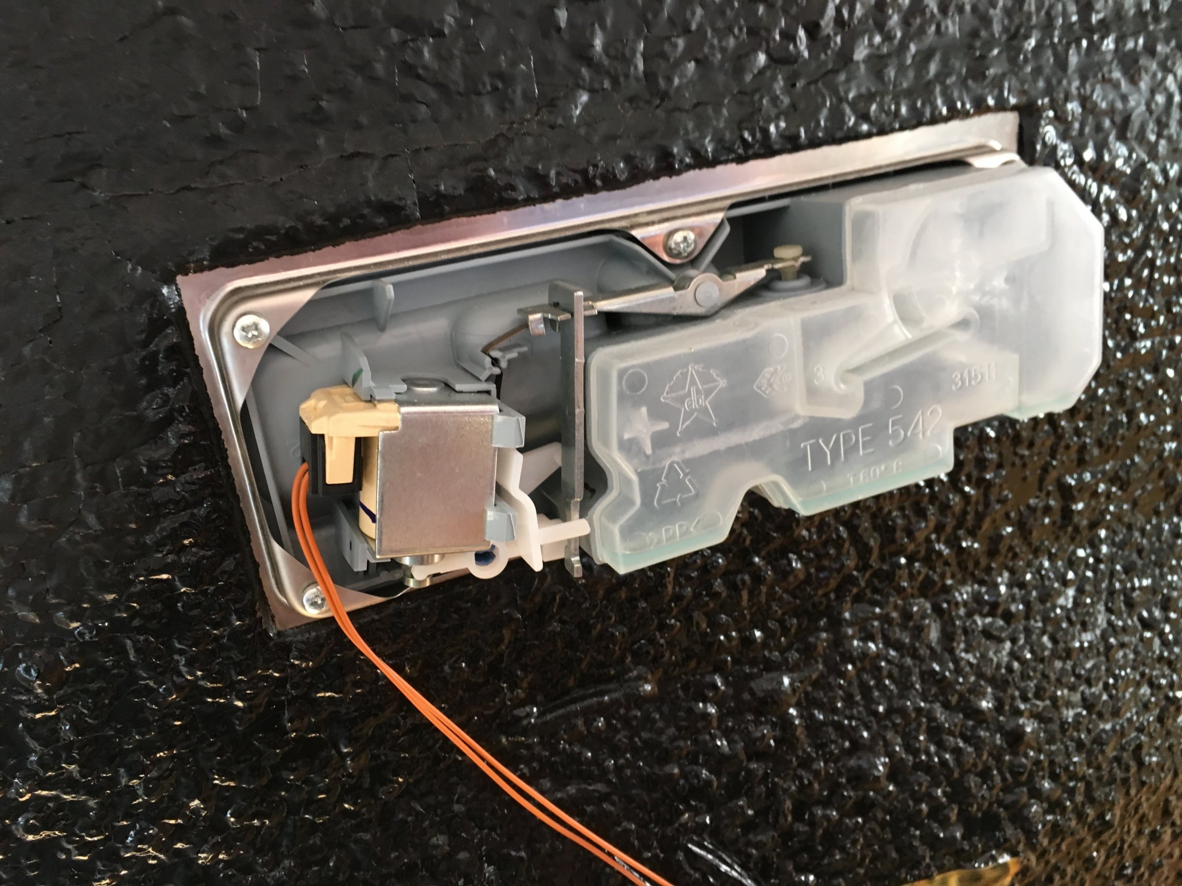

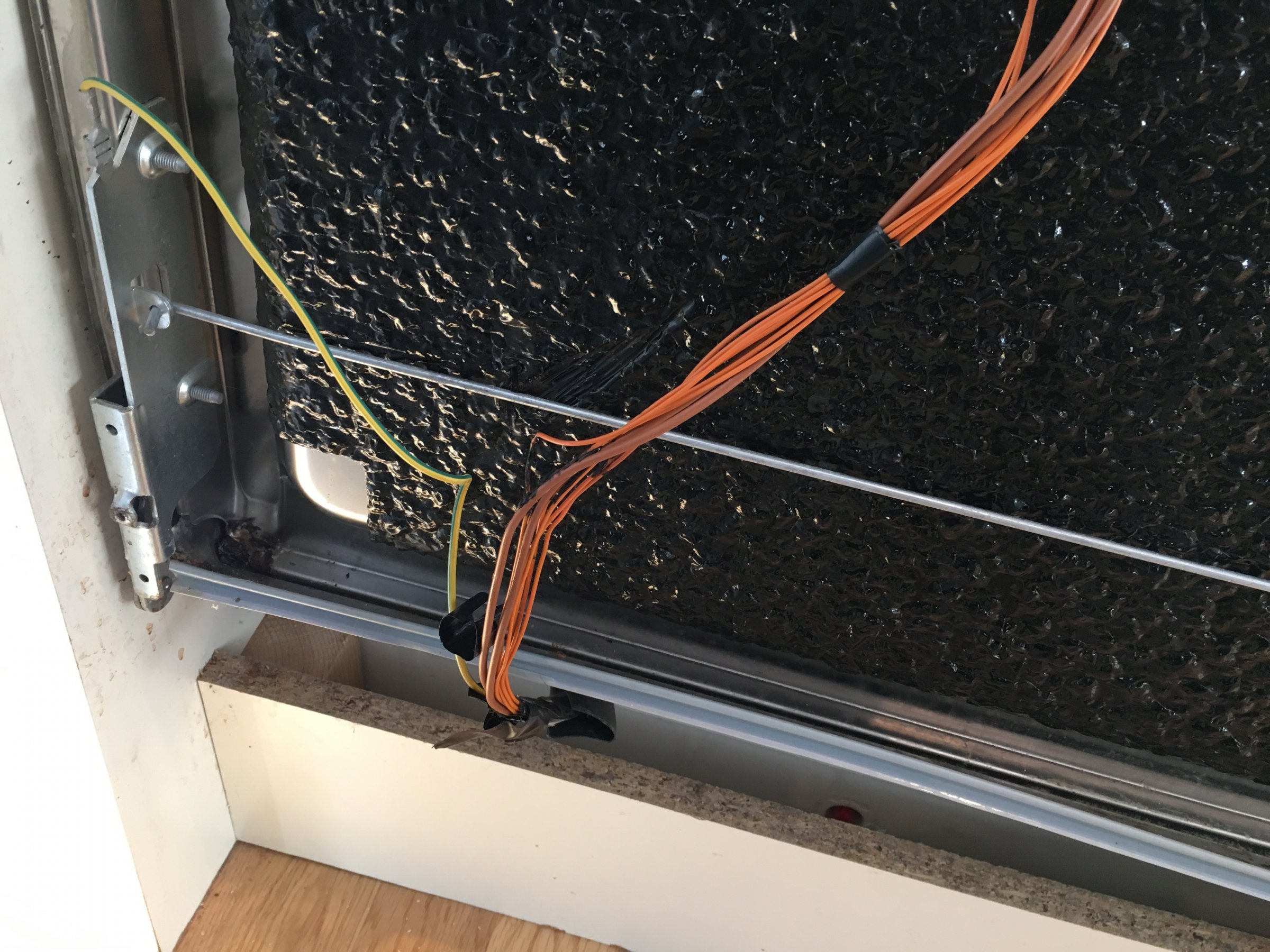

Check the brown wires on the front that go the bottom of the door , inspect the thin bar that covers the loom at the bottom poss broken , give them a little tug.
Do you mean this area?
I assume you just re connect and insulate the wires?

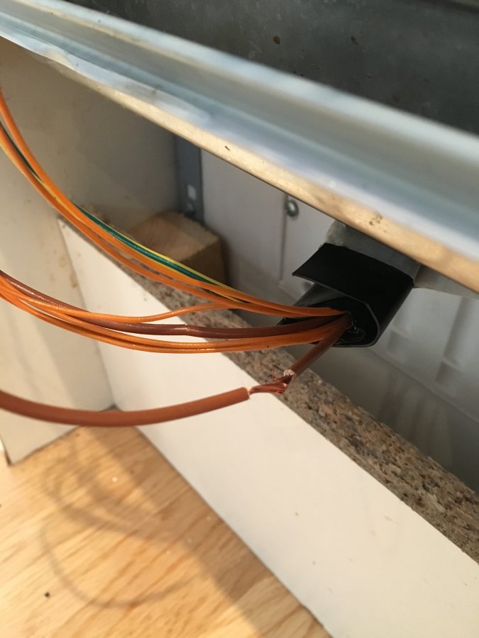

Is the area around the wires supposed to look like that? Do they melt the plastic surface to sink the wires under the metal bar?
Yes just join them up and put the wires on the outside of the bar.
Pic 3 has a burnt wire. Cut it out and use a connector to join them up

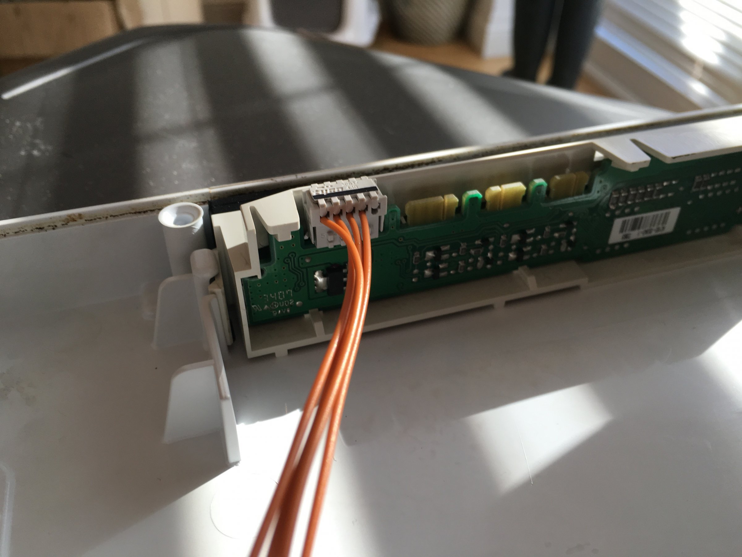

Is the door switch / mechanism actually working? Need to prove this first.
As your aware you will have lights etc and be able to change the wash cycle on the top panel with the door open or closed. That is of course providing the on/off button is in the on position as it is showing in your photo due to the cycle light lit up.
As per 'rocks', check the wiring but just looks like melted black gunge from the door panel due to heat, but is clearly a sign of heat issues so internal wiring could be compromised even if the insulation appears good. Wires can become brittle and break, excess heat from door due to hot water and the opening/closing of the door.
After checking door switch, my advice would be to check continuity of each wire, end to end, rather than breaking into the wires at the door.
Problem solved, it turns out one of the brown wires had snapped. I joined them together again and voila, it works.
Thank you everyone for your assistance.
