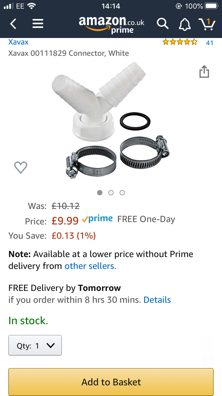

Found another solution which maybe easier
what do you think ? Or future headache lol

All fine until they both try to empty at the same time and then there's back pressure created and pop, something gives!
Ohhhhhhhh
I’ll stick to more conventional methods :) (Frank Spencer moment has passed)
That size of connection/pipe diameter was never designed to take 2 appliances pumping out at the same time. They'll be betting on that it will rarely ever happen.
Is that for the water supply or waste? Waste is a non starter as explained, alternatively if you want to split 2 supplies from one tap, a Y piece will suffice, (not ideal though), but get a brass one. Plastic Y's have a nasty habit of leaking, and wont handle any stress put on them by the attached hoses. Often are a one way ticket to a flood....
