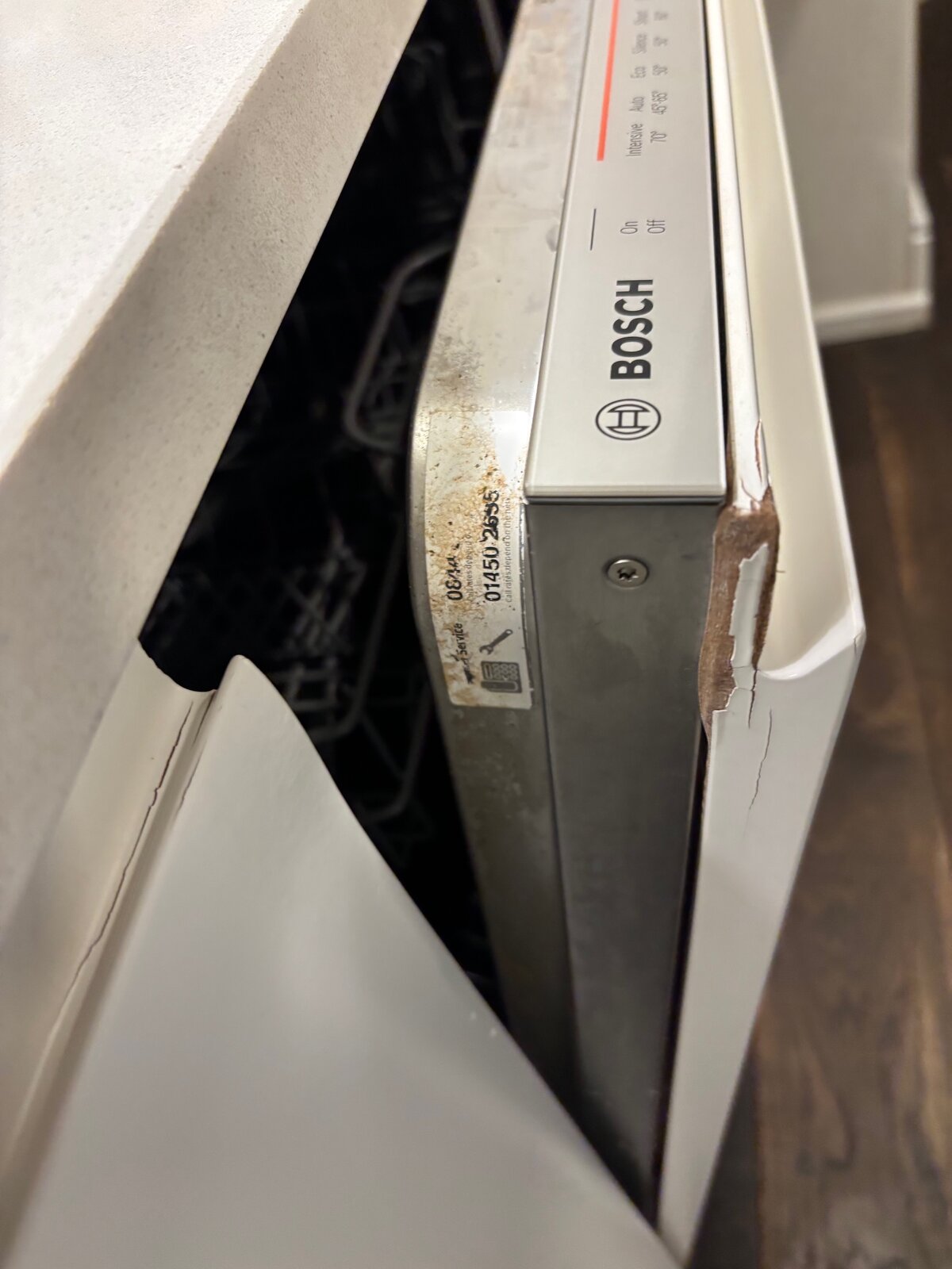

We have a Bosch dishwasher which seems to be emitting steam or condensation from the top. It's delaminating our door units.

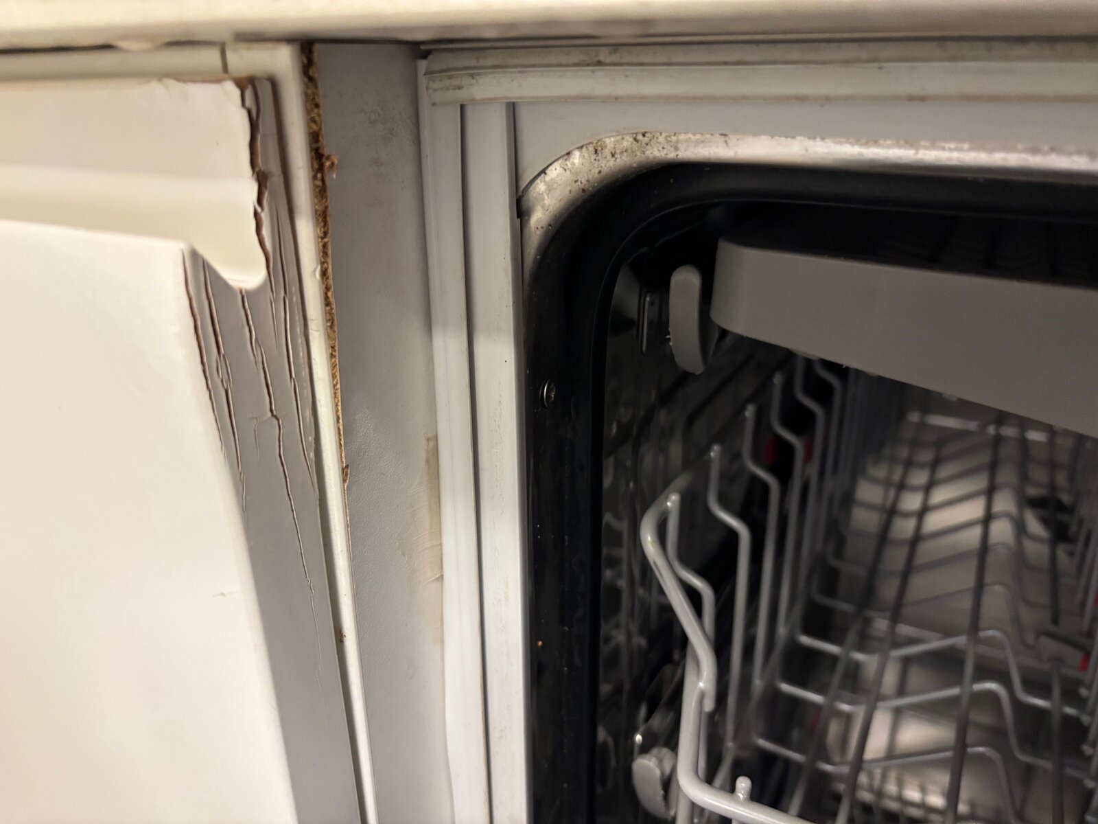

I've taken out the door seal (3/4 of the door rubber thing) and cleaned thoroughly and it seems in good condition. Does anyone know what could the cause and preferably the fix?
The Rubber Seals around the door will (should) stop water and steam escape. Check they are clean and the door face that mates to the seal. Replace seals if damaged. Smear a little silicone grease on the seals if they seem OK? Test for closing tightness with a piece of paper or thin plastic strip?
Opening door (ajar) when wash just finished allows a lot of steam escape. Don't do it. Leave for many hours to cool down.
Some dishwashers spring door ajar to cool at end of cycle. (Daft idea imho). Dunno if that can be disabled in a menu setting?
Bosch/Neff/Siemens supply metal deflector piece for fixing to underside of worktop specifically to help with this problem. Something similar might have helped from new but too late now, looking at that damage to those door panels.

It looks to be integrated could the swelling of the matching door be preventing a proper seal. I have the same dishwasher without any problems. The door opening at the end of the cycle aids drying but is disabled by default unless selected as part of the wash cycle.
