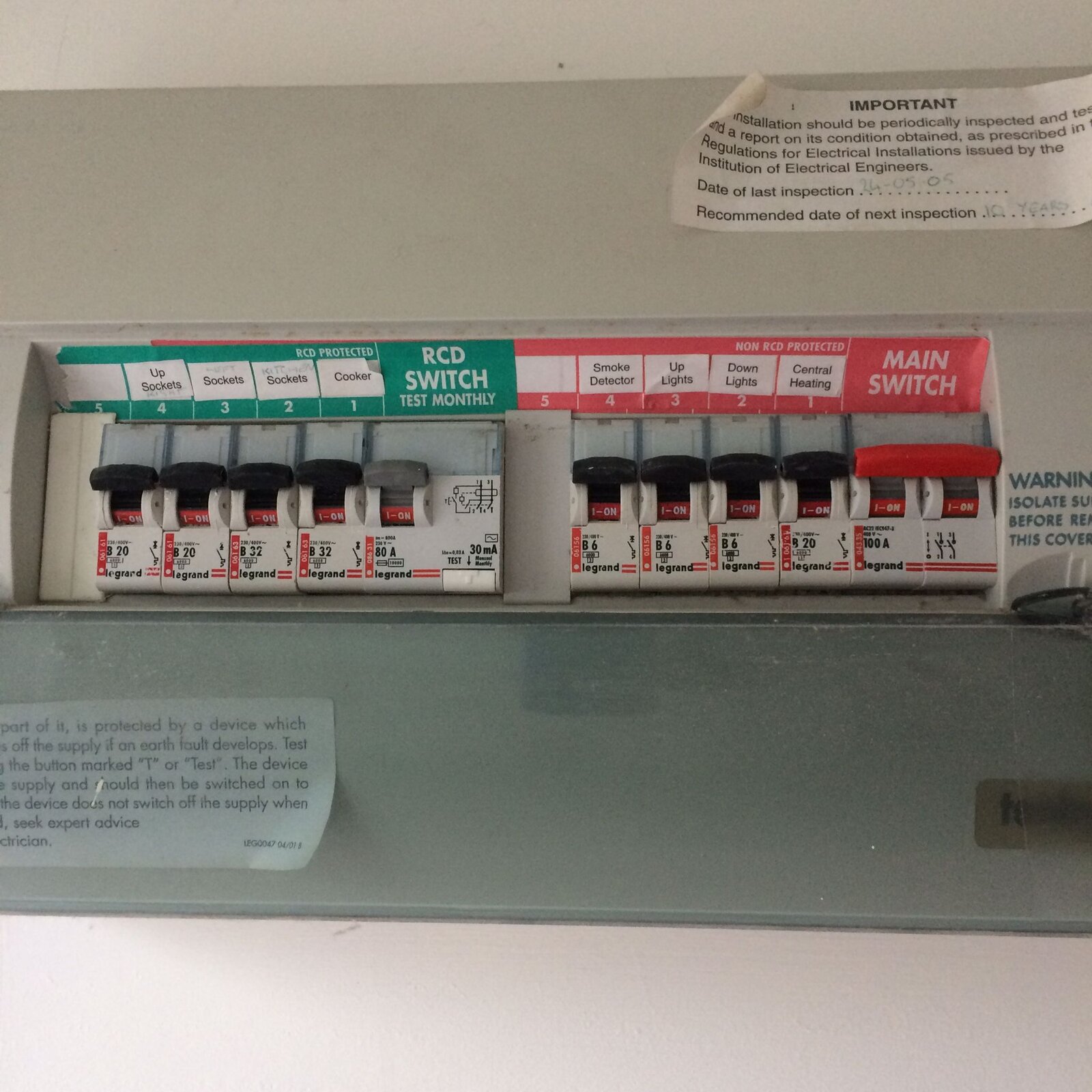

Dishwasher still tripping after leak repair
A photo of your consumer unit, with the flap open, may show if fitting an RCBO is feasible.
Ok. I wasn't sure if someone earlier in the thread said that if I only have one RCD, then there's no point changing circuits.
Do you have any socket circuit not supplied via an RCD, where you could possibly test it using a plug-in RCD?
Thanks for the help all.
Here is the picture of the circuit board, and I don't think there is a plug that's not supplied via RCD unfortunately.
Couple of questions, can an earth leakage be caused by an appliance that is off but still plugged in? Or do they need to be in use as well? I'm just trying to make a list of al the appliances that are on when we use the dishwasher, to see if there's something else going on.
I'm getting concerned that we could have another water leak in the house which is getting into the electrics. Had loads of bad luck this year so wouldn't surprise me tbh.
I just hope the electrician can work this out tomorrow, this is driving me a bit insane.

I can't make sense of any of that. There is only one RCD.
Houses are wired in circuits and ring mains etc.
Each circuit is protected by a MCB, Each CB is protected by a RCD/RCBO
Yes, the RCD sits at the top of the pyramid, but the circuits are individual.
If you are plugging in the Dishwasher into a different plug, then use a different circuit is all i am suggesting.
The dishwasher plugs into a SOCKET not a plug.
Using a different circuit makes no difference as they (all circuits) go through the same RCD.
Socket - there isn't one not supplied by RCD.
Yes.
Not necessarily.
How would you be able to tell?
Yes - needs test equipment.
Any chance of one of you answering my questions rather than argue again? :D
Heh
In fairness, nothing is going to be fixed here so the electrician will sort it for you before we stop here.
An update would be great.
The electrician should fully test the circuit and the house whilst changing and sockets so that should the problem persist, you can be reasonably sure its the dishwasher not the supply at fault
Thanks both.
I just like to figure things out myself, but this is probably beyond me obviously. I was sure it was the socket, because it was fine using the extension lead, however it's gone with that now. But I did change extension leads 2 days ago because I needed the longer one for the xmas lights.
