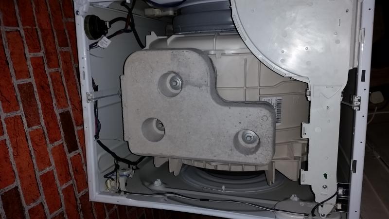

display confusion with wd860

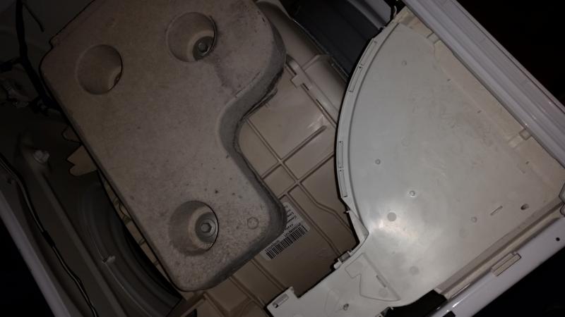

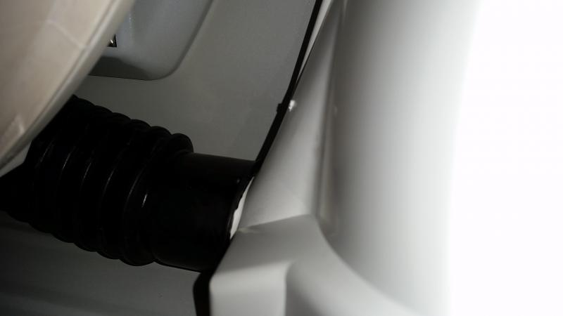

Your 4th photo shows a round black pressure switch (top left corner), then disconnect the hose (pipe) and blow down it to check its not full of water or blocked.
Does this make any difference to operation of the machine?
Do you have a multimeter for further testing?

I blew down the pipe, it didnt feel like there was water down it and unfortunately it still come up with the error about 5 minutes in.it does sound like it takes water in though and it takes the detergent.
I dont have a multi meter but I can get on tomorrow if that's okay, if you have time to assist. I still wonder if it is lack of pressure but it has done a few washes before the error so not sure why it would start now throwing h2o errors.

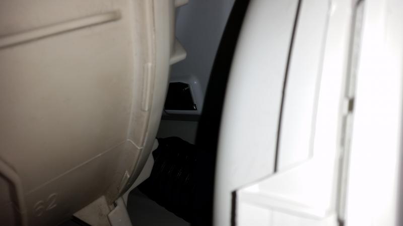

Under the dispenser is a 2 inchish black hose, awkward to get to without lifting drawer out, check this is clear, remove drawer and pour water into the housing, should immediately flush away and pour into the drum.
OR
When you switch on the machine you will see water coming out through the jets on the top inside of the dispenser (with drawer removed), it will then flush away through the bottom hole into the hose and into the drum. You should see the drum fill after approx 2 mins from start. With no clothes in drum should fill just past the bottom of the door.
