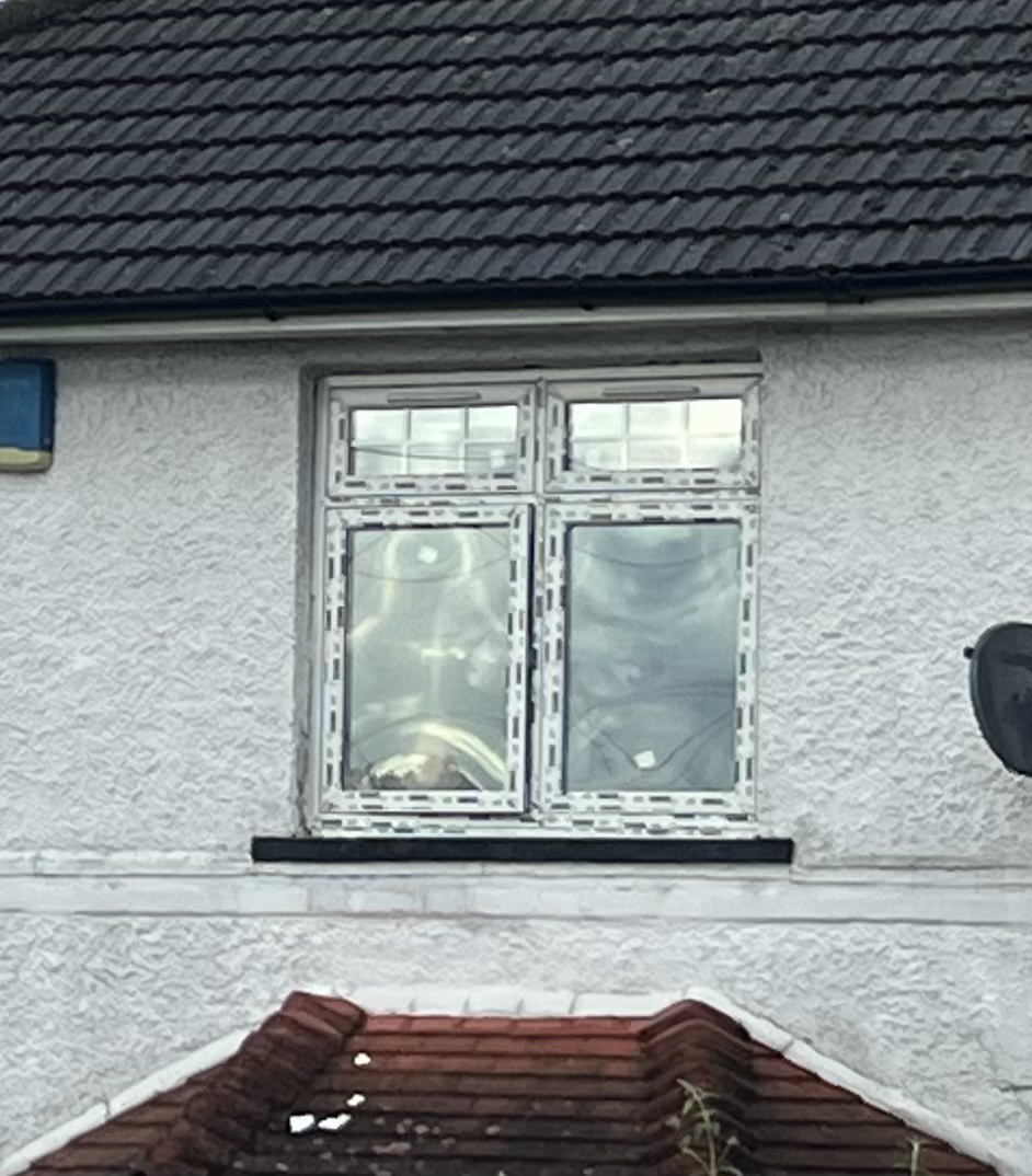

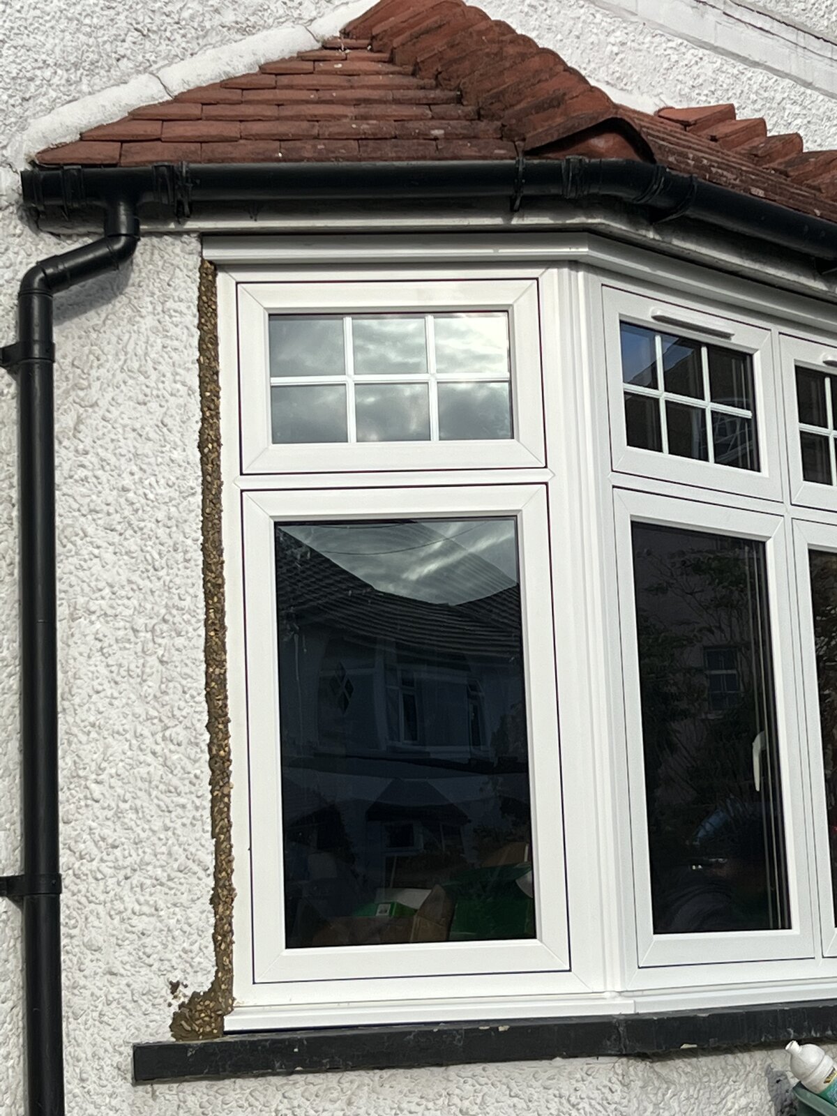

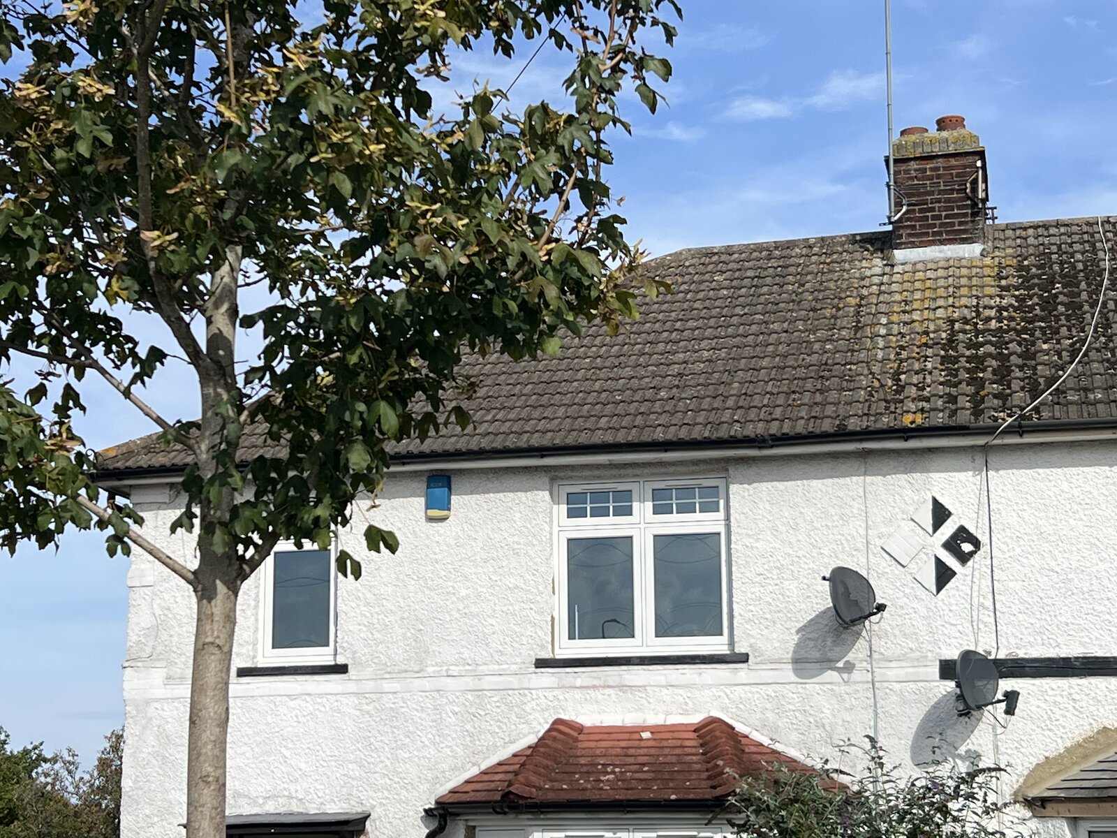

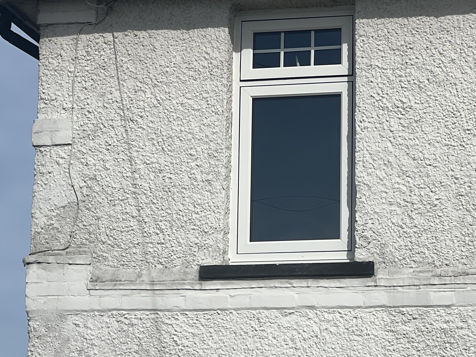

I’ve ordered grade A double glazed windows and the way light and other objects, like overhead cables, reflect off the glass gives the impression that it is warped or wavy. For example the straight cables look like they bend in two directions. The neighbours windows don’t have this but there are some other houses I’ve noticed that have similar warped-looking windows. My windows contractor tried a different glass which was slightly better but still has the same issue. The contractor is saying this is a property of the newer glass offering more heat protection. He said it may also be related to the position if the windows. Is this true or is it just poor quality glass?
It’s very unpleasant to look at and I’m trying to find a solution but my windows contractor is saying there is not much else that can be done.
Pictures attached.

is the glass toughened - the heating process can warp glass and toughened glass is often not flat.
The low emissivity coating has a very short shelf life and can get easily damaged - if It’s touched before assembly it can show weird marks - the image with the protection tape still on the frame might be showing this effect.
please note low e coating are positioned on the inside of the double glazing, on face 3 counting from outside
I would guess your glass is a soft coat low e coating on the internal pane and low iron glass on the outside - it’s probably not possible to see which glass is causing the problem - maybe shining a torch at different angles might help show what’s going on.
In my experience float glass only gets a bit floppy when the pane is pretty big - over say 900 x 900.
Its true that large DGU units can have glass that is not flat - they usually present as a bit concave - if you have a straight edge you can check for this with a set of feeler gauges.

Hello, thanks for the response. The glass is not toughened, but the inside glass has a low-e coating as you were saying.
So are you saying this is a fault of the glass and that it’s not supposed to look like this? Is this likely a fault of the batch or do you think it’s normal for low-e glass?

These are argon filled windows. Any opinions on why the glass looks distorted? Is this normal? How can I get low-e glass that does not look distorted or wavy, like in the pictures?
I don't think you ever will if I'm honest
So in your experience, the higher the “Low-e” rating, the more distortions? Is there a grade at which these distortions are no longer seen or are negligible?
I don't think it has anything to do with the Low e coating or A rating, it could be how the glass has been floated, how it's been toughened if it is actually toughened or simply because of the manufacturing process, like I say I'm not an expert on glass unit manufacture
Have a search for Sheet 4.10 from the Glass and Glazing Federation. This details the specification for visual quality and the common issues and acceptability of them.
That last image does look particularly bad and unacceptable. I've seen better sheets of plastic on bus shelters.
