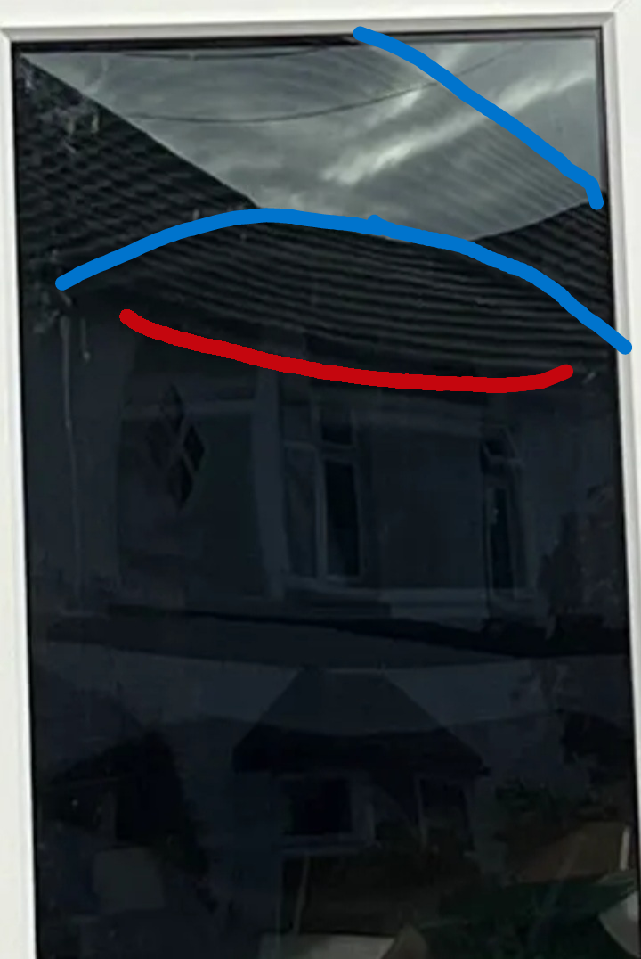

Distorted reflections on window glass

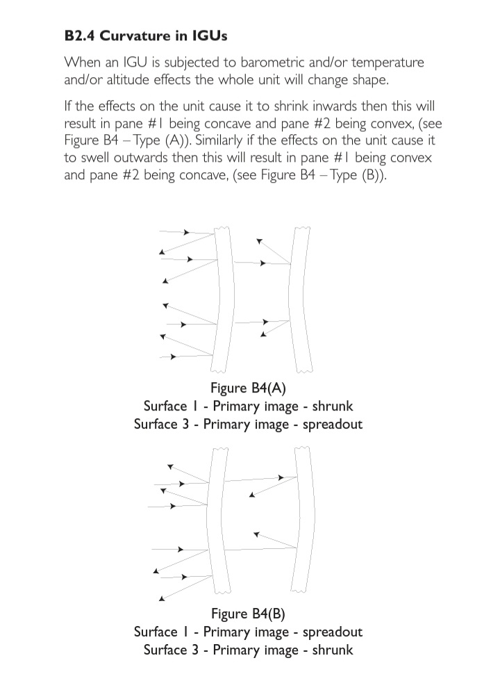

Have a search for Sheet 4.10 from the Glass and Glazing Federation. This details the specification for visual quality and the common issues and acceptability of them.

Looking back at your photos, if we take for example, the reflection of the roofline...
We see one reflection being bowed upwards (blue) and a second reflection bowing downwards (red).
This is the phenomenon described in B2.4

...and is what @Harry Bloomfield described in post #2

I don’t quite understand how the explanation from post #2 can be correct; surely if that were the case then all windows will appear distorted except on very rare occasions when the ambient pressure equals the pressure within the gap, which is not the case because most windows look straight (all of the time, as far as I have noticed) despite fluctuations in pressure. Unless you’re saying the pressure in my windows is wildly different from the normal bounds of ambient pressure in my location?

Sealed units, despite there name are leaky. A best case leak rate is quoted as 1% per year.
Older units will have less differential pressure differences, than new ones.

It doesn't really matter where they were produced, what matters is the prevailing weather conditions at the time they were produced. When your local weather conditions match, those at the time they were produced, they will be flat.
Exactly - the OP's panels are new.
Ok so to make sure I understand, you’re saying all windows will likely have this distortion effect unless the ambient pressure happens to match that of the pressure inside the windows, but that with time this effect will reduce because of leaks which will enable older windows to equalise with ambient pressure more easily?
Correct!

Thanks. All the sealed units have these terrible distortions and he tried a sealed unit from another manufacturer that he had used on another job (it wasn’t the correct size so he just held it by hand while i had a look) and they had the same distortions. So I don’t know what the solution is.
That's odd that sealed units from an alternate supplier had same distortion. I would expect a small amount of distortion but that last picture almost looks like the Mirrors you get at the funfair
