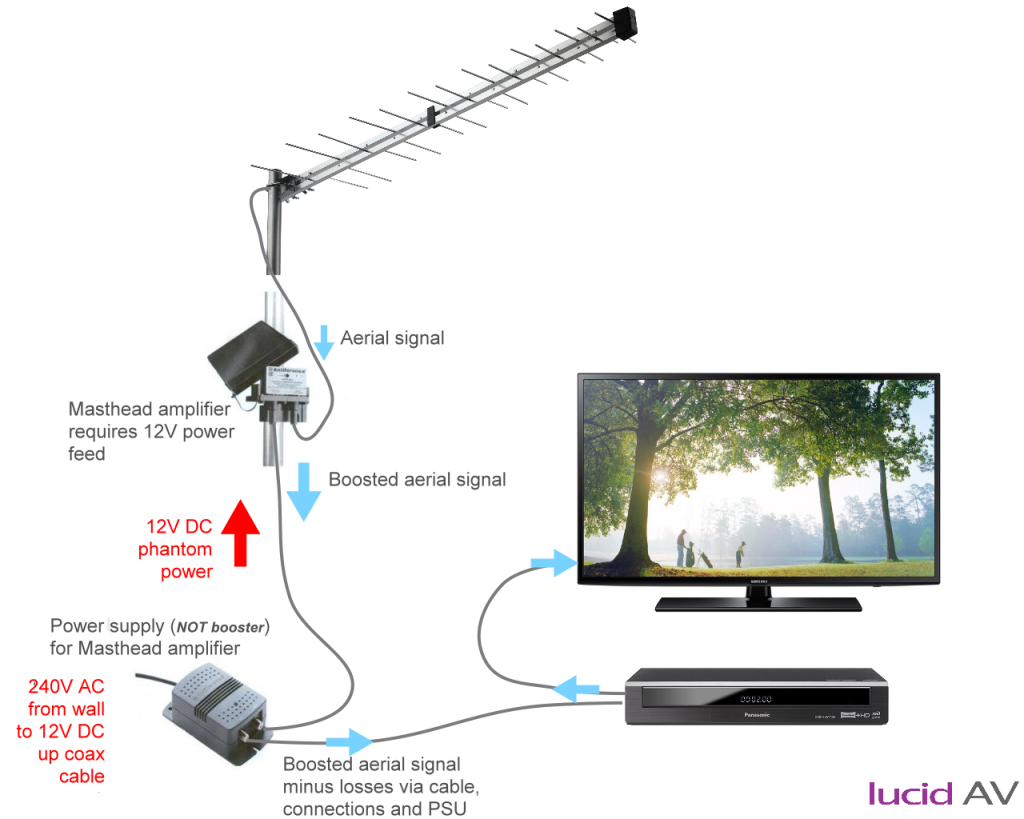

I have an aerial distribution system to 1+ 4 TV's, using a Wolsey WPS100/1

A Wolsey WPS100/1 is a power supply for a masthead amplifier. Shoving RF into it from a sky box or any other device will achieve nothing.
Well it supplies a tv signal to the other tvs. So how do I get the SKY into the system
From the sound of it you have a simple aerial distribution system. The thing (amplifier) that feeds the four TVs is either a box attached to your aerial, or it could be a box in the loft. Either way they both do a similar job: A signal from the aerial comes in to the box, it is amplified and split four ways, each output then feeds a TV in your house.
As others have said, the WPS100 is a power supply for the amplifier. What's confusing for most people is that the power from it goes in to the aerial cable which at first sight appears to be a very odd thing to happen. That's why these things get mistaken for an amplifier in their own right. What's happening is that the amplifier (on the roof/in the loft) uses phantom power. The same bit of aerial cable that carries TV signals down from the roof/loft also carries power but in the opposite direction. Here's a graphic I did a long time ago for a similar kind of question. It shows the signal flow (the pale blue/green arrows) and the power flow (red arrows).

If you have your head around the signal flow then you should start to realise why you're having trouble getting the Sky signal from the I/O box in to your aerial system so it can be seen on other TVs. The answer is that the signal flow direction is going in the opposite direction to what you need.
In order to get the Sky I/O box signal in to your aerial distribution amp two things would need to happen. Presuming you still want to watch Freeview on the TVs when they're not being used to watch Sky, then the first is that you need an I/O box that has an RF Input as well as an RF output. You might already have one of these but I don't think you've mentioned it yet. Second, the signal direct from the aerial (wherever it lives) needs to be rerouted to come directly to the Sky I/O box RF input, then the the signal from the I/O box output then gets run up to the aerial amplifier. In effect then, you need a long loop of cable coming down and then up the side of your house. In other words, what's involved is a substantial rewire job for a DIYer to undertake.
