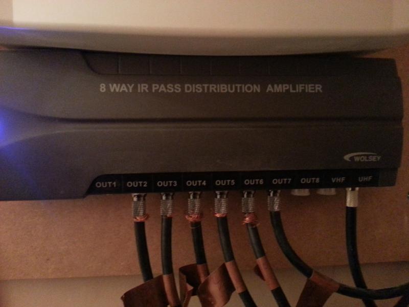

Until recently when I moved my main TV from one room to another I had my Sky HD box feeding a second TV in the master bedroom. Everything was working well. Then I moved the main TV and satelite box to another room and now we can't get a signal let alone picture on the Tv in the bedroom whixh is connected with a Triax magic eye and cable. The cables and presumably the aerial are connected to a Wolsey 8 way IR pass distribution amplifier. What I'm wondering is should I have switched something in this amplifier when I moved the TV to a different room and connected to a different TV and Return socket from the original points. The guy who installed it a couple of years ago did do something with this amplifier but I didn't see what and now I can't contact him. Does anyone know how these amps work and what might have happened when I changed the TV which has stopped me getting a signal on the second TV?
Additional info: RF output is On
When connecting the aerial to the main TV I get a good clear TV picture as well as HD.
The RF2 socket on the Sky box (9v) is connected to a wall plate called Return. The TV signal comes from a second socket next to Return called TV.
I have retuned the second TV and this makes no difference.

Thanks Lucid for your very helpful response. I can't see a model number because of the way the amp is fitted. I have attached a picture if that helps.
Yeah, it's a simple Wolsey distribution amp. UHF in for the TV aerial. VHF for FM/DAB. 8 outputs with the voltage pass thru so Sky eyes work. Incidentally, the install is a bit untidy. All that copper screening spilling pout of the backs of the screw-on F connectors looks untidy and can pick up interference.

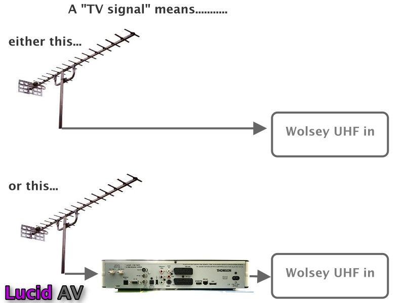

In terms of your system, here's what constitutes a TV signal
The image about showing the Sky box is how Sky's RF output gets added to the Freeview picture. The signals use different tuners though. That's important to remember when tuning: Freeview uses the digital tuner (marked as DTV on some remotes). Sky uses the analogue tuner. This might simply be shown as TV on the remote or selected as Analogue via a TV menu; it all depends on the TV set itself.
The resulting output is something like this

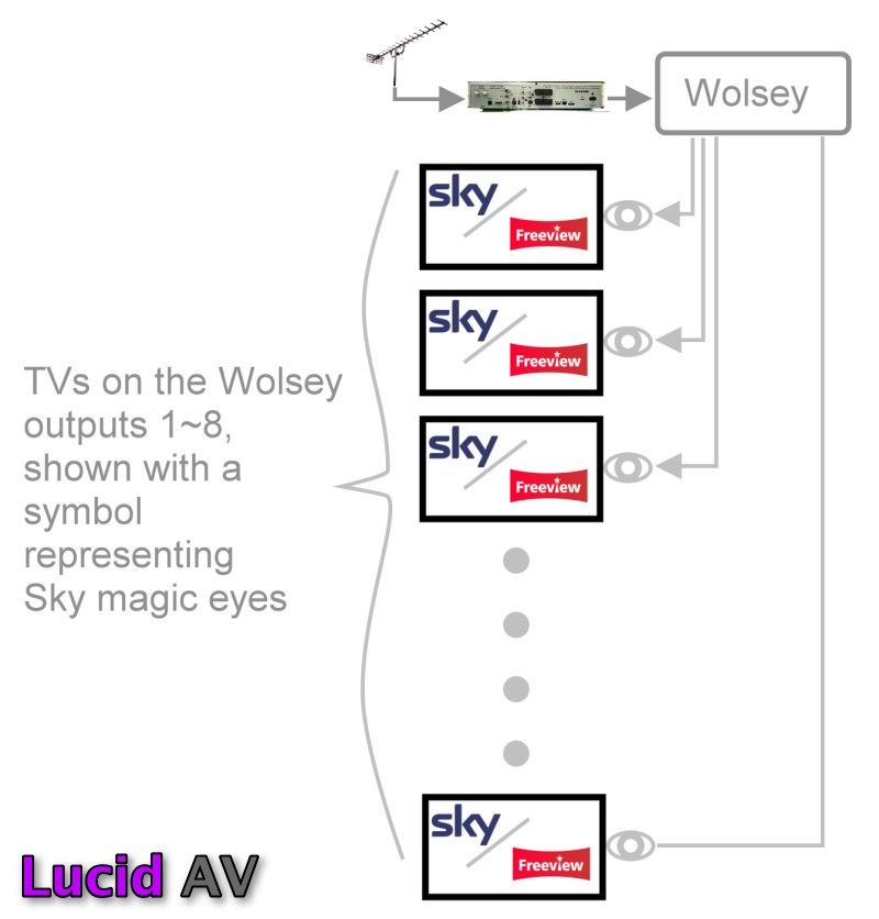

If a Sky RF2 distribution system is installed correctly, then as far as the house goes the wiring layout will look like this:
The important feature here is that the room where the Sky box is located has two cables. The first is the aerial feed. The second is the return signal from the Sky box that then feeds the signal to the distribution amplifier. If the room where the Sky box is located has just one aerial cable, then distributing Freeview and Sky would be impossible without some extra equipment.
As far as I understand it from what you have written so far, you have moved the Sky box from a room with two cables (aerial feed + return) to a room with one aerial cable (aerial signal from Wolsey amp only..... No return signal from the Sky box) and now you're wondering why there's no Sky or no Freeview for the the bedroom TV. Can you see what the problem is here?

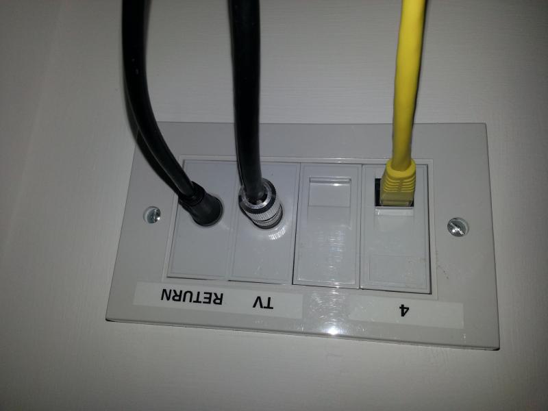

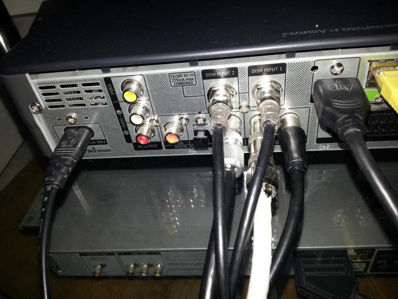

Thanks Lucid for your detailed illustrations. I can confirm though that the new room we have placed the main TV in does have two points. TV and Return. I have included pictures on the wall socket (there are connections for the wires from the Sky dish to the Sky box too but these are not in picture). And the back of the TV. I have a cable from TV on the wall to aerial in on the Sky box and a cable from RF2 to return. And a cable (the white one) feeding an analogue picture to the main tv.

Right, well if you have a return socket on the wall then it should be straight forward. This next might be going over old stuff but don't skip it. It's important to complete each step when trouble shooting...
1) Check that RF2 is giving a picture to the TV next to the Sky box. I have had a couple of situations where the pin in one of the RF sockets was broken. Connect RF2 to the local TV, bring up the Sky TV guide, tune the analogue tuner and just satisfy yourself that there's some signal coming out
2) Reconnect RF2 to the wall socket. As Sam suggested, lever out the return socket and check the integrity of the connection from inside the box.
3) Go find where the RF2 return lead comes out in to the loft or wherever your Wolsey is located.
4) connect the RF2 return lead to the end of the lead that goes to the bedroom TV
5) if not already on it then put the Sky box back on the TV Guide, switch on the bedroom TV, select the analogue tuner, retune analogue if necessary.
If it's not working and you've followed all the steps above then the most likely cause is a break in the cable somewhere. At this poingt it's time to call in a local professional.
