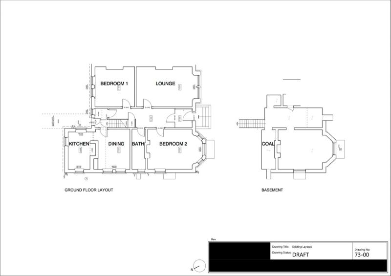

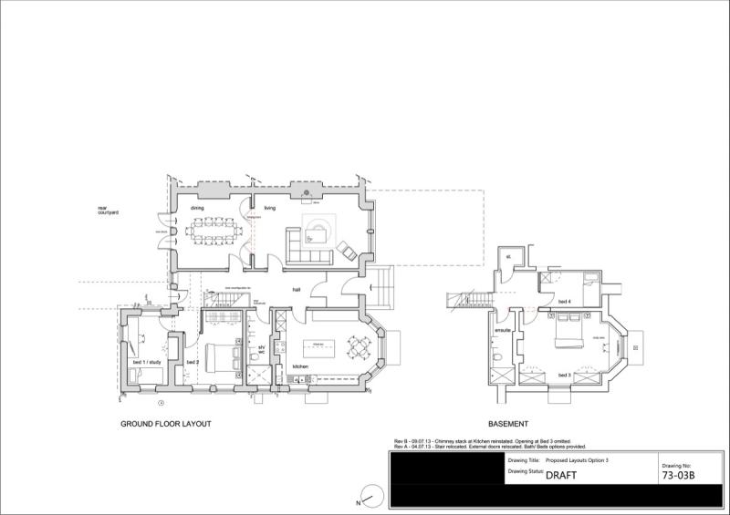

First things first here are plans of the current layout and proposed layout. As you can see we've got our work cut out!
Current layout:
Proposed layout:

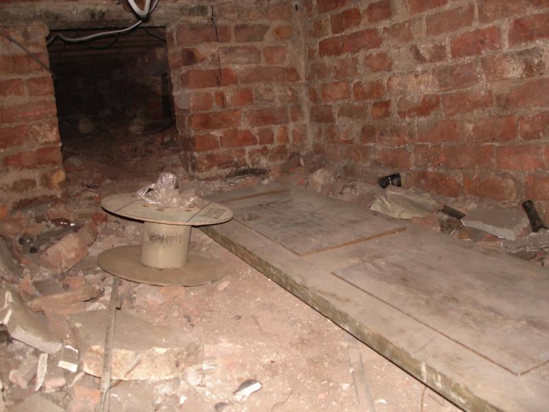

Here's a load of pics of our progress so far.

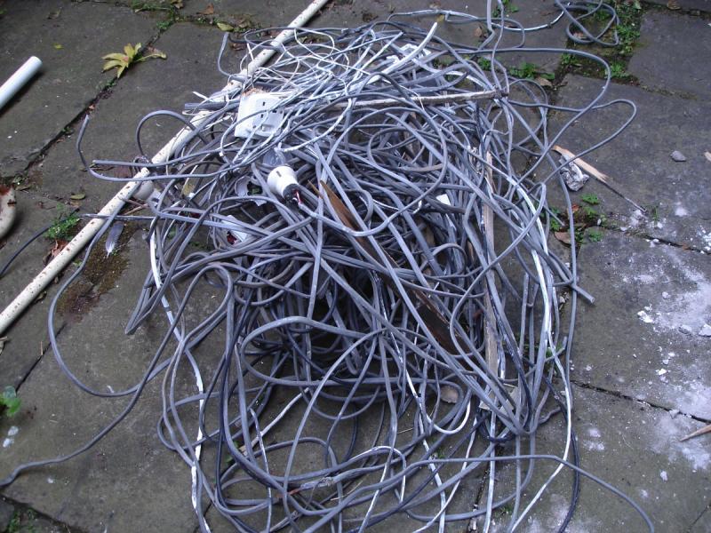

Up to now it has all been prep work. We ripped the ceilings down in the basement, then had to get under the crawl space and remove all the old wiring and central heating pipework. Loads of cool stuff under there like newspapers from 1887 when the house was built. Messy work but we got £200 from the scrappy for the cable and pipework.

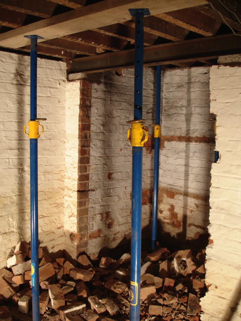

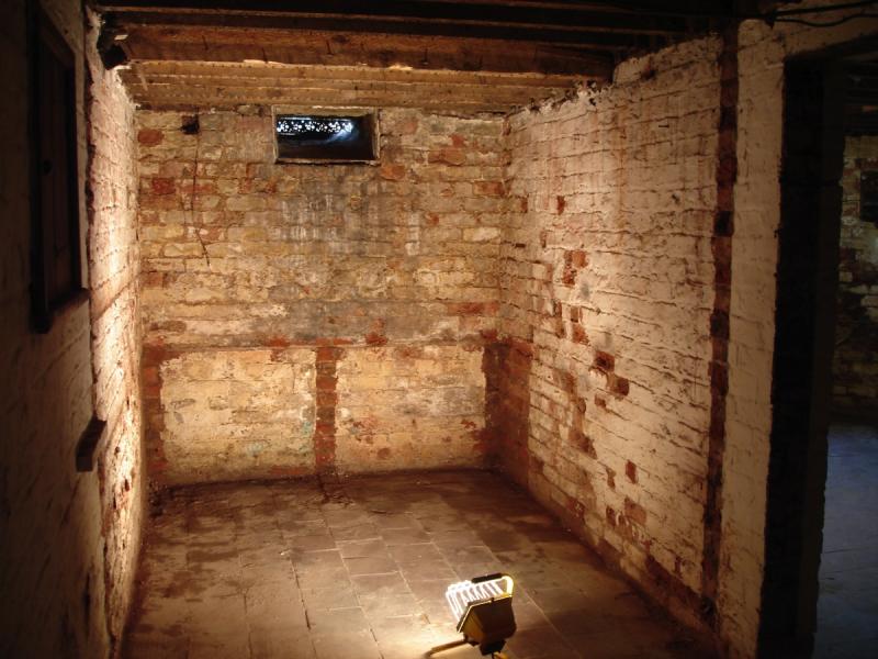

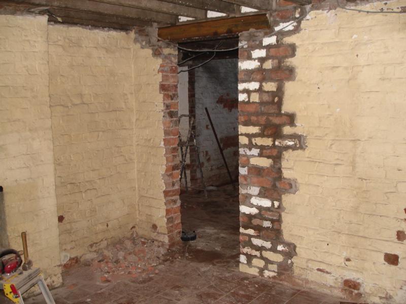

We then had to take a wall down in the basement. This was underneath the hallway, and we think it use to be a cool room as it had slate slabs in it.

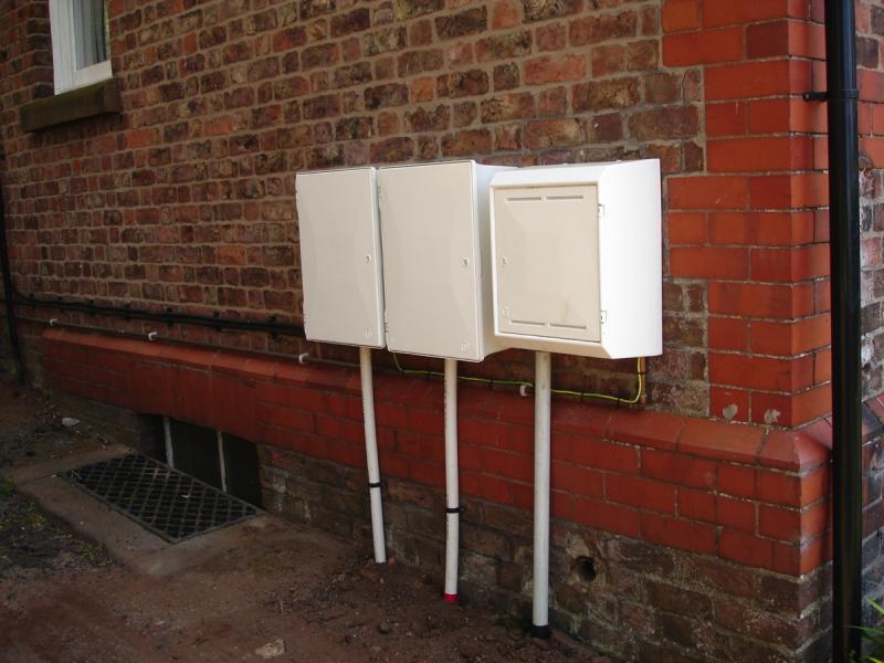

Next thing was moving all the services - gas, electric and water all came into the basement and were in the way. Obviously we didn't do this ourselves!

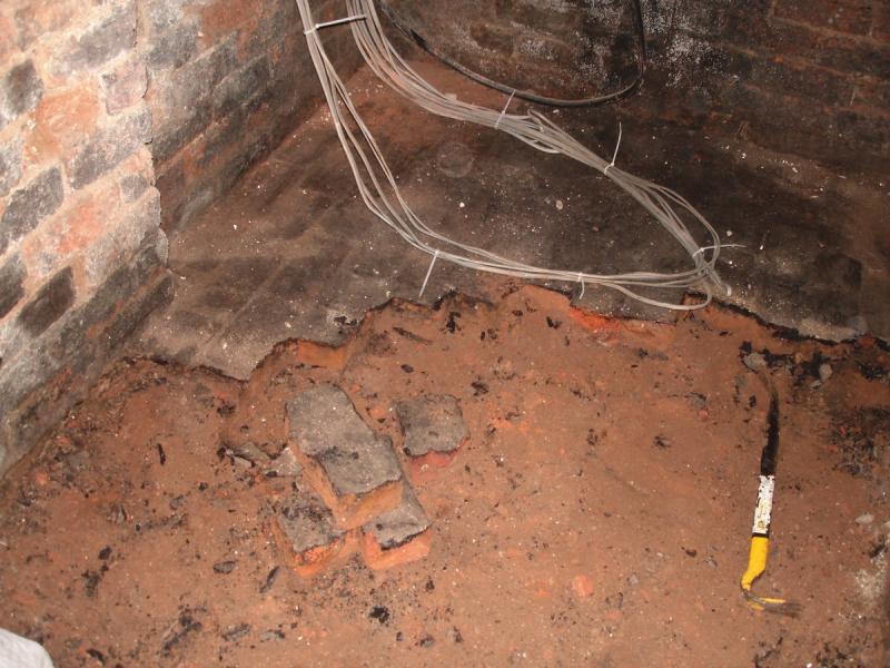

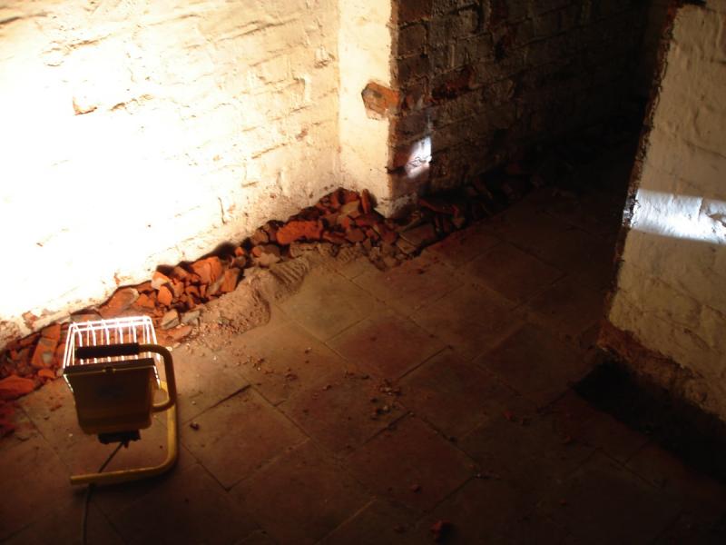

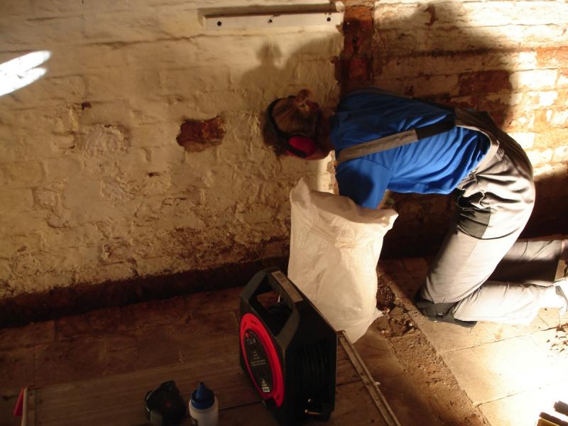

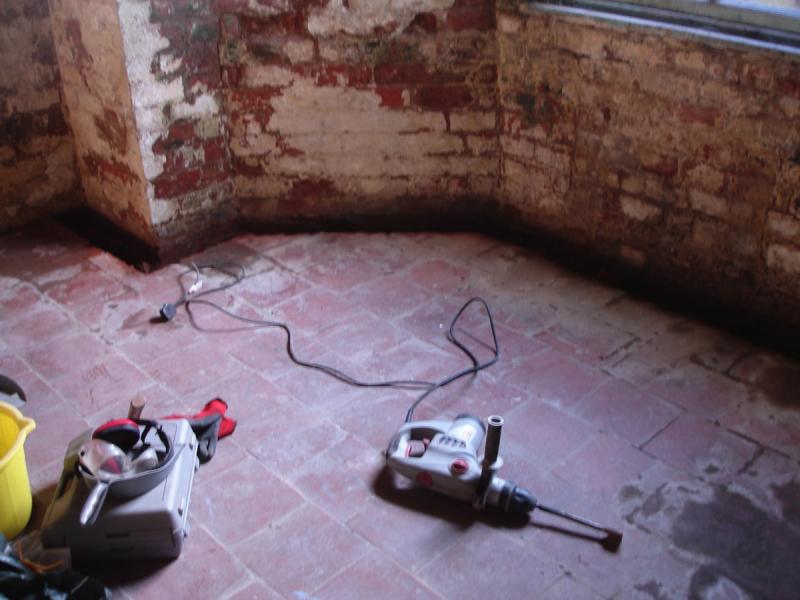

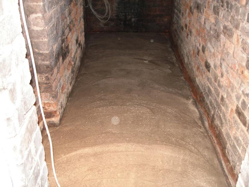

We're keeping the quarry tile floor and insulating then boarding over it, so we needed to dig a channel around the perimeter for the cavity wall membrane (tanking system) to drain into.
The coal cellar didn't have quarry tiles so we had to dig up the loosely laid brick floor, excavate to about 4 inches, and then replace it with concrete.

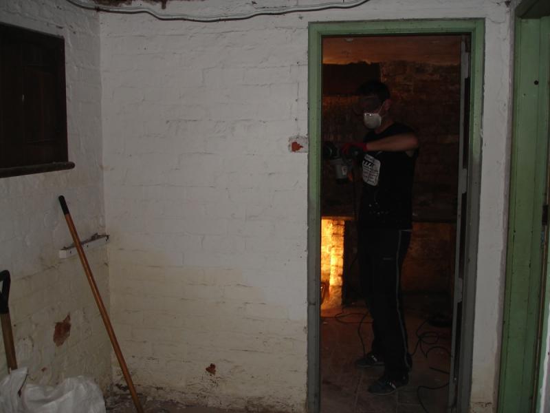

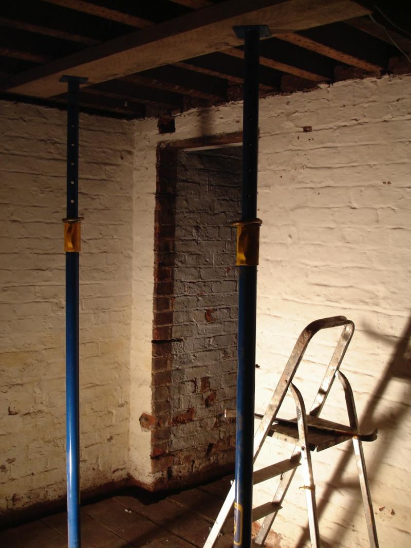

Next thing we opened up the doorway to the basement store room so that it will be a double door.
And finally we moved the doorway into the basement bedroom by about 18 inches to bring it further into the corner of the room.
That's about where we're up to now. Next things are to put a new lintel above the coal cellar door, finish patching up the floor then we're ready to start tanking.
