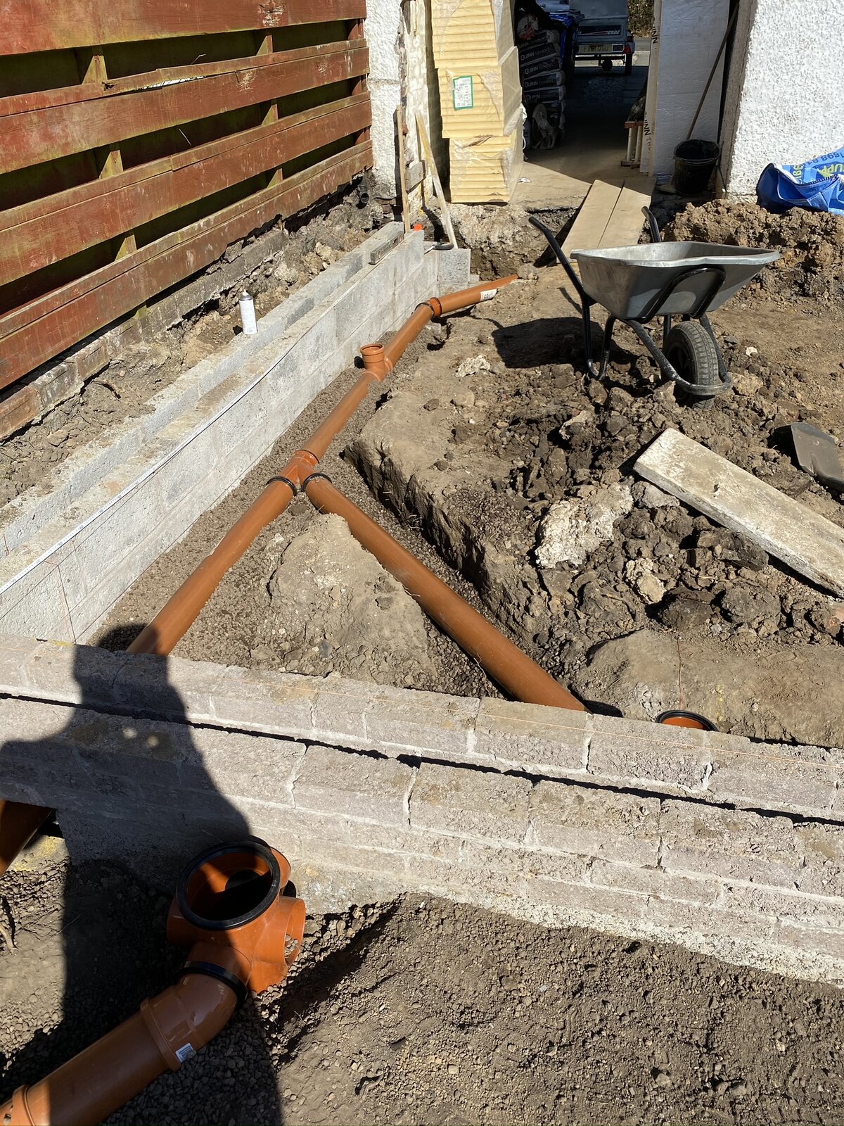

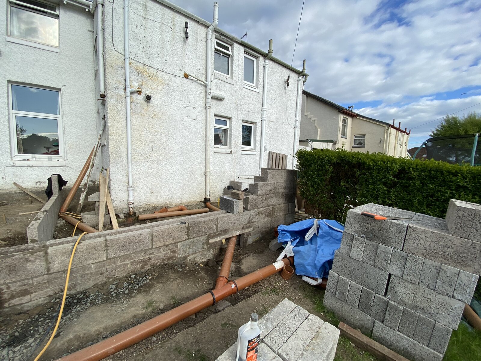

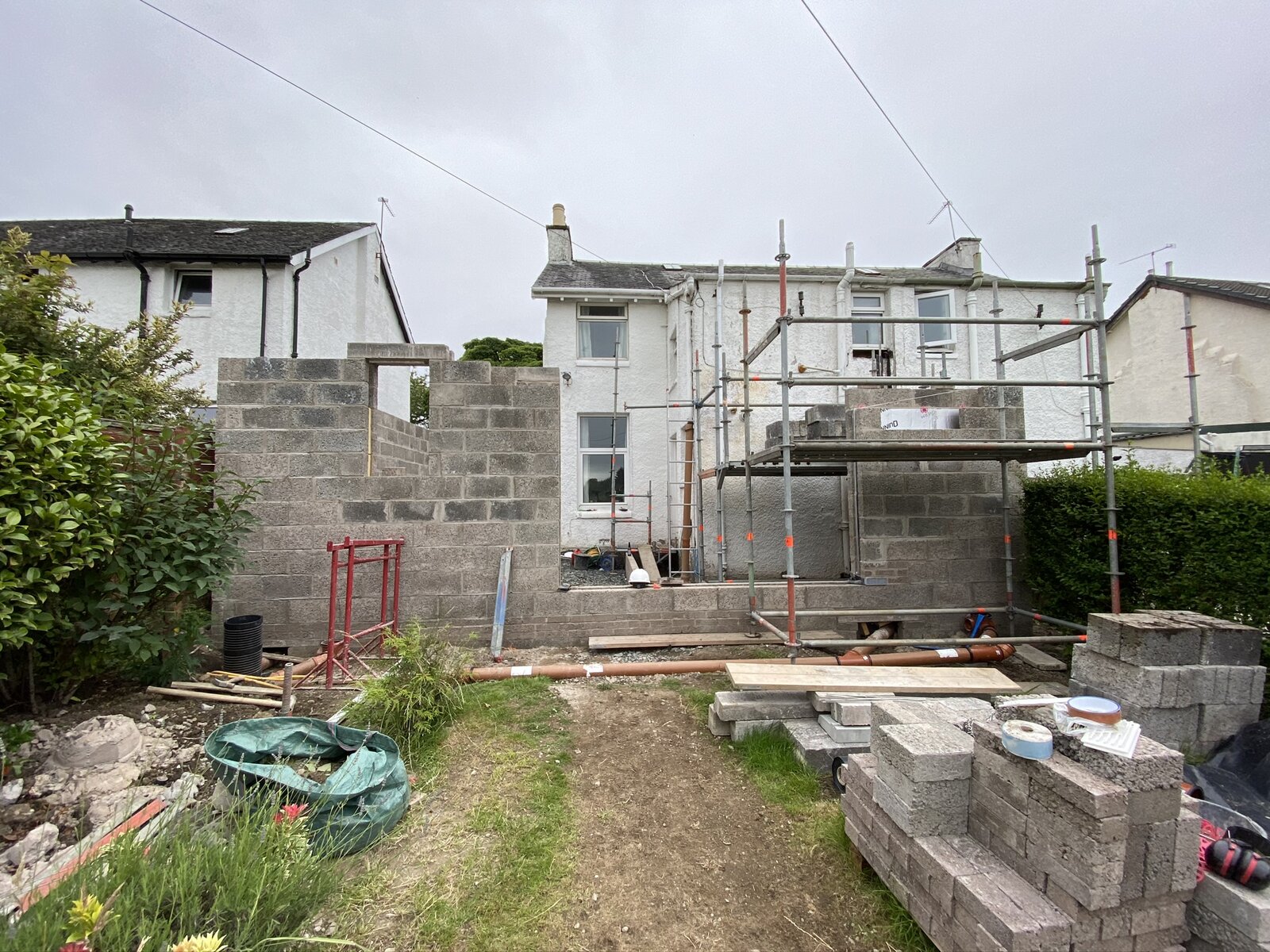

Next it was time to get the drains sorted, my little helper was on hand again
Looking good mate, made some cracking progress with the block laying there!
One question though - you've got a lot of connections/turns in your 110mm drainage pipes which will all be underground (if yo have a concrete floor), are you not worried about rodding them (or the inability to)?
Some of the bends are temporary pieces which have since been removed, the end result will be a straight run along the back and a straight run under the extension to the road with rod point at end and then the chamber.

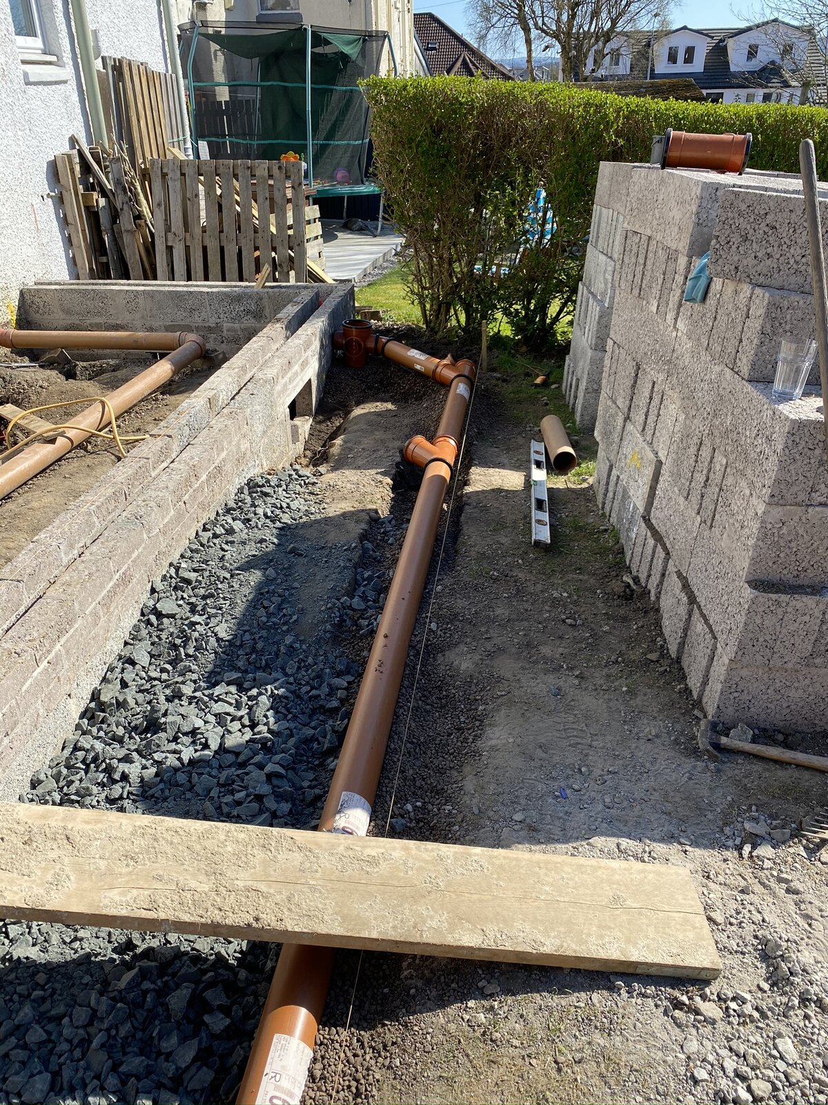

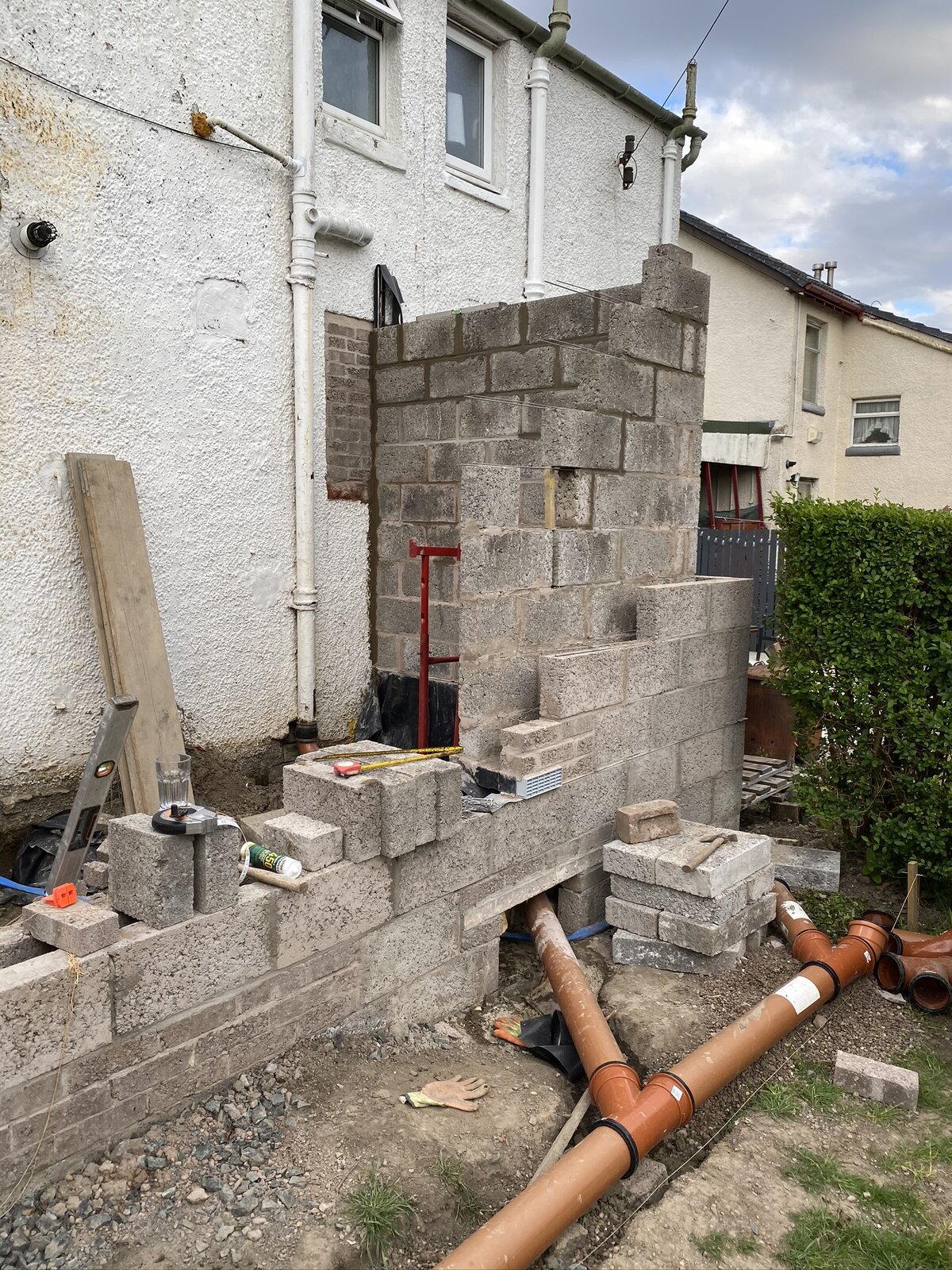

it is suspended timber and you'll also see i missed the air brick on the left so need to rectify that and sort out the brickwork over the one on the right...sometimes you do things and the next day wonder what you were thinking.
The main thing i have found is it's important to stop and think when you know something is wrong as it's much easier to rectify early.

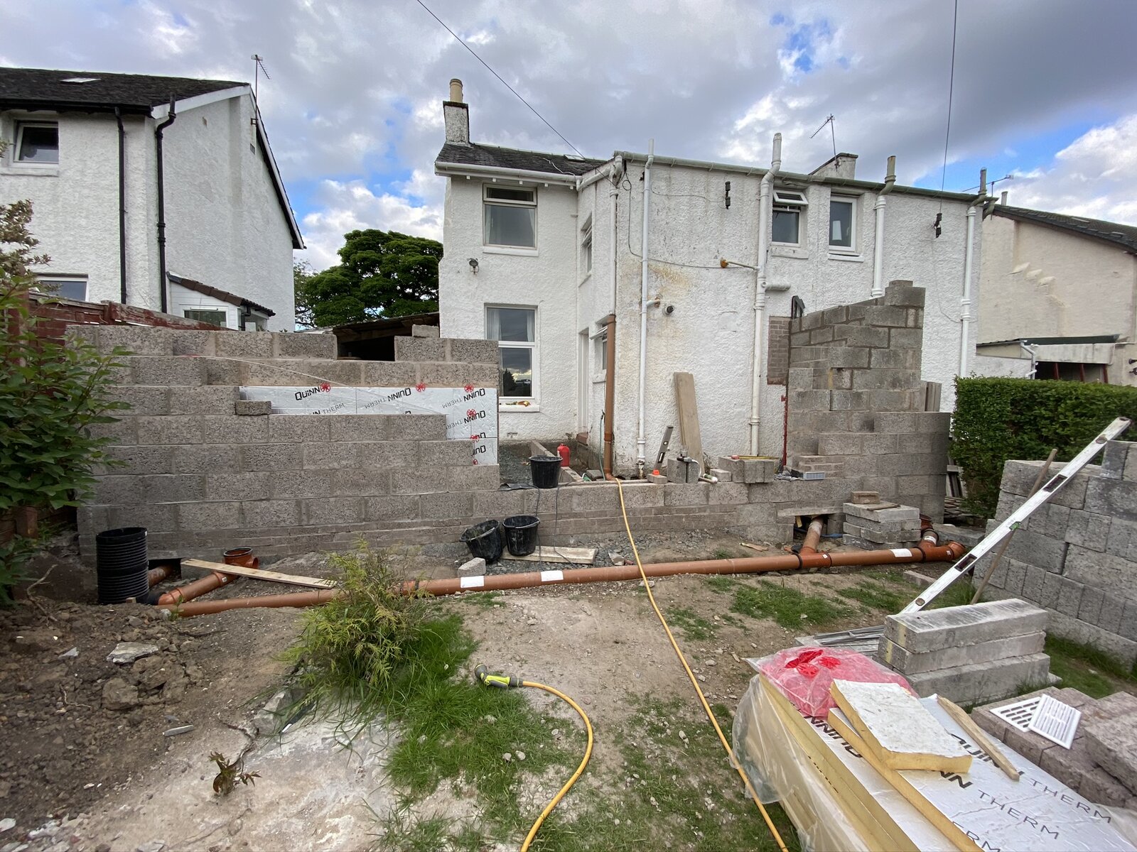

Yes, the entire build is using these from foundation to wall plate on both skins. Around 1900 blocks, Heavy but cheap at £70p+vat. I couldn’t source engineering bricks due to lockdown so cracked on with these.
We have 50mm insulation in cavity and 70mm internal to meet Scottish regs.

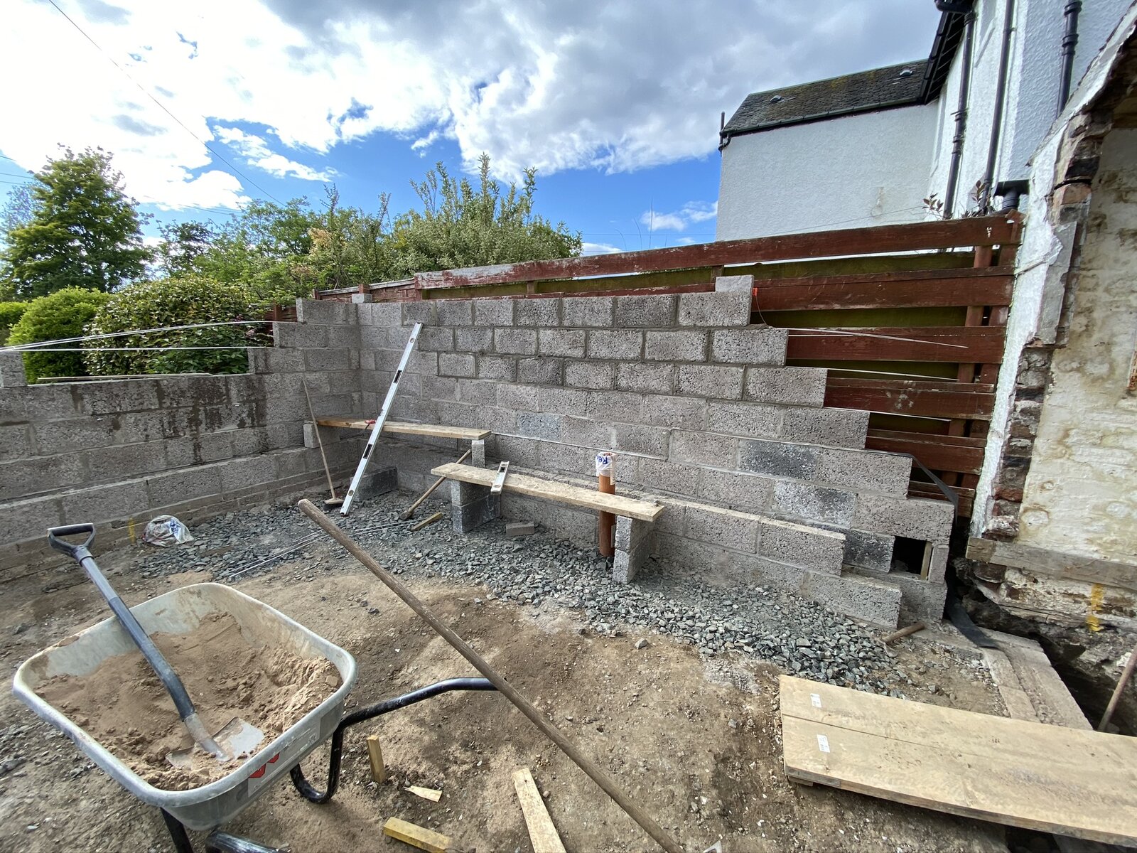

Block laying is slow if the mortar isn't mixed perfect. I've finally got it and it makes a huge difference.
had to set up a little sump for the existing shower/sink and gutter drain.

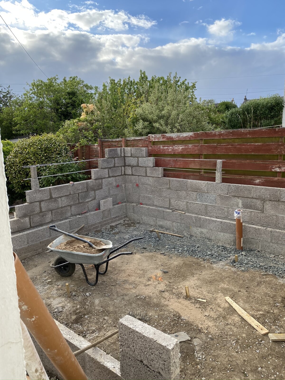

and slowly started building up the walls

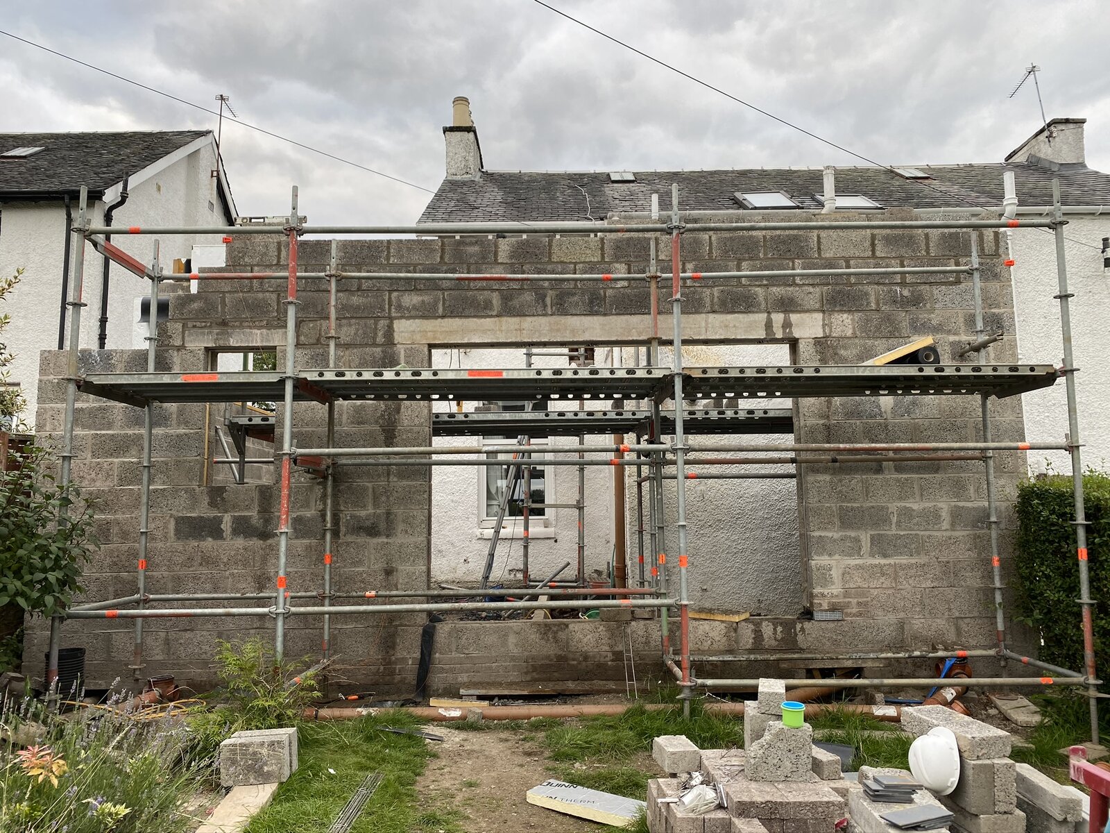

got the laser on it, i'm impressed.
taking shape

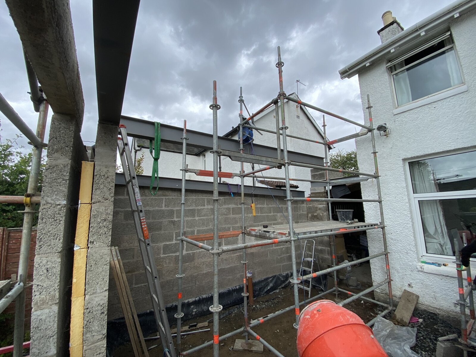

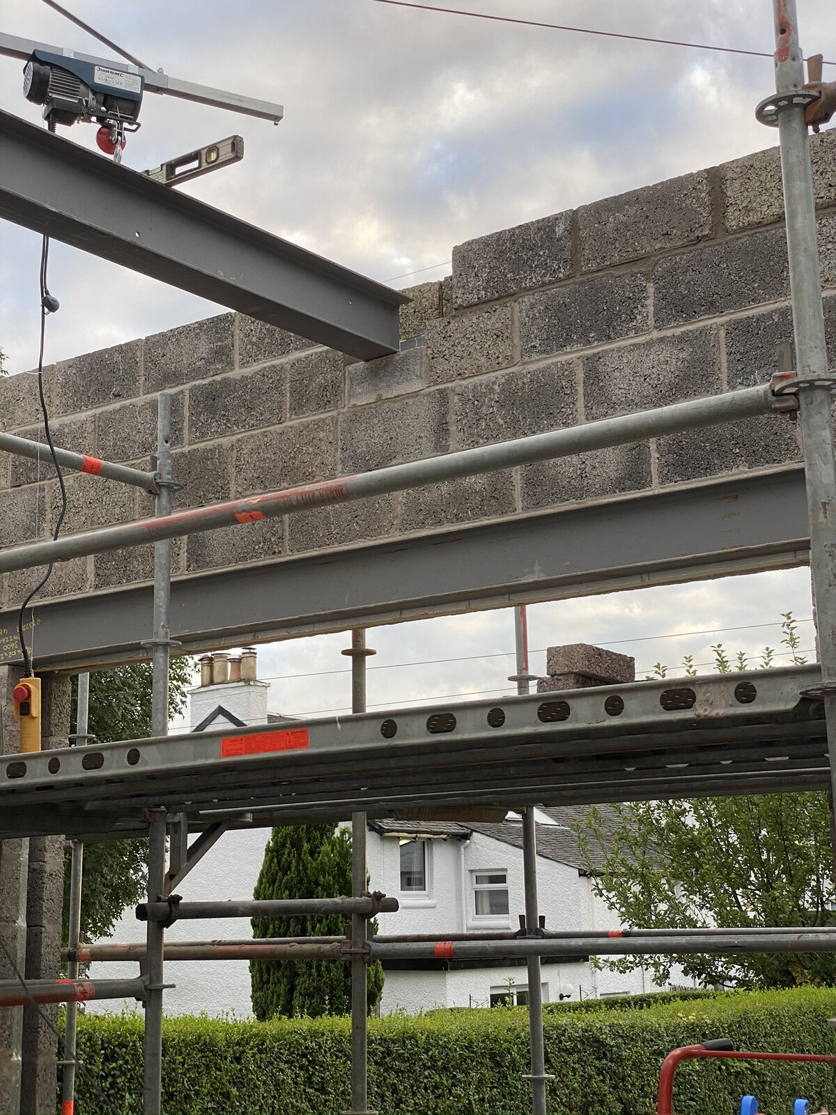

first steel in
and the next steel (got eight beams in total to go in)
and another in for the joists
and this is where we are at now. first floor joists going in next. So far I've not had a single bit of help

I think you have ventilated cavity walls on the house (looking at the airbricks?). I discussed insulation with my BC and in the end we used 60mm insulation backed PB on all external walls except for a couple where we could only realistically fit 25mm (which is about the same depth as the original plaster we took off). Insulated PB was glued straight to the brick with either PB adhesive or foam adhesive (depending on how flat it was) supplemented by a few mechanical fixings as BR. Been living in it for a year and our heating bills are brilliant. I would recommend it, but you would have to plan it in particularly for electrical install etc as all the socket backboxes need standing off the wall on blocks first. I wouldn't do this on a solid wall though, because from what I understand the ventilated cavity is essential to deal with any potential interstitial condensation caused by the colder brick wall.
Question - I see you are using mortar bed reinforcement. Was this your decision? Building control? or designed in by your architect?
Thanks for the comments @mrrusty
Regarding insulation, to meet Scottish regs i am having 50mm in the cavity and 60mm on the inside of the extension. For the existing house unfortunately its 9" solid walls which I only found out when i went to install the first beam. I've read a lot of varying advice on internal insulation on the solid walls so I have not decided yet how to approach it. The house is surprisingly warm but I want wet underfloor heating throughout and insulation will be key to that being possible.

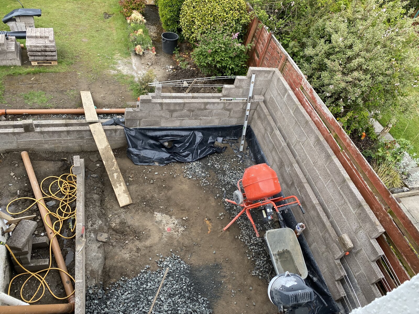

Mortar Bed Reinforcement - the structural engineer insisted it was required to prevent cracking in the render and because of the opening sizes on the rear wall, it does mean we don't need an expansion joint on the 8m wall though. Its added about £2k to the build and slows down the block laying a little too, cant really build corners as you end up with all these bits of metal hanging around your eyes.
