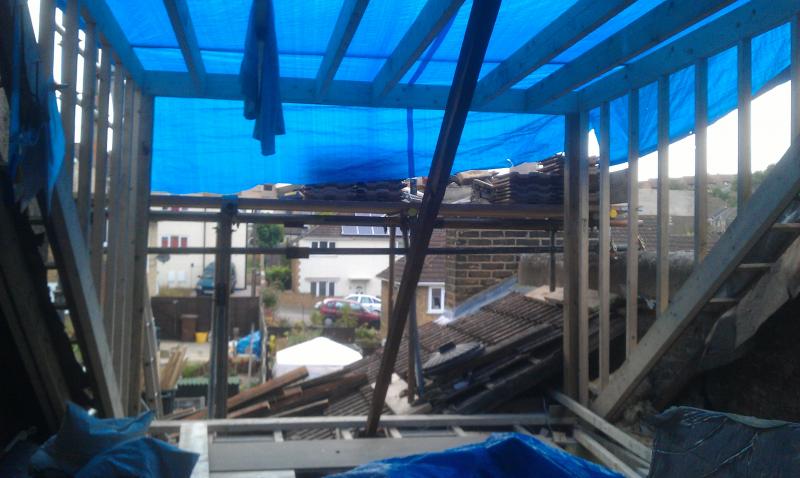

Stack removed but finishing still required. With flich beam
where the stacks ended up
is it correct that i was just working out skip size or Hippobag There is about 1.7 m^3 apparently on the floor (8*5*1.5ft)and it bricks are about 1977kg/ m^3 so apparently I shifted 3260kg of brick!!! I don't believe that
Weekends work but have next week off to complete!
All done by myself, ended up leaving the tarp on to protect from the sun during the day the roof is a right sun trap hot hot hot. Then rained Sunday night keeping me awake,
