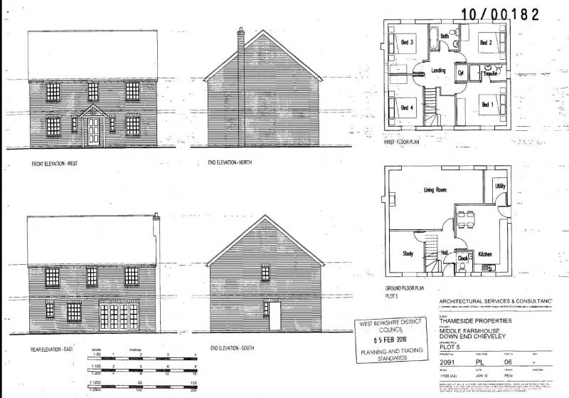

Hi all, first post so please be kind!
I will hopefully be moving into a new build detached house next feb and i would like to explore the possibility of preparing the house now for a possible loft conversion in the future.
Due to cost i cant get the builders to do it as they build the property now.
Can anyone advise what questions i should be asking now to make sure the loft conversion is possible in the future.
I only have initial plans for house - see picture.
Is there any really good websites that anyone can recommend?
Many thanks
John
Your existing loft will probably have lightweight trusses that are a pain to remove but it can be done, there was an ongoing thread on here recently with pics by someone. It will also depend what headroom you have up there, its surprising how much existing headroom is lost with the new floor structure and newly insulated pitched roof make-up, the other main issue will be getting the stair to work as you head will be getting close to the roof as you walk up the stairs. Seemingly big lofts can become quite small and impracticable following all the necessary structure etc. The only way to truly establish these things is to employ someone to do some feasibility or do it yourself!
