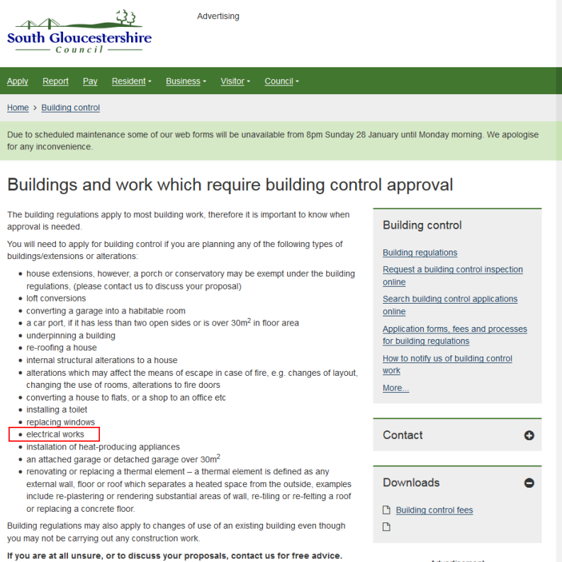

The building regulation inspection framework does not mention electrics.

https://www.planningportal.co.uk/info/200130/common_projects/16/electrics/3
Building Regulations: Checking for safety
Where the electrical installation work is notifiable it should be checked to make sure that it is safe. This checking can be done by:
  • the electrician who carries out the work, provided the electrician is registered with a competent person self-certification scheme, or
  • a building control body – either the building control department of your local authority or a private approved inspector, or
  • in England only, an electrician registered with a third-party certification scheme.
and:
Local authority building control
You may make a Building Regulations application to your local authority building control department if the electrician you employ to carry out notifiable work is not registered with one of the relevant competent person schemes, or if you do the work yourself. You should contact the local authority before you start the work and they will explain the requisite procedures to you.
It is also best to discuss with the local authority how they wish to inspect and check the works you are carrying out.
So does the Building Control fee I paid for the planning application include electrics, I suspect not.
    There aren't many who have signed up to do that, but they should supervise the work during its progress so you must employ them before you start.
Sure about that?
