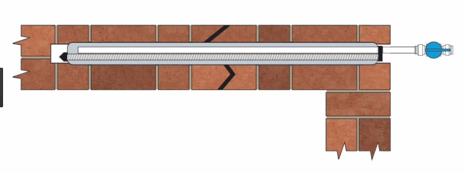

thanks for taking the time to think this through - sound plan. I will use an airline to clear loose dust from the hole and fix 2 locknuts to the threaded bar. I can then wind the bar into the hole with a socket wrench. excess resin will be ejected. wait for the resin to cure and cut off the threaded bar flush with the wall and render over. its a poor mans version of the Helifix anchor cheers
