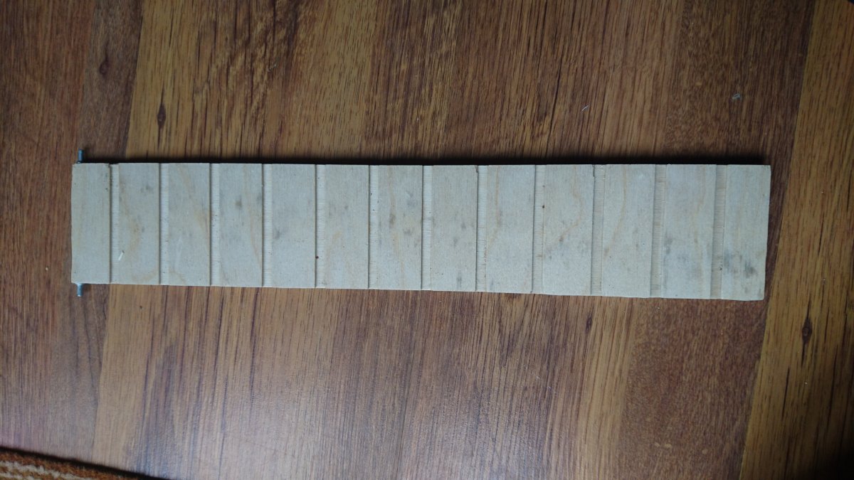

Thanks. This is only going to be small as it's for a gerbil. So thin wood with say a 4mm groove in it. I have attached a picture of what I am looking at doing so it gives a better idea.
I would still like to make the rails for the fence to ensure the fence is straight when it has been moved.

much easier to achieve by sticking timber on like lolly sticks flat where you want the slots
not safe to use short timbers on a router table also the distance between cutter and fence will be to much

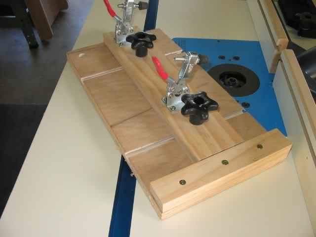

A pair of auto-adjust hold down clamps come in handy with router tables. Get some decently ply which can be made up to follow the square edge of your table and use the hold down clamps to fix the work piece to your more substantial piece of ply. A very basic sled in effect.

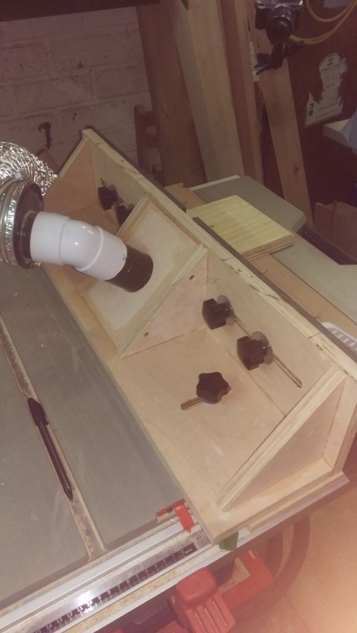

I've attached a photo of how I made my fence. It's just a free hand routed slot to accept an M8 bolt. It's a domes head coach bolt with a square shoulder to it will lock against the cheeks of the slot when tightening down the star knobs.
