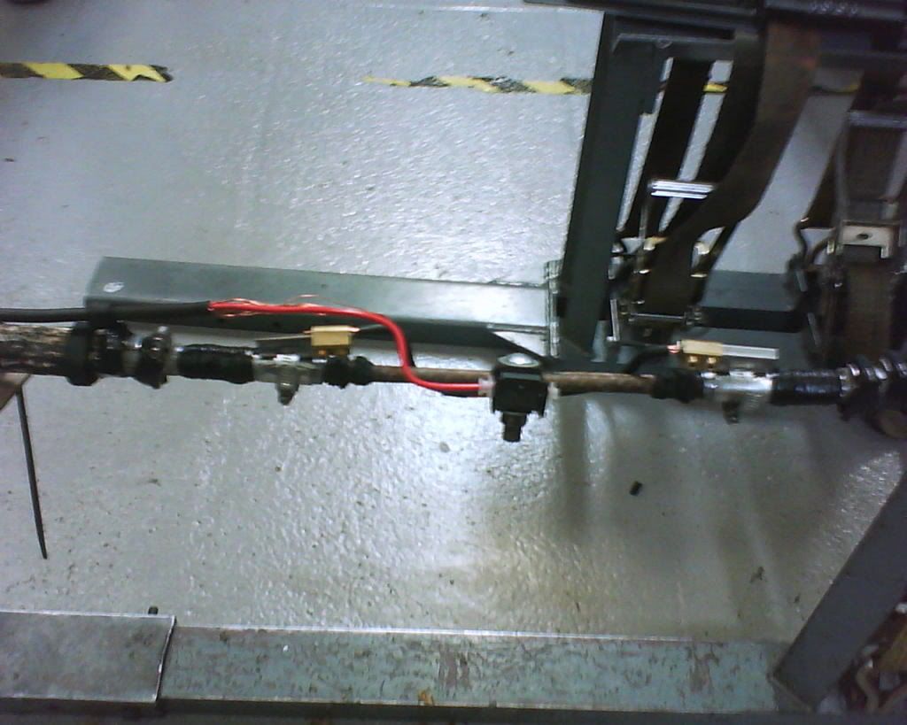

The cut-out was recently replaced and this is the MET the DNO left. Previously it was a soldered earth.
Hardly anyone can do plumbing anymore so there won't be a soldered connection. That ain't right though, that is part of an earthing kit for a PILC service cable to plastic concentric straight joint and there is a bit of metal that goes round the lead sheath, you can just about see it in this pic of mine
They could of just done that it would of been alot safer as they've used the jubilee clip and mesh that's for bonding the armours down!
We have special clips for connecting the earth to the lead at the cutout that don't strangle the cable and don't have the risk of blowing UP! maybe the guy who did it just doesn't care! :rolleyes:

Our DNO uses a spring type coil that wraps securely round the sheath and is then taped over.

Roll springs!? I hate them they are a total PITA to fit! Fairplay to them for using them though they do work fine :D

That jubilee clip is dreadful! Unfortunately most customers wouldn't know what an earth connection was, let alone how it should be engineered.

The cut out was replaced due to the previous one's age and getting a little warm. It supply's a small industrial unit and was changed on a Sunday, not as a emergency but as a urgent job. I have yet to speak to the owner and try (god knows) to get the DNO (E-ON/Central Networks) back to provide a decent earth.
