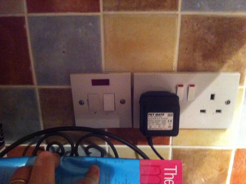

Hi all.
I'm totally new when it comes to electrics so please go easy on me!
Our oven needs replacing and today I had an electrician over to give me a quote, as the oven I was hoping to buy is supposed to be "connected to the mains". The electrician briefly looked at my oven switch and said he thought it was just pulled from the socket and that I'd need to have new wires drawn to the main board (which I'm assuming is expensive, he was a bit vague on the total there) if I was going to get an oven over 3 kW (absolute max). The oven I wanted to get is a zanussi and is 3.5 kW, although I found a nice electrolux at 3 kW... The electrician was generally nice and helpful, but he seemed to pay no heed to the fact that I needed to keep costs down and kept suggesting more (and thus more costly work on the various things I need done) - of course this may have all been sound advice, but I don't want to be taken for a ride as I haven't got the first clue about these things.
What has me confused is that the oven that was already built in (by the previous owners, a 2.8 kW whirlpool) has its own switch with a little box next to it which says "fuse", yet there is no dedicated cooker fuse on the main electric board. Is it not possible then that this is a dedicated circuit (which could handle more than 3 kW - or at least handle that much safely and reliably)? I just don't get why there'd be a designated cooker switch if it didn't isolate the cooker...
I've attached a picture of the cooker switch - any thoughts/help/advice is greatly appreciated!

Thanks for replying! Unfortunately I'm so green I'm not getting much sense from the two paragraphs quoted... what is RCD? And does the second paragraph mean there is a cheaper option than running wires through the ceiling to the main board? Also, is an exactly 3kW oven okay, or would that be pushing it?
I take it you're agreeing with the electrician in saying the "cooker switch" is only fluff?

Do you have a cooker switch above the worktop?
Find out which fuse or mcb in your consumer unit (fuse box) turns of the oven socket and note what other sockets (if any) also stop working.
Can you post a picture of your consumer unit so that we can see all the circuits?
The rules on isolators (Cooker Switches) are not really electrical rules but heath and safety rules. Think about it, should a chip pan go on fire then you want to be able to switch off the cooker somewhere that does not put you in danger and yet local to cooker so it can be done quickly.

3kW is the limit and a cooker which states it's 3kW can be connected to a fuse connection unit (FCU) but a cooker at 3.2kW can't be connected to a FCU. However saying that all fuses get hot and although a 13A fuse run to the limit is a FCU is OK the same fuse in a 13A Plug has problems due to radiating the heat it produces so items which run for a short time like the kettle are OK but items run for an extended time like an immersion heater can't use a 13A plug but can use a 13A FCU.

So to answer question 3kW and under is what to look for avoid any over that limit even if just 3.1kW.
As to RCD these are devices which should if one gets a shock turn off the power. Will not stop you getting a shock but will limit time to 40ms so unlikely to kill you. These devices are now required for new installations with a plug and socket under 20A or except with special cable the cable is buried in the wall.
In real terms using what you already have is no problem but putting in something new has to follow the new rules.
The problem is to fit a mini box (consumer unit) with just one RCD is likely to expand over the years to a whole array of little boxes. And to fit two boxes is likely the same price as to remove the existing box and replace it with a new box covering all circuits. So it is common for electricians to try and get the home owner to change the whole unit as they know in the long run it will save the home owner money and it also makes the whole home safer.
However under the magic 13A or 3kW these units can be built into the FCU so you have a RCD FCU. This is far cheaper than fitting a mini consumer unit. So again keep oven to 3kW or less.
