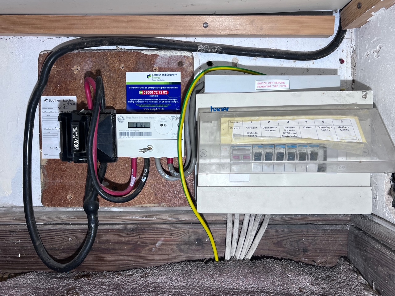

Just moved into a 4 bed house. We will over time need some adaptions for sockets and switches as it's a 1932 property which needs some modernisation throughout.
The consumer unit is in the bedroom which is unusual, but we have overhead power coming into the property.
Had a sparky round today as I wanted to spur off a double socket for another double behind wall mounted tv eventually. He said that the consumer unit would need changing to meet latest regs BUT would be better to rewire the whole house and start again?
What started as a cheap job - has left me this evening pondering £000's of work and mess.
Just wanted the thoughts of others or sparkies who can clarify so I can work out what to do next.

The supply appears to be a TT supply which means the Earth for the installation is derived from a Ground Electrode which is most often a rod driven into the ground; This type of Earth requires an RCD in the CU. In other types of supply the Earth is derived from the incoming Neutral at the main fuse.
The RCD is a device which compares the current in the Live conductor with the current in the Neutral. These are normally the same but if there is any leakage of current they will be different and the RCD will detect this and trip and cut the power off. Very necessary when the leakage is through a person and possibly fatal.
It may be "better" to "rewire the whole house" although better may be better for the sparky getting paid to do it.
You do not "need" the whole house rewiring but a new consumer unit is recommended.
I would recommend you get a thorough EICR to establish the condition of the installation.
Then you’ll know if you are in for £600 or £8 - £10k

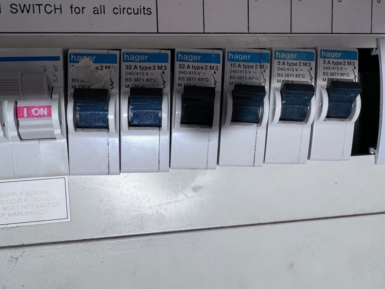

And I can see no sign of any RCD in that consumer unit. That makes the whole thing very dangerous as none of the circuit breakers will trip in the event of an earth fault. That will make all the copper pipes connected to mains voltage. Touch a tap and you're a gonna.
An inspection would condemn the CU as C1 unsatisfactory (unsafe), and I'm surprised the "electrician" didn't make you aware of this in writing..
Rewire needed? maybe not, but the installation needs testing and inspecting and a decision can then be made.

Thank you so much for the detailed reply - We have put any decorating on hold for now until the CU is sorted and a decision made. I will take the advice from @Murdochcat and get a EICR done ASAP so we can move forward but do agree that it would be condemned given no RCD. So a new CU is must.
At least from the guidance I've seen that would "only" be a C2 (potentially dangerous) not a C1 (immediately dangerous) since it would need something to actually fail before someone got a shock.
Still I agree it should be sorted ASAP. If you were a landlord in England you would be legally required to sort it.

The meter tails are red/black which indicates pre 2006. BS 3871 was withdrawn in 1994, replaced with a harmonised EN standard. The white sheath on the cables indicates either pre 2006 or LSF sheath. I strongly suspect the former.

You have had some good answers, my parents house built 1954, it did have a good earth, as an earth line fault ruptured the fuse when I was a lad. But when I came to test, no earth.
I came to add a RCD, and it would not hold in, intermittent fault some where, tests with an insulation tester showed OK, but it would not hold in.
On looking further found no earth on lights (was not required until 1966) and in some areas, crumbling rubber insulated wiring.
So to fit RCD's it needed rewiring first, this was in the end done, but at that time, not required, so could revert back, now the electrician would not be allowed to remove RCD protection once fitted.
I did take a chance with this house and fit an all RCBO consumer unit, and the one fault was soon found, however it is a huge chance to take, and can understand why an electrician would not want to change a CU without rewiring.
