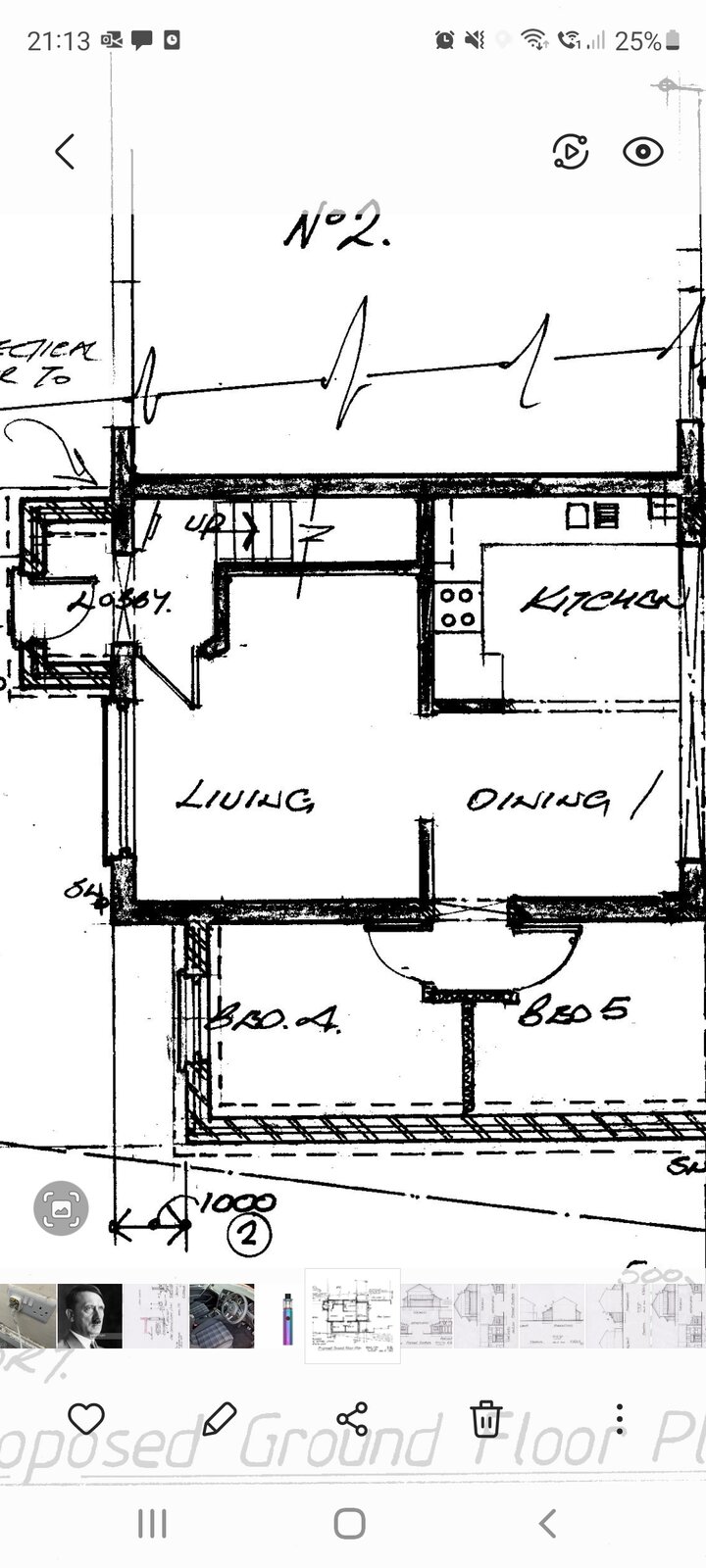

Ive asked my architect... he wasn't sure... builder wasn't sure... rang building regs who never got back to me.. so on to you guys.... i'll attach a photo if i can... but ive had a single storey side extension built... with an opening size of door (no door being put on) and 2 doors going off that to enter bedrooms. Thanks

how many stories high is the house?
is it an HMO?
Contact your local Fire Service and get advice from the experts for free . (Fire Safety Department ).
