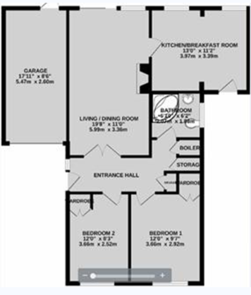

The current brick built attached garage measures L 5220mm W 2700mm H 2540mm. The garage has a flat felt roof.
There is currently a space measuring 2350mm between the garage wall and the boundary between my neighbours property and mine.

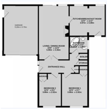

I would like to extend the width of my garage by 1250mm which would leave 1100mm from the new outer wall to the boundary.
The garage will still have a flat roof, and the length will remain the same.
A solid rear door would be moved to the rear of the new wall and the old door way bricked up, there would be no window.
The width of the garage door will increase by 250mm.
The current plan of the garage is…………
The proposed plan of the garage is…………

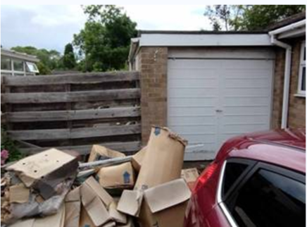

Front view currently (including removal boxes)!
D you think I'll need Planing Permission, Building Regs or just a builder?

Just a builder mate, but why not do it yourself? Doubt if the council will be interested as it is not a habitable building and what you want to do would not change it's use.

It's an extension, nothing to do with the garage being a habitable room or not, have a look on the planning portal guide, it's pretty clear what is and isn't PD. https://www.planningportal.co.uk/permission/common-projects/extensions/planning-permission It seems it would be PD but you've not provided enough information to be able to answer fully, you'll need to consider the height and the following too.
You should check there are no Article 4 oddities in your area or you live in an Article 2(3) designated land area, the definition of these areas are listed on the link above.
Further reading in the technical guidance here:
It is NOT an "extension", it says quite plainly in the website given by our friend above that the rules apply to houses and not other buildings such as in your case a garage. The fact that it is attached to the house is irrelevant, it might be in the same location but not be attached to the house as is the often the case, it is still not an extension or a house.
