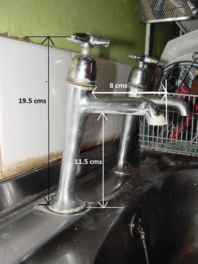

I'm also looking out for taps that are as tall, or taller than, my existing pillar taps, which measure 17cms (not including tap-head) from base to top of pillar.
I would like taps with as long a spout as possible - as long, or longer than, my existing tap's spouts, which measure 8cms.
And to have spouts as high, or higher than, my existing ones, which measure 11.5cms from base to spout.

Well..... hope I've done this right, and you can find the photo of my existing taps (including their measurements). It all looked very uncertain to me.
Let me know if nothing's come through - I'm a bit new to uploading photos!

I was told my existing kitchen pillar crosshead taps are 'Pegler Performa' [if you wish, see uploaded photo of these] and these must be circa-1974.
