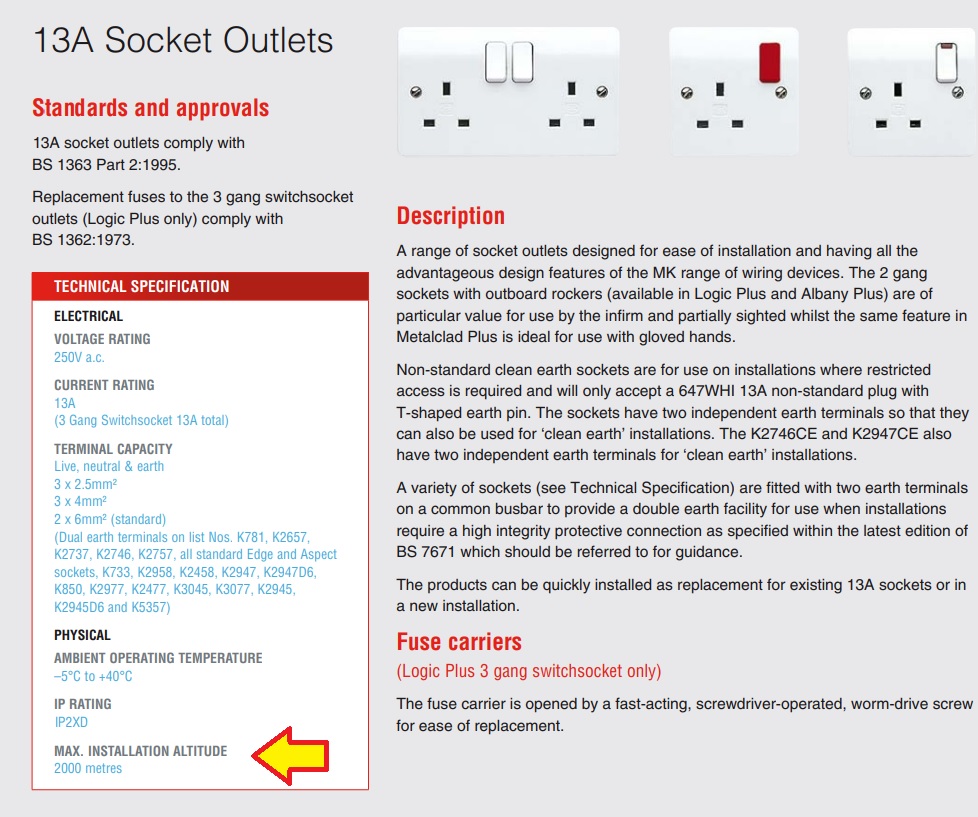

The word altitude appears 76 times in the MK catalogue. Without checking I believe they all reference to 2000 metres. So no altitude related problems in the UK with MK products.
Other manufacturers may set their maximum install altitude at less than 2000 metres. I have seen industrial connectors with a 1000 metre limit

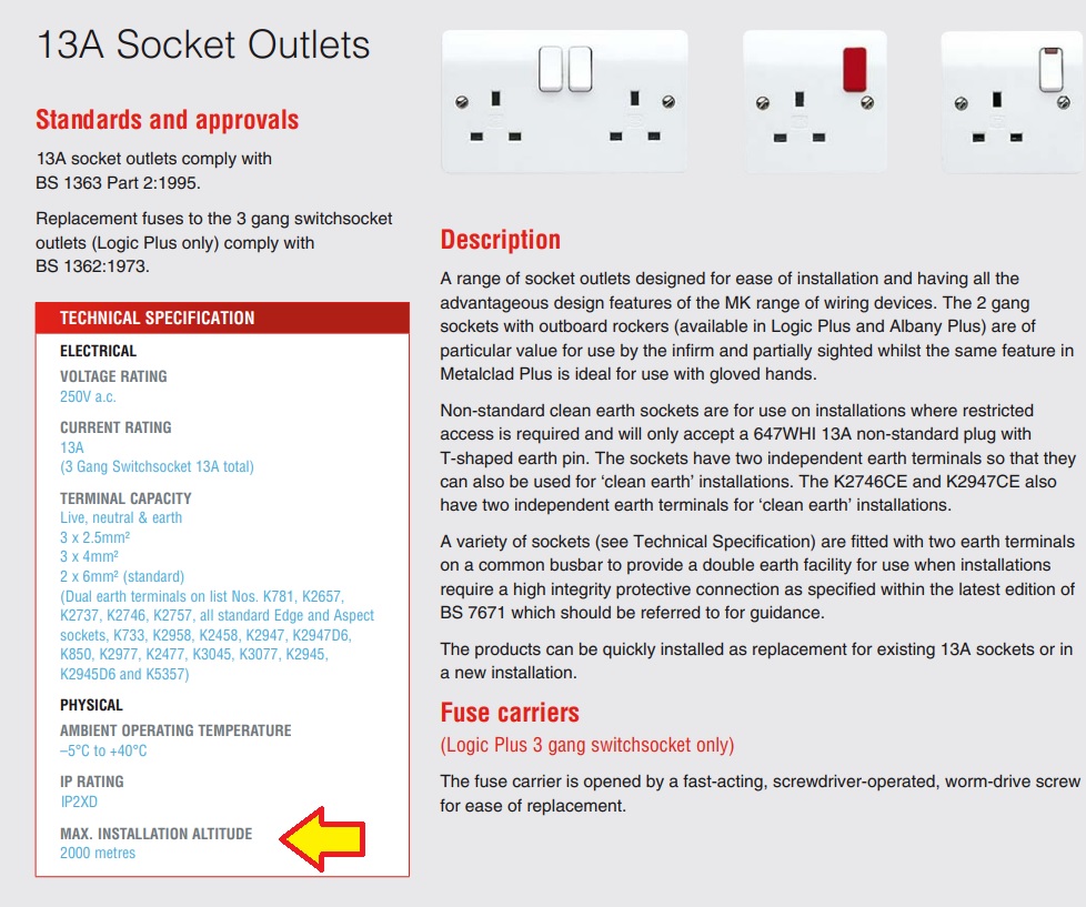

The word altitude appears 76 times in the MK catalogue. Without checking I believe they all reference to 2000 metres. So no altitude related problems in the UK with MK products. View attachment 333667
