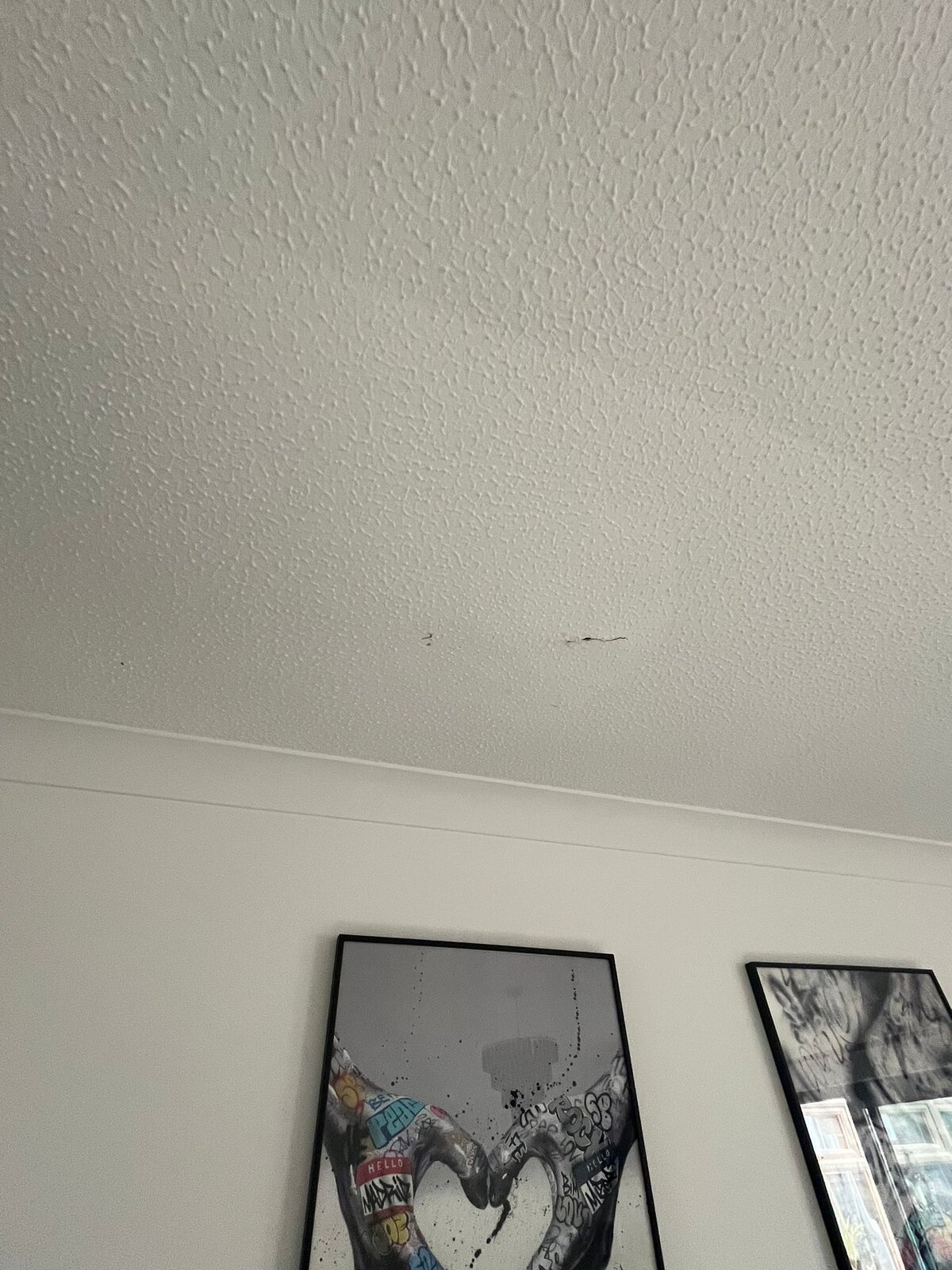

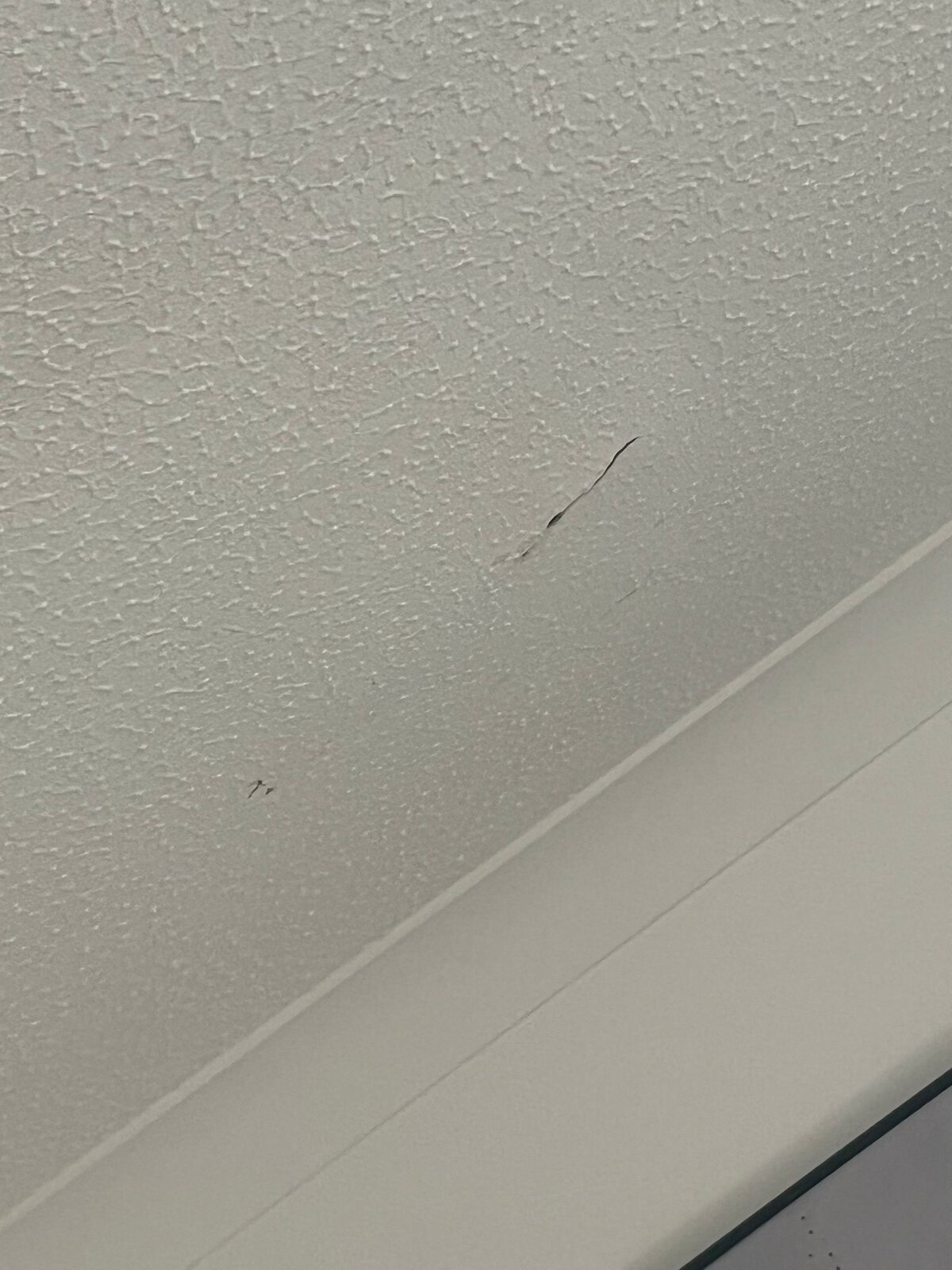

A water leak sprung in a bathroom situated above a living room resulting in a very small amount of damage as per photo. I had it tested for asbestos, and it came back positive and now i am being told by my agent( the property is let) that, according to one of their contractors, the whole ceiling needs replacing which very seems like a case of a sledge hammer bludgeoning a nut. As the property is insured, the cost is not so much the issue, but the inconvenience it will cause my tenant who works from home will be considerable . I thought maybe the ceiling could just be skimmed over or the very most boarded and then skimmed over. Could someone please advise me ? I assume there are health and safety rules pertaining to such situations but i am not aware what those are. Thanks

Bowed board by looks of it which will needs to come down.
Go read the HSE website for advice.
That can't be patched and it's not level so can't be boarded over or just skimmed.
Client needs two days in hotel while it's pulled down and skimmed.
Probably come home while the coving and painting is done.

ok I didn't notice the bow at first, but I can now see it is quite obvious.. GIven the existence of that bow, do you think there is a danger that section might collapse at any moment? I only ask because although our agents have been notified, and we asked for quotes for removal and replacement , so far the contractors have failed to respond. Thanks
I don't know.
I've used 50 to 75mm drywall screws and wedi washers to secure boards that look like that as a temporary fix to secure.
