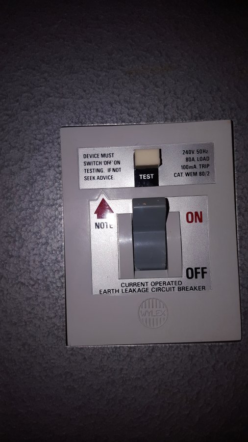

Does anyone recognise this type of consumer unit?

You may find that even if it started with BS3036 (rewireable) fuses that they've been replaced with cartridge fuses at a later date, since the Wylex Standard range can take both (and the plug-in MCB's, like the one already discussed). If not, then they're easy enough to swap out if you wish.
We can't see from the photo, but the main RCD is probably a 100mA type - Not giving the 30mA protection for certain things which is recommended today, but perfectly adequate and not worth changing unless you really want to swap out the board completely.

I got into the house today but unfortunately forgot a screwdriver to open the CU. I did take some better pictures though
I take it these confirm the original idea that it is an old wylex unit with rewirable fuses and an rcd. I notice the rcd is 100mA though and that as someone mentioned previously a 45A breaker has been added which may be a bit much for the unit. I think I'm going to just get a new CU fitted.

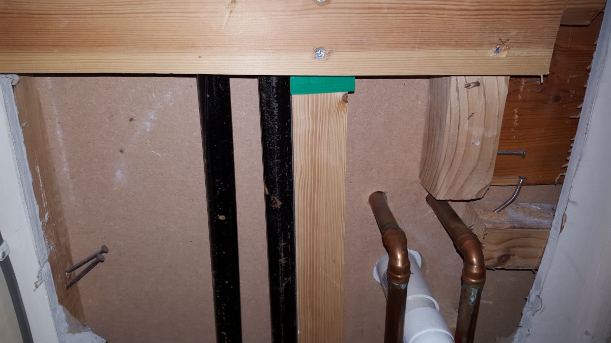

Also I took a picture below the unit to try and get an idea of the wiring but it's not very clear 20160323_093427.jpg
As PBC guessed. There is an RCD, but it is rated at 100mA which means it would not be compliant with todays regs, if you were to have new work/circuits done.
I am not sure what the 45amp breaker is for? If it is to power and electric shower then a 30mA RCD is required.
I agree, now's the time to opt for a new CU with your new house would be a good plan for today and the future.
Is it ex-LA?
They are often wired with conduit.
Those black pipes could be conduit.
Are there any that go up?

Yeah it's ex local authority, I was thinking the black pipes might be conduit aswell, unfortunately everything must be behind the plaster board so I can't see what's going up.
I think I'm probably too far down the line with the offer now to amend it I'm thinking of getting the electrical system surveyed /tested. My big worry all along is changing from an old conduited system to a 17th edition board with split rcd's. Iv never actually done it so I'm not sure if it's a valid concern but it seems to me like the kind of thing that could be a potential problem
I live in a flat with conduit, and it has the advantage that it has been harder for previous owners to bodge things - and where they have bodged things, it's obvious that it's new because it's not in conduit.
My big worry was putting on q 17th edition board and the rcd constantly tripping due to existing, undetected earth faults.
