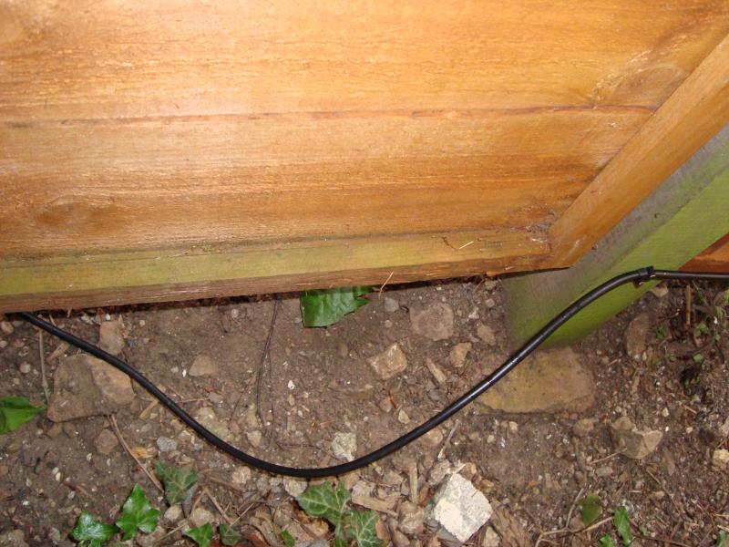

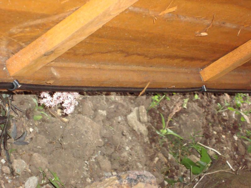

The left hand photo shows where the cable crossed from their side, then runs all along bottom of fence.
The right photo shows the end of fence along the side of our house. You can just make out the security light on top of the furthest post.

If people can walk along that path between the fence and the wall then that cable is not safely installed.
Whether the person can install it there ( even though un-safe ) depends on who owns the fence and the land it is on. The fence may be a few inches on their side of the dividing line between your property and their property in which case they can fit the cable where they have done as technically it is on their side of the boundary. Even going onto you property to maintain the fence may be allowed in the deeds.

The cable is technically on our side, but it's more the installation I'm worried about, ie. live cables lying on the ground.
