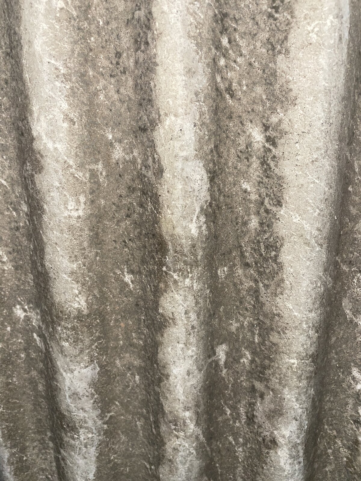

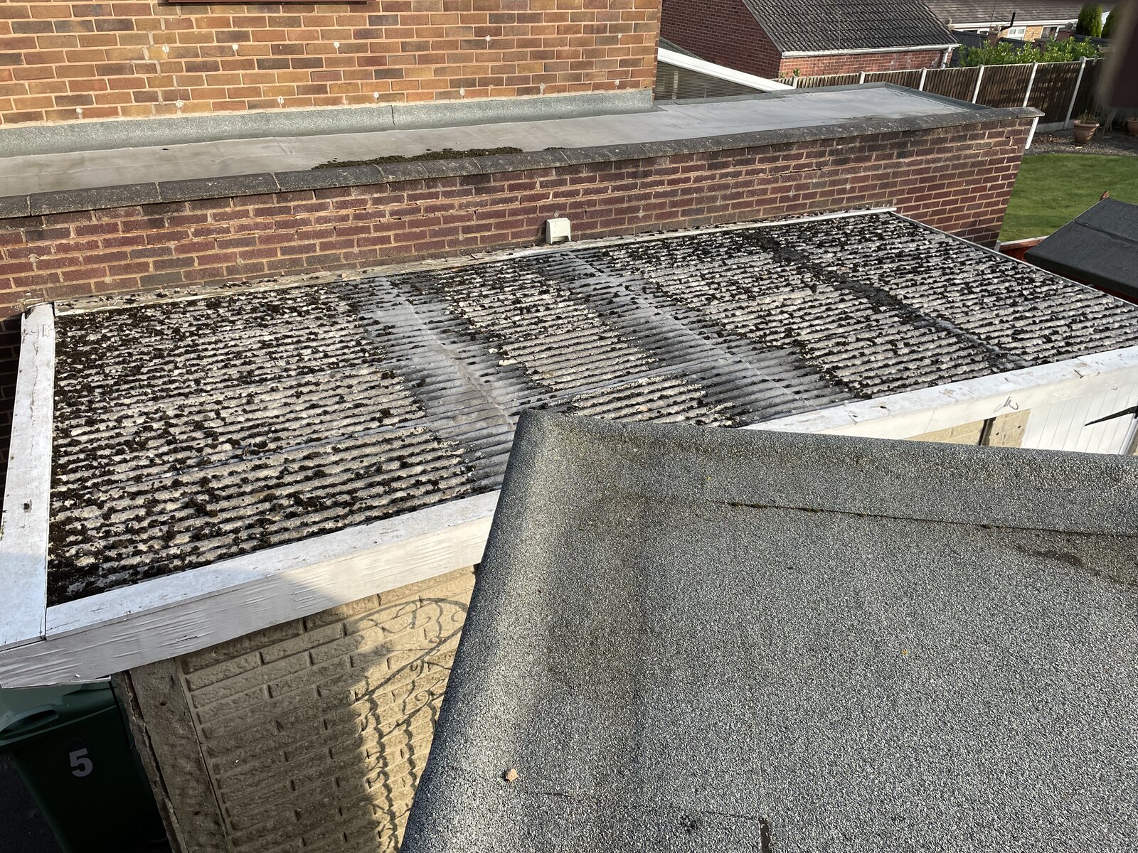

Does this look like an asbestos garage roof to you?
12 Dec 2014
120
5
Birmingham
Obviously I’m going to get a test or survey before messing with it, but I’m just wondering because our mortgage valuation said ‘suspected asbestos’ but a couple of different family members who work in the building trade said it doesn’t look like asbestos to them.

I don't think I would trust your family members! ;)
There's not really a discernible difference between non-asbestos and asbestos, cement sheets.
Sometimes there may be markings on the sheets; and there may be dimples in asbestos sheets, due to the manufacturing process.
Otherwise, there may be no way of telling just by sight (...and without knowing the age of the sheets).
As above, get it tested to be sure.
