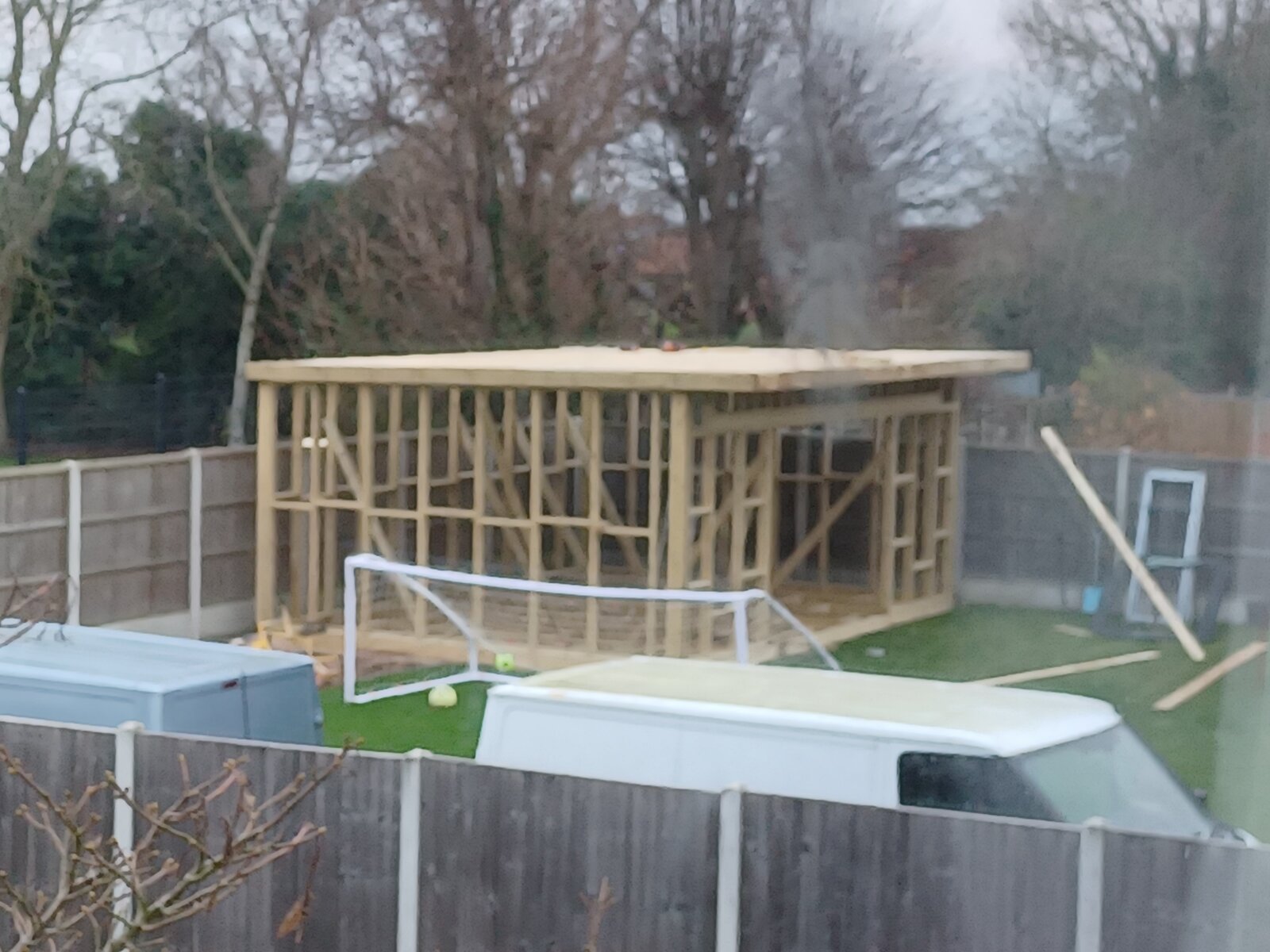

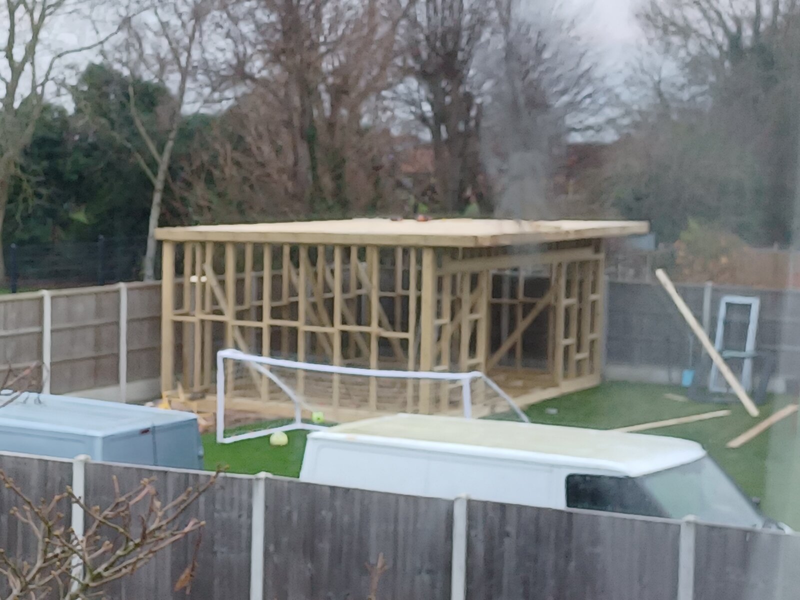

Does this look like its permitted?
11 Jan 2021
8
Looks ok for for permitted development, although not everyone has permitted development rights. It may need building regs as it looks like it's combustible material so limited to 15m2 that close to a boundary.
