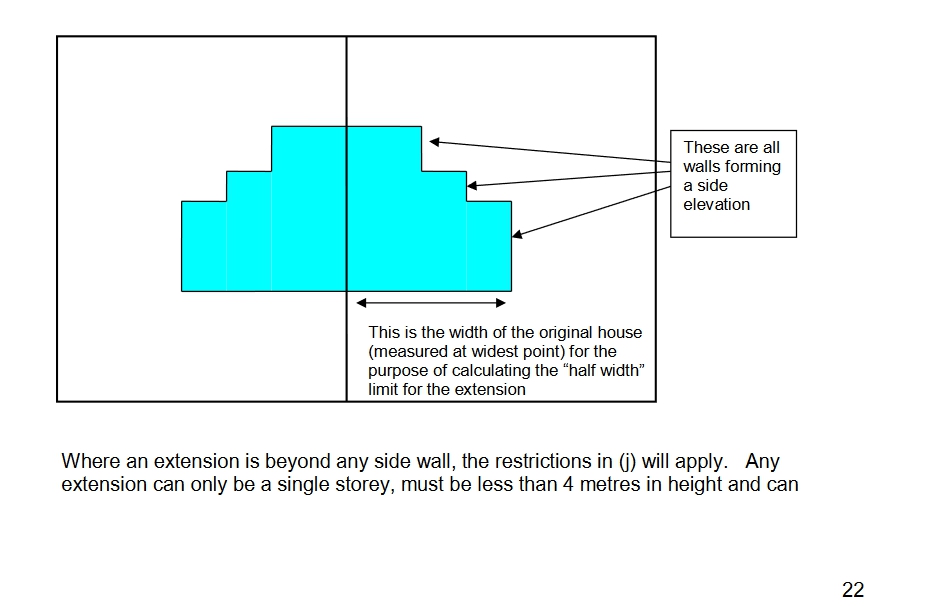

Quick question on how to interpret this diagram above, from the technical guidance document:
- Is this one house, with the dividing line down the centre just signifying the "centre" of the house?
or
- Are these two distinct houses, with the dividing line down the centre signifying a boundary/party wall between two neighbouring houses?
It’s not very clear but it does say somewhere that it’s a pair of semis and the dividing line is the middle of the 2 properties.

Your planning officer is wrong. Assuming the garage is original, and extends beyond the rear wall of the bungalow, you would be extending beyond an original side wall. As the total width of the extension would then be more than one-half the width of the house, it would not be P.D, as FMT explained.
