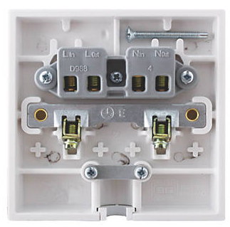

Also, can anyone recommend a white fuse outlet that has the relevant IP rating? Most of the outlets I can see simply have holes in them for the flex and don't appear to have any grommets or anything that would make them water tight.
Accessories (switches) are not given IP ratings, buy one with the flex outlet at the bottom edge (not a hole in the middle) - looks much better anyway.
https://www.screwfix.com/p/british-general-900-series-20a-unswitched-flex-outlet-plate-white/21114

Thinking about it, the element flex probably should be terminated in the flex outlet, rather than running through to the timer (although I suspect the flex would be too short for this anyway) because it then makes it easier to replace the element in the future.
Sorry, I'm not sure what you mean by "..but its fuse might be required".
FCU stands for Fused Connection Unit without a switch.
SFCU for one with switch.
You might need the fuse part of it to protect the flex even if you don't have a switch.
If you want a switch but it would be in zone 2 (not allowed) then you could use a flex outlet plate in the bathroom just for neatness to cover the hole for the cable.
Then don't use the connections in it but simply run the flex through the wall to a SFCU on the other side.
