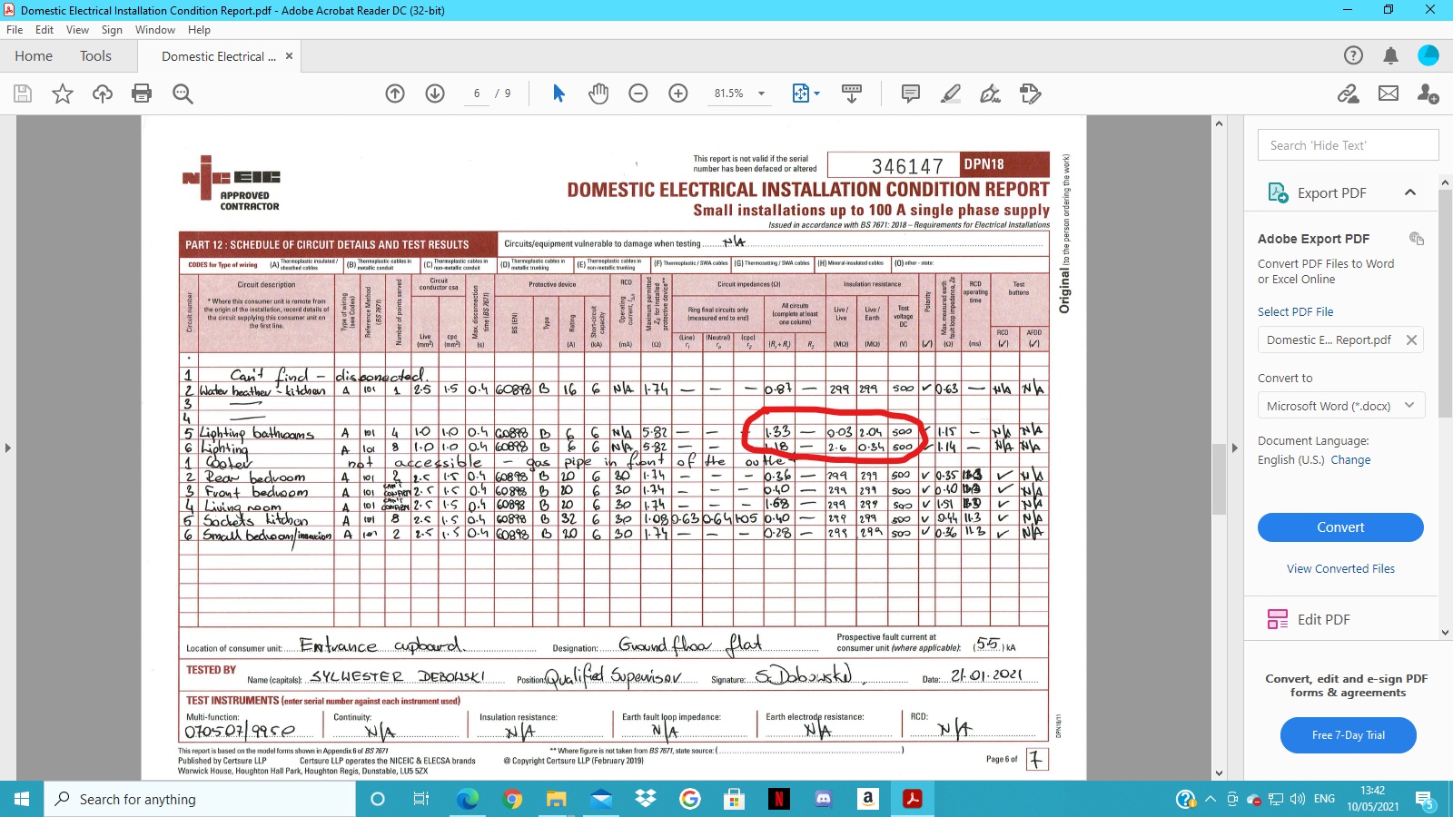

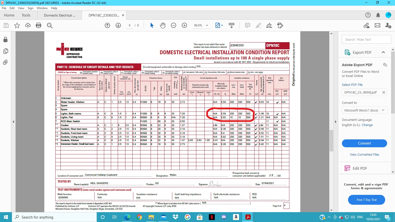

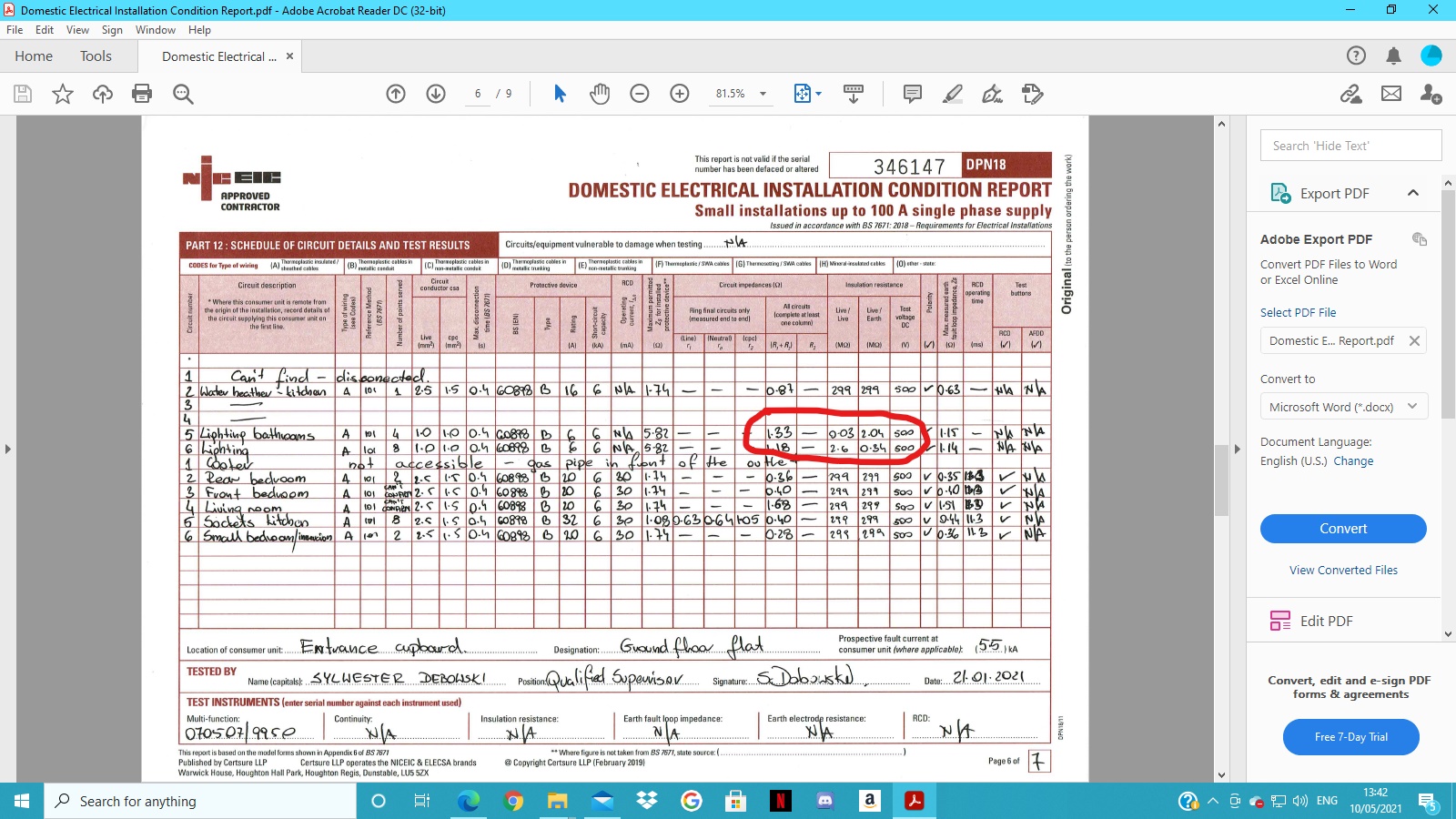

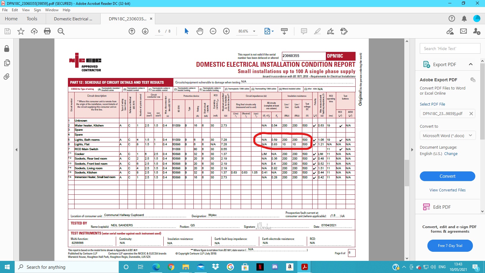

I have no knowledge about electrics and I really need someone's help. My landlord is unfortunately one of those not really good ones. To the point that I had to take him to court as the condition of our property is beyond description. Electrics has been flooded on multiple occasions due to all sorts of leakages. Not long ago I asked my electrician to perform an installation check as that has never been done while I've been a tenant (over 8 years now). I can't say I have been surprised that the result was unsatisfactory. Some time later landlord sent his own electrician to put RCD on lights (that wasn't there), earth the gas etc. He then gave his own certificate stating that everything is ok and of course the result is satisfactory. My electrician came back just to double check the results and he discovered that the readings from landlord electrician on problematic circuits were completely different, than on his certificate (almost 10 times different). Insulation resistance readings by my electrician on live/live and live/earth were 2.6 and 0.34 and on landlord's electrician certificate were both 10. After double checking by my electrician his reading were showing again much lower resistance: 1.6 and 0.63. This readings differences are huge. What can I do with it as I'm scared about the condition of electrics in my house and I know my landlord will go to hell and back to get away with a murder.

John, again thank you for your answer. I don't mind paying for new EICR as my family's safety is priceless. My electrician already did one and some time after that, my landlord's electrician came and did whatever he did. As they both NICEIC certified, my electrician told me that, he can't get involved too much as the governing body is refusing to help (he spoke to his inspector about that matter) as it would mean that they going to have a case against themselves for allowing this kind of people to be certified by them. Makes and at the same time doesn't make sense in a way...
I will obtain another independent EICR and if it will confirm my electrician's findings I will email my council and force them to act on it.
Did the respective electricians carry out the IR test at different voltages and would this account, at least in part, for the disparity between the readings?
Blup
Blup
Both did at the same one: 500 volt

However I have test meters give wrong readings, and also seen testers use odd methods, what I or non any one else on the forum does not know is which report is wrong.
It is very easy to jump to conclusions which are wrong, I have done this far too many times.
500Ω was at one time a pass, and with any SPD or scokets with other electronic bits, tests should be at 250 volt.
The testing of SPD using a wind up insulation tester was interesting, A very small diffrence in the test voltage can cause a huge diffrence in reading.
There is no requirement to treat the home as a new installation, BS 7671 is not retrospective, so unless there has been a change then if it was OK when installed it is still OK now.
