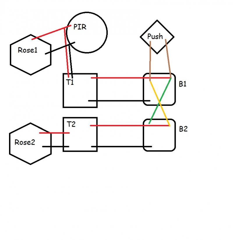

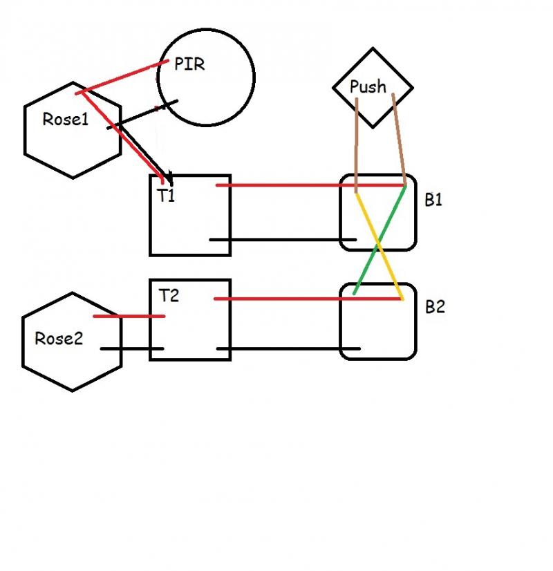

Finally got a chance to check these,
Drawn up the before and after for the setup
T1 is transformer 1 feeding bell 1.
T2 is transformer 2 feeding bell 2.
The bells have the following connections:
top left is "OF"
top right is "1"
bottom left is "T3"
The solenoid is connected between OF and T3
Both bells are the same but the transformers are different to each other.
Looking at the setup, top right (1) is used to provide 6V, and bottom left (T3) is used as 0v.
Bell button is connected between OF and 1.
There is a pair of wires going between - Green and Yellow but they seem to be crossed... where On bell 1, green is from "1", but connecting to "OF" on bell 2 and yellow is the reverse.
The before:
The after:
Only things I changed as mentioned is where T1 was getting its power from.
Now something sprung to mind as I drew this up, either I have now connected t1 up reversed (as in live and neutral have been swapped - though I checked when I connected it up), or they were swapped before and are now correct, with the crossing green and yellow now causing the 0v from t2 and the 6v from t1 to make Bell 1 stay open?
Going to disconnect B2 all together when I get a chance and see if b1 then works normally, as well as check for reversed polarity…

Solved.... Wife wouldnt let me sit till i checked re crossed wires... Turns out that the wires ive moved are correct, onlt thing was the green/yellow wires which go between the two bells. Swapped them over on one bell and all now works. I can only assume somewhere inthe past the first transformer got its feed reversed. By moving the wires ive corrected it and then had to adress the cross over between the bells
The two transformers, the two bells and the push are connected as below
( primaries of transformers omittted for clarity )
The two transformers are in anti-phase and thus if they are the same voltage they cancel each other out and there is no voltage to drive the bells. Losing the mains to one transformer means the other transformer's output is shared between the two bells and one or both will ring without the button being pressed.
Press the bell push and each transformer is connected to a bell.

I think that was exactly what was happening... and i can only assume that it got that way because the primary on transformer 1 was switched in the past, and now been corrected ( i checked polarity with a multimeter) red to live and black to neutral showed as +240, black to live and red to neutral showed -240.
