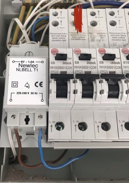

hi, looking for some advice please, i have found that my door bell is wired to the downstairs lighting ring and it causes the rcb to hum/buzz and when i disconnect the live wire for the door bell transformer it stops. So can i just install a new door bell transformer to fix the problem?

sorry i meant rcbo, the bell transformer is wired to the downstairs lighting ring rcbo in the consumer unit and makes a humming type sounds hen connected! when i disconnect the live going from the bell transformer to the rcbo the noise stops, so i was thinking maybe the bell transformer is defective?
It'll be a wire wound transformer which always hum a little bit. If it's got louder then it may be defective & best to replace it.

A new transformer will most likely hum as well. Any bell transformer will not do, it needs to be the same voltage output. Rather than wasting money on a new one I would try mounting the existing one on rubber mountings. Maybe a grommet on each mounting screw so that the transformer is not toughing the wall or whatever it is mounted on.
It's the RCBO making the Hum from my understanding caused by the Transformer being connected though.
so this is what i have, and with the bell transformer wired into the rcbo (with the red marking) it makes the hummming noise which you can hear more at night when everthing is quite, and in the day you have to have your head near the consumer unit, if i disconnect it stops, i hope this help a bit more?

Transformers do that.
If it’s quite hot replace it.
If you think its the Rcbo you could move the wires to another rcbo marked 6
To prove it isn’t

i’m pretty confident it’s not the rcbo, because without the bell transformer connected there is no hum! do you mean the bell transformer being hot? as to the touch it’s not hot at all! just makes the noise but i wouldn’t say it’s really loud i just noticed it the other night when everyone was asleep.
but surely if it was the rcbo it would still make the same noise without the bell transformer connected?
