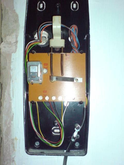

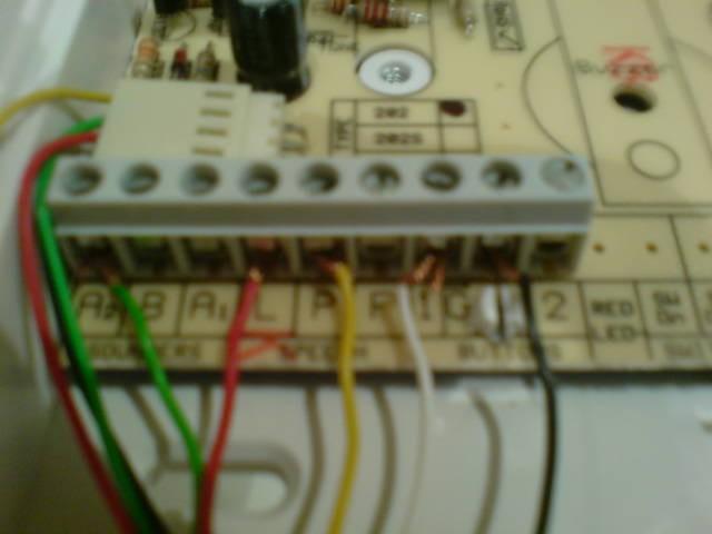

I have just bought a new single button door entry phone for my flat to replace the old one. I bought it from www.entryphone.co.uk and it is a model 201.
I have wired in the new phone but when someone presses the button outside it does not ring inside, it only rings when you pick up the reciever.
This is driving me mad so i would really appreciate some help.
This is a picture of the phone that i have removed (no make or model on it though)
This is a picture of how it was wired up
This is a picture of how the new phone is wired up

Not sure why you haven't just carried on from the last thread. Weren't we waiting for some better pictures?
Please write down the connections and post details, beacuse those pictures make it impossible to see what is what !

you should folow instructions for BELL (BSTL) as that's the make of your old handset. hope this helps
from the instructions, and the somewhat still unclear picture of the terminations.. ( need top down so we can see the letters ), it looks as though the terminations go, from left to right...
A2 / B / A1 / L / P / R / 1 / G / 2.
is this correct?
if so then i think you need a wire connecting B and G together ( and F, but you don't seem to have one of those.. )
this would be the ground for the buzzer that it is missing.. it sounds like it currently feeds back through the "on hook" switch when it's made..
