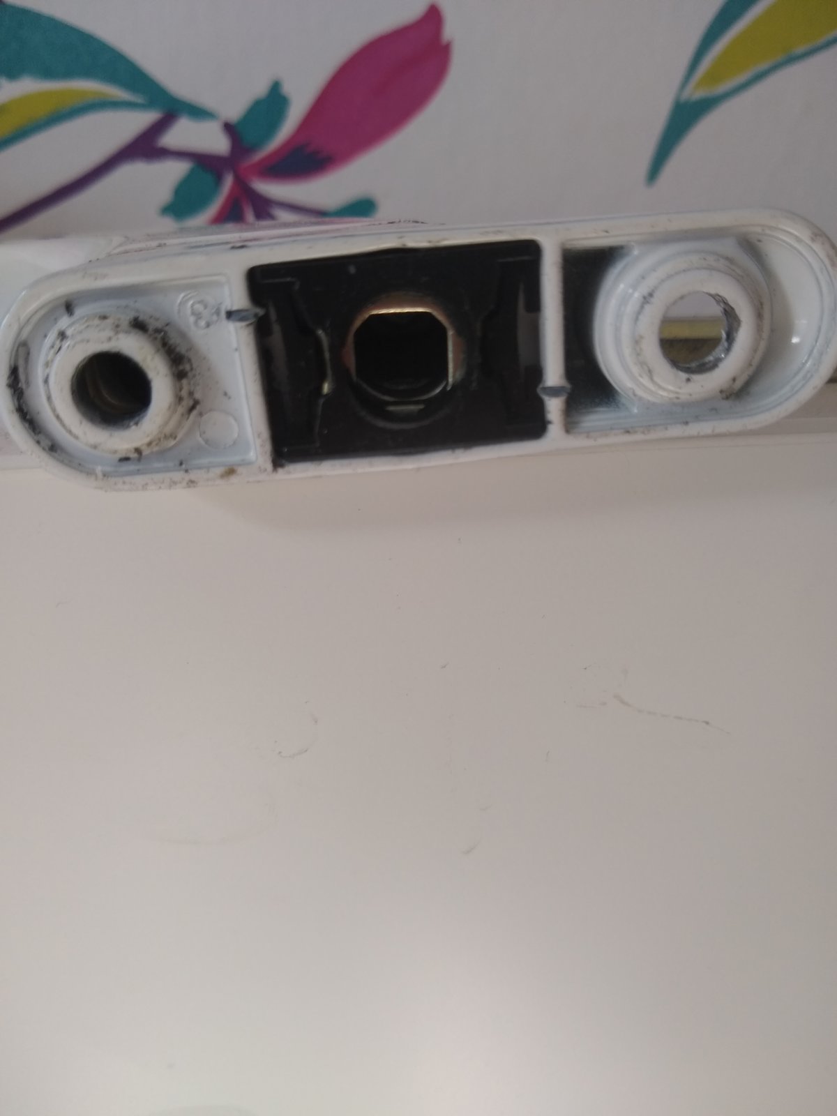

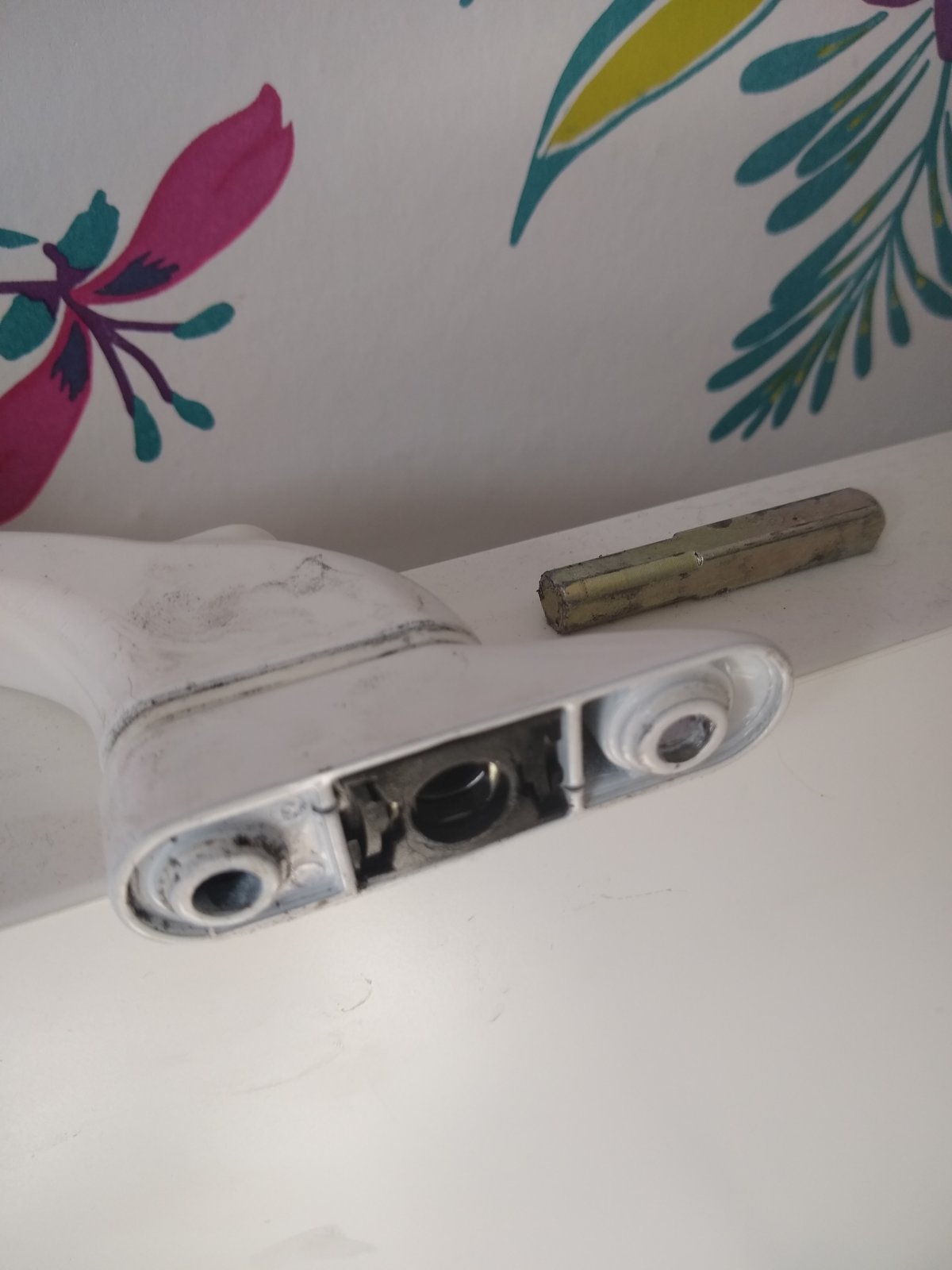

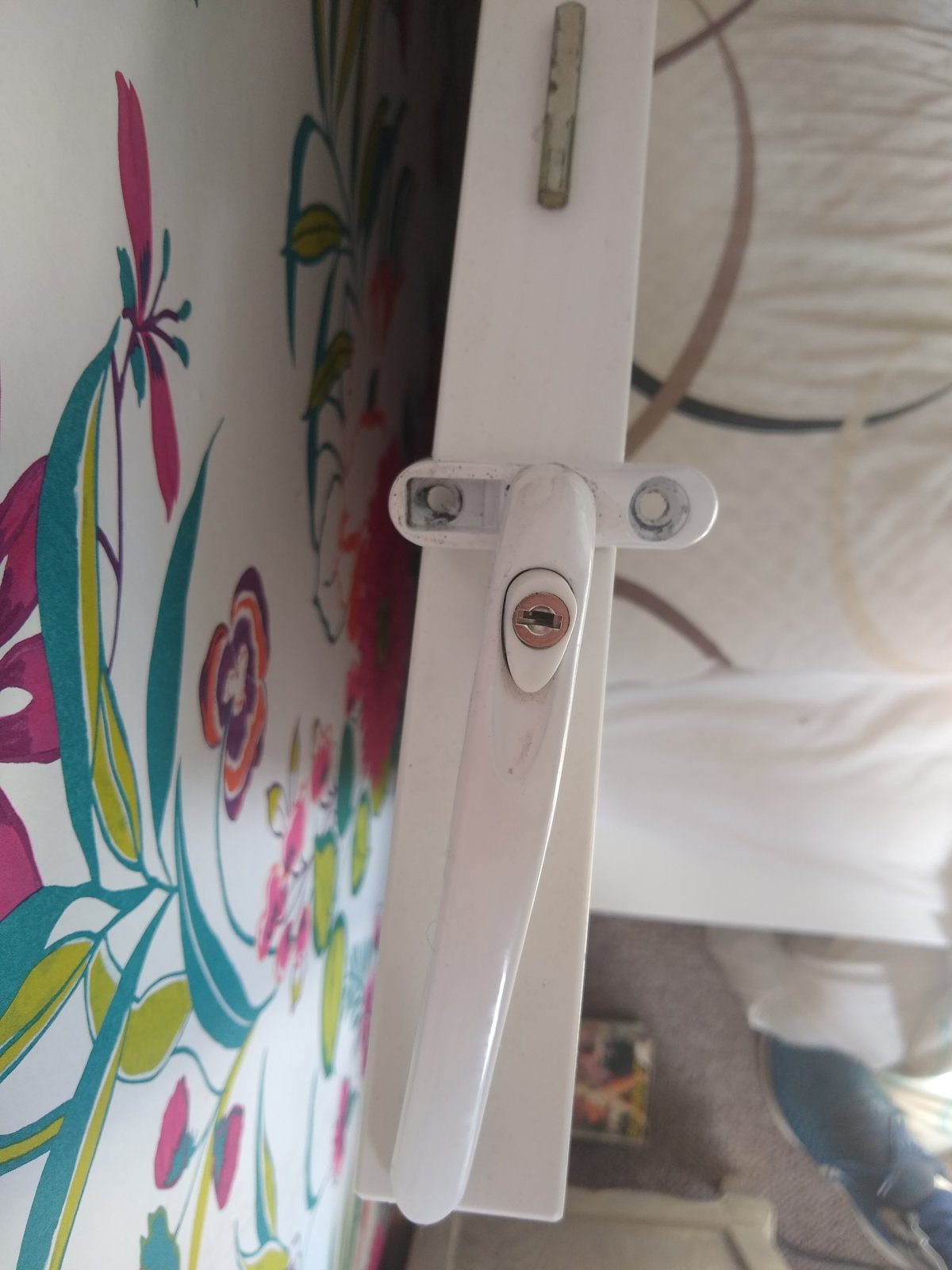

You might struggle with that option now I’ve seen the window. Your only option might be to make a sort of cockspur hold on the frame. Basically it’s using the handle only and a separate locking point. Send me a photo of the handle and locking point or is that it with the key in .
Thanks for your help mate I appreciate it!
Here are some pics for you

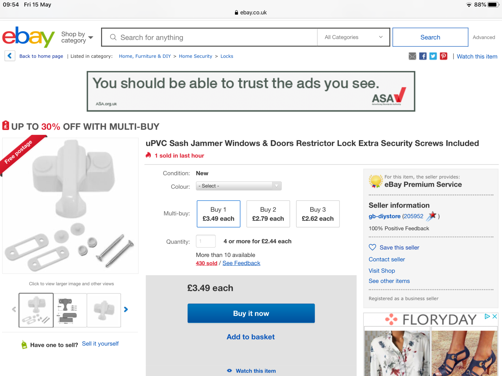

Hi Mark, you could put the handle back on minus the spindle and fit a sash jam. Quick, simple to fit and cheap. Saves a whole lot of money and messing around.
